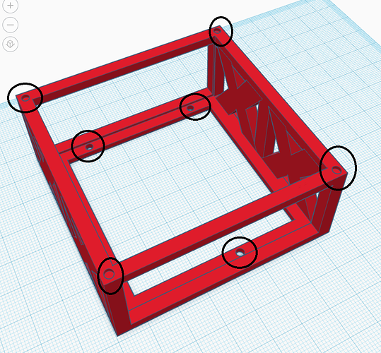

It was supposed the be a mounting plate for the neoboxes instead of them bashing around.
The plan was to mount them to the print like this:
Where it then gets mounted to the existing Enclosure/Lid i have:
in between comes the mesh to keep rougher dirt away + my Wind catcher.
Plan A was to use the already existing holes but i might drill new ones that use the pillars instead of the weakpoints that broke off.
Plan B is a plate that attaches to the bottom of the enclosure and the neoboxes will be held in place by velcro for easy removal if i need to unplug a connector or so.

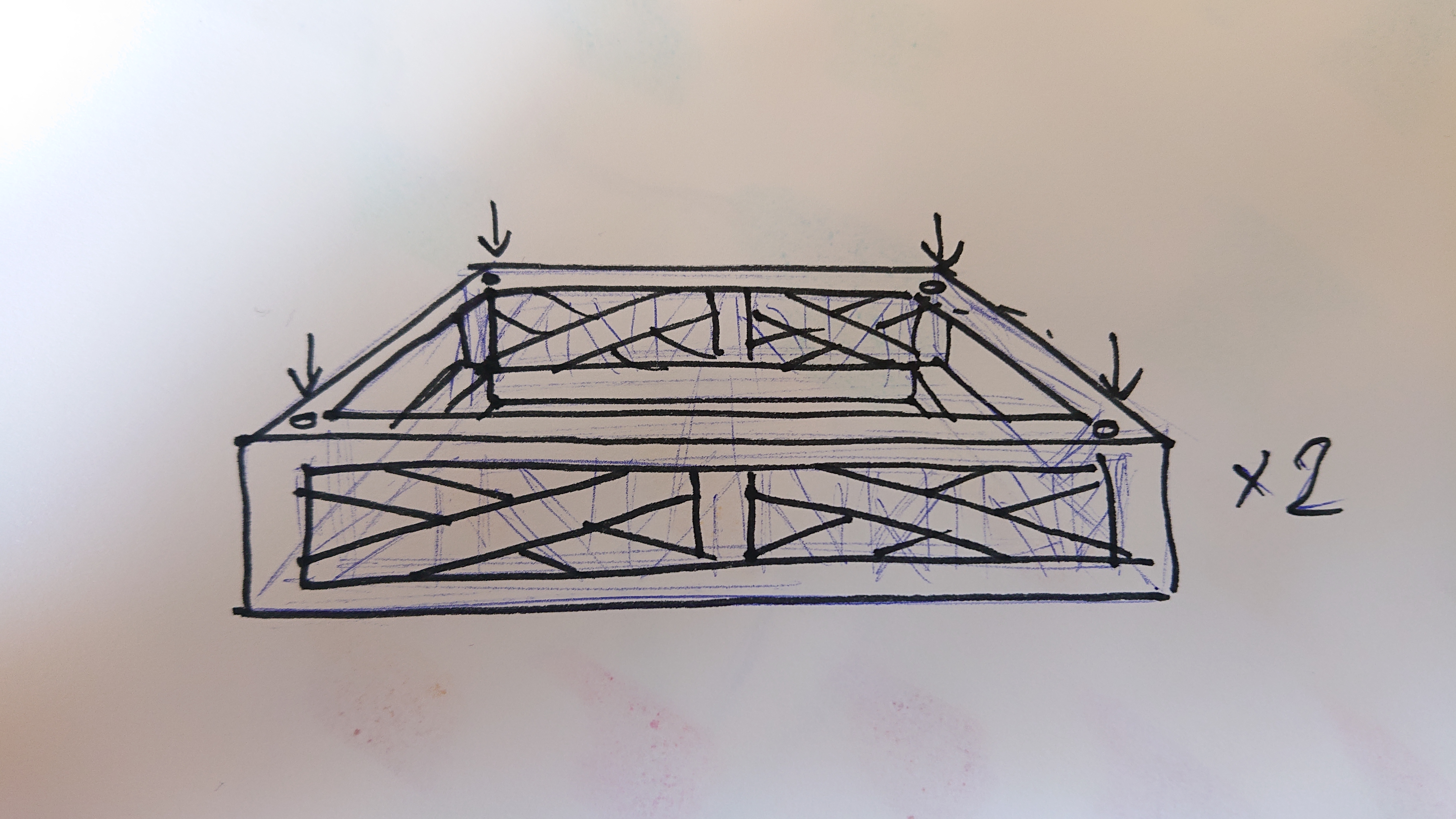

Ok then I recommand you simplify the design a bit : split in two halves boltables or snappable together
Make a full frame (bottom and top lid are similar structure), T pillar with triangular supports on 2 faces and keep two other faces open (to slide the NeoBoxes inside before bolting)
Having two halves that you lay flat on your printing bed with give a regular print and stronger result overall once mounted I think!
Edit : you can even make a full “cage” kind of structure so the esc cannot move unless you dismount the cage
I’m sorry i have absolutely no idea how i can visualize that in my mind :sob: :sweat_smile:
One moment
@xsynatic here
Sorry for the shit quality lol but basically you print two and bolt together, lay each flat on bed printer
Easy in fusion. one body and component :laughing:
Do you meant stacking them?
Yes, instead of making a single box I was suggesting to split in two halves from middle and stack them to make a complete box :slight_smile:
So you mean like this?
grafik
grafik
black cirles are screwholes for the neobox and screwholes for the lid.
