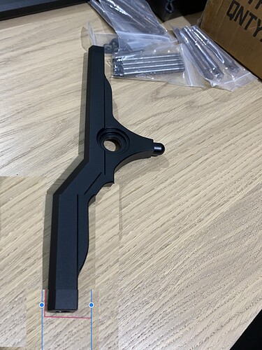

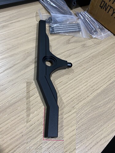

@Boardnamics can we have wheel base//height altering variants of your hangers please?
Money talks :grimacing:
how many sets speaks your language?
Maybe a handful. Price for 2 is almost the same as 8
i already downloaded the best cad i could find on chromebook, ill make the file and see who want. lmao.
your hangers are dope. if they gave you an extra half inch clearance and wheelbase in each direction i think itd be the dopest. plus i just wanna try it out and think itd look cool.
