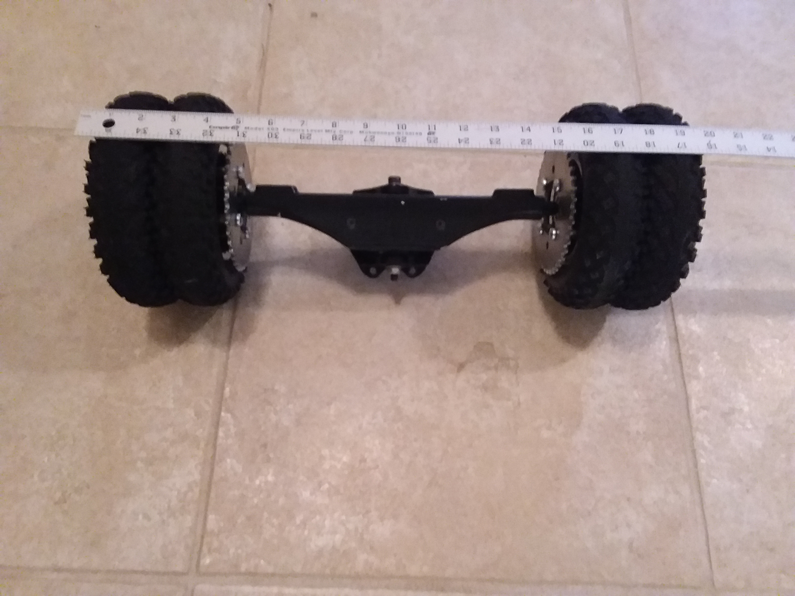

Double wide dualies for extra torque transfer, longer wheelies, and better burnouts. They are extremely solid and should seriously help with my upcoming dual 80100 motors.
Wow those are ThICC motors

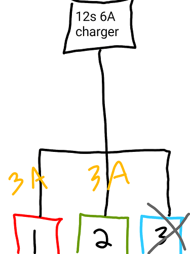

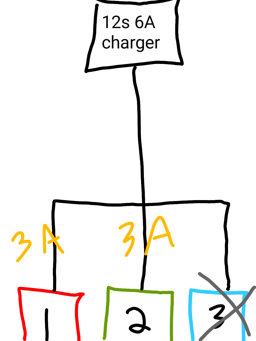

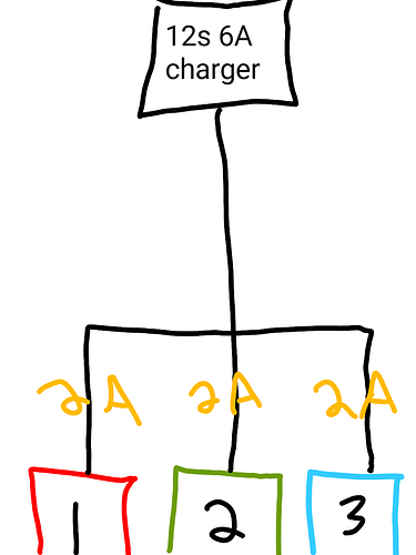

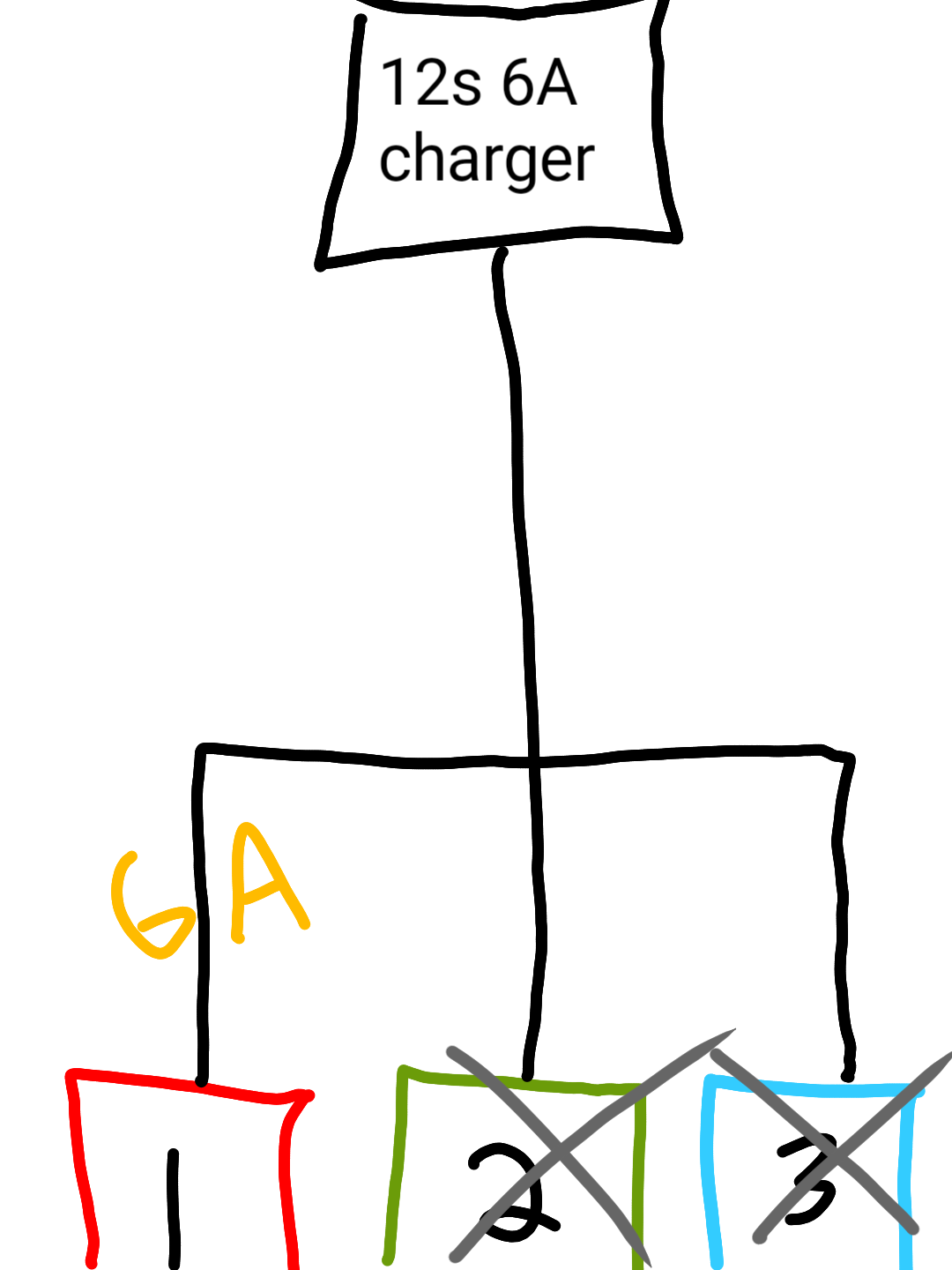

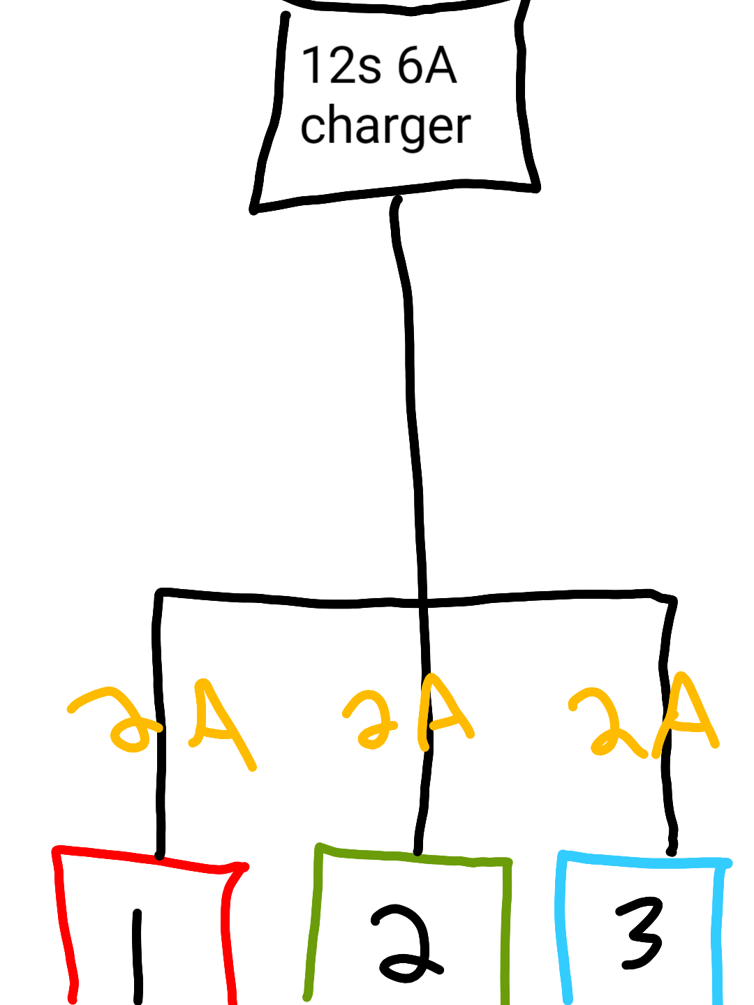

This idea started with the concept of a headphone splitter.
What if I added a charge port splitter to a higher amp charger?
Obviously this is a huge no-no because one pack would be full and the other would cut off or worse: one being charged over capacity while the other catches up. What if there was a smart “nozzle” between the boards’ charge heads and the parallel split? If it worked out correctly, say using a 6A charger for example:
You could rapidly charge one board, or slowly charge several. I just don’t know what magical black box needs to be implemented to make this happen. Chop chop you electronics wizards smarter than me!
@Venom121212 Wouldnt you simply need that charger along with 3 DC regulators? I already do this on a DIY portable TV. I plug the cable, and one regulator charges the batteries while the second one regulates the current for the TV to be on at the same time without flickering
