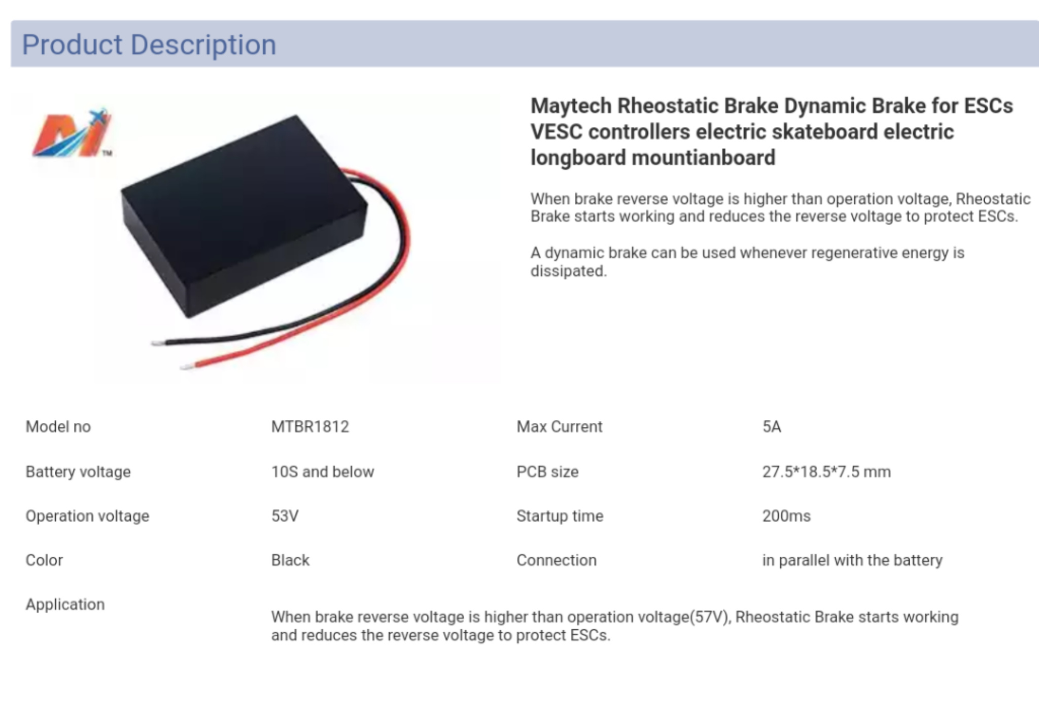

What you’re describing is essentially the function of a rheostat/dynamic brake. You probably don’t want to be handing out “don’t buy” recommendations when you don’t have experience with the device in hand though.
Their function is to prevent exactly what happened to OP.
Rather than try to build in two separate discharge/balance systems, a BMS with a higher bleed discharge spec would likely suffice.
Really we just need to set our expectations of what to expect from a $30-50 simple BMS. And as others said, not all BMS handle over voltage this way
“if used correctly” is the catch. If the seller can’t even describe in detail what the specs are than how are you supposed to be able to design a system that uses it?
So hence the “I wouldn’t buy this” recommendation. You could make one yourself, anyway. It’s not a complicated thing. At least then you’d know what the specs are.
Which specs do you desire?
Well no such device could work on an unspecified battery voltage, for starters.
A 9S battery would need a much different cutoff voltage than a 10S battery. And neither one would need a 57V or 53V cutoff.
There’s so much ambiguity I would never use that.
Make one your self from a zener diode, a power resistor, and a piece of aluminum.

I have one of these but haven’t used it since I was informed it is not capable of 12S.

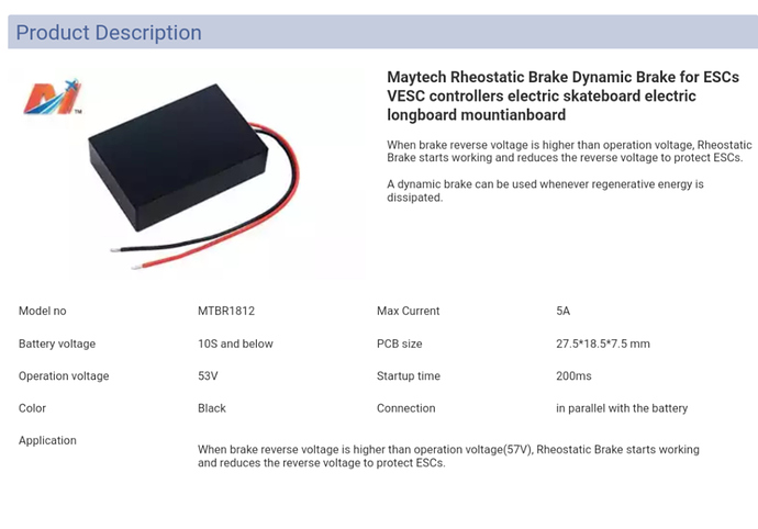

The BMS units I use (SuPower) have no issues braking at full power on 10s, but braking on my 12S board, I have gotten the no brakes run off before. However, I believe that this is not due to the BMS, rather the VESC. The VESC high voltage cutoff is 57V if you look in the tool. I think the idea behind this RBrake was based around the VESC voltage. So you get diminishing results the lower the voltage.
I could be wrong but I thought they were simply trying to prevent the VESC from hitting 57V, which in my case causes my FOCBOX’s to restart, losing all braking power. On 12S since the starting voltage at full charge is 50.4, it is much closer to that risky number. Observing ESC monitor from my bluetooth module, I can confirm that on braking it will exceed 57 when at totally full charge.
I spoke to Agnes from Maytech recently and she said that they now have the rheostatic brake for 12s…
