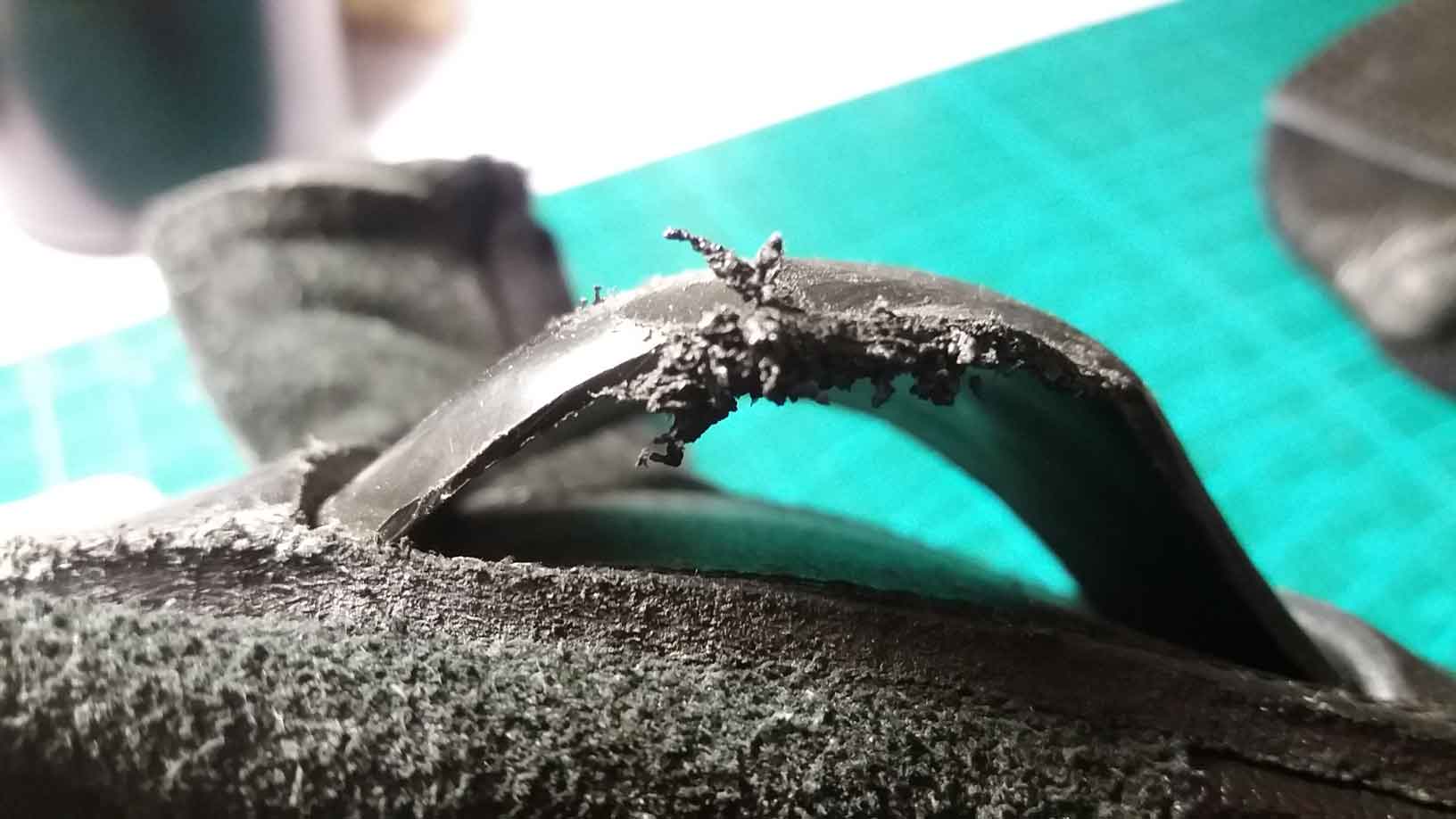

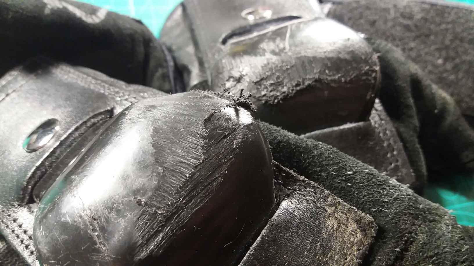

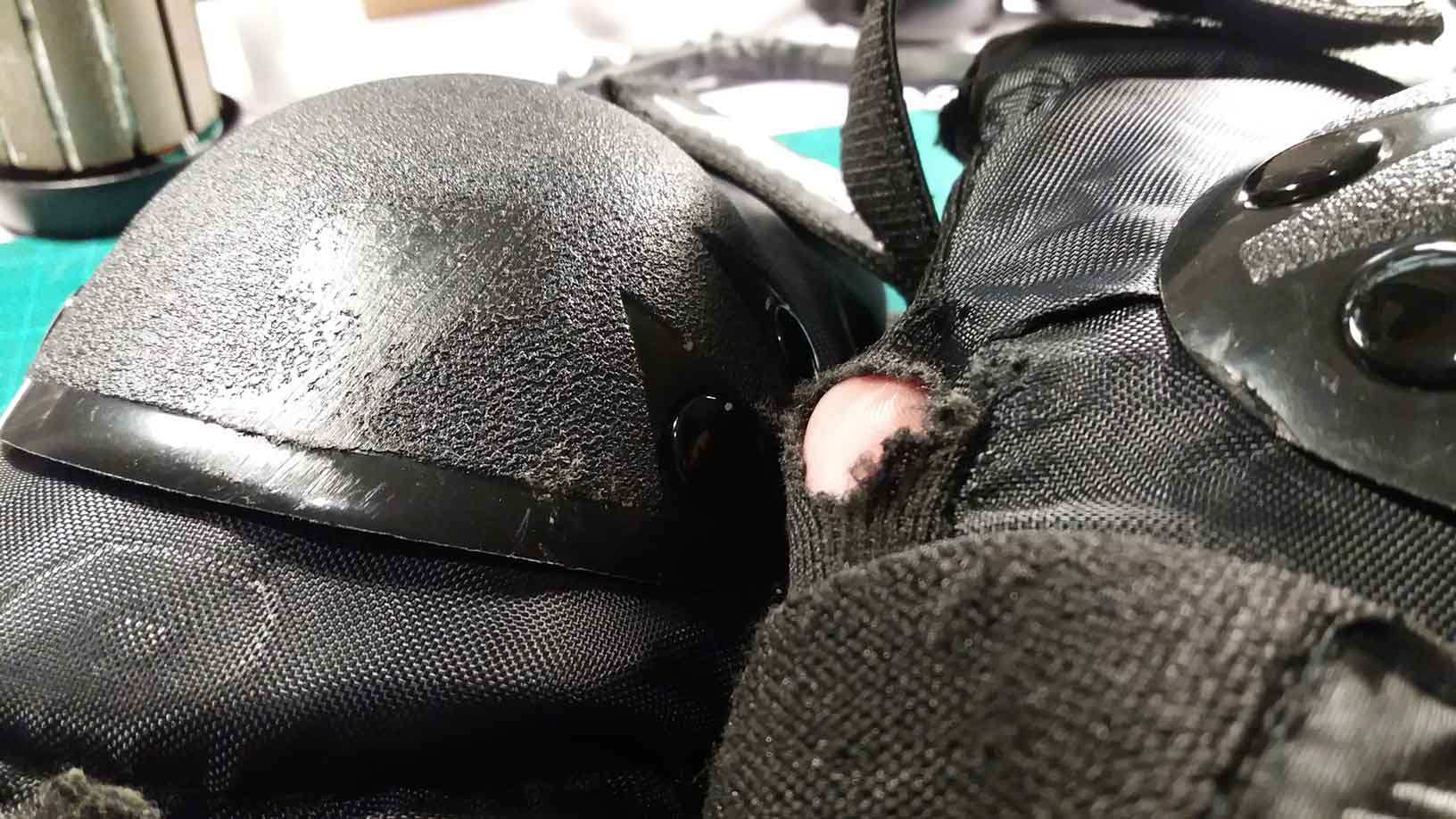

Then I had to do something at least trying to footbrake which is tricky with the flexy Trampa deck and it didn’t work. I can’t remember the fall but I was sliding down the street and then watching my board rolling downhill. On the left and right side were parking cars. After some contacts with curbs the board crashed into a tire of a van.
Luckily the board and the van are OK. And most important I’m OK thanks to hard shell elbow pads and wrist guard gloves, just a bit road rash that’s it. Without protectors I definitely would have serious injuries after sliding with 35-40km/h (22-25mph) on concrete and cobblestones.

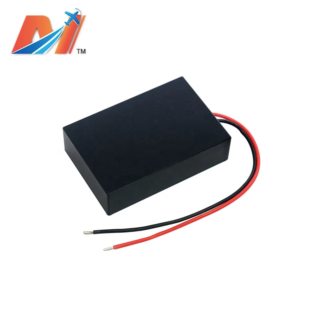

I can’t remember the name but was reading about an external device which transfers the power of regenerative braking into heat if the battery is full. I guess this is what you mean with balance for the entire pack but within the BMS.
That looks designed to protect the ESC, not to protect braking ability.
It is very similar.
My fear with that would be if you weren’t bypassing your BMS, then you would still have brakes even if you went overvoltage, but as soon as you let off the brake, your ESCs might reboot. It depends if their filter caps kept them running long enough for your BMS to reset/recover.

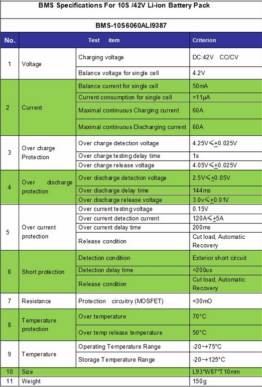

Also I find it odd they chose 57V as a set point and don’t understand why it says “10S and below” for battery.
I think it covers and fixes the full battery breaking situation and also read that they are working on a 12s model, I believe I got this from @hyperion1’s posts in the other place but subject to correction on it

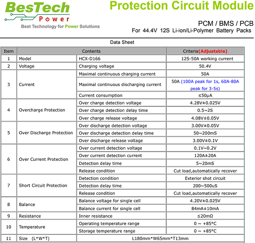

As you say this I realize my Bestech BMS on the MTB doesn’t cut off with full battery when braking on the same steep hill whereas the other BMS on the Carver does. But no idea if the Bestech overcharge the battery or dissipate the heat somehow.
shit dude, thank god you’re okay. usually if my boards full I’ll pelt around the block once to get my voltage down a bit and then i go down the hill just to avoid this. it’s scary i feel ya
The 223 bestech BMS uses different connection points for charge and discharge.
This coupled with the facts that
I was able to increase my regen current way above the rated charge current.
It has never cut out on me although I live on a hill and many times start fully charged
@esk8manbabes had wired it the other way around and was discharging via the regen path.
Leads me to believe that the regen current does not go through the charge circuitry but directly to the battery.
This means that it will slightly overcharge your battery when starting fully charged on a hill but I will take that any day of the week vs no brakes.
Ok, so yours probably has different circuitry than the bestech.
As far as what it should do, it is debatable. There are advantages and disadvantages in both approaches.
I’m just thinking loud, maybe the proper Bestech ignores charging voltage and read cell voltages only. Maybe the cheaper BMS cuts off because of too high charging voltage and not because of cell voltages above 4.25V.
