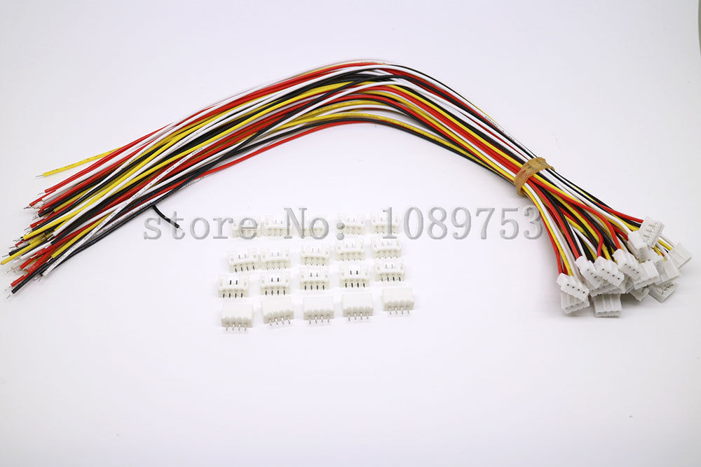

I need one of these with wire attached so I can solder to this
Telemetry and power lines pulled out of the connector when I was installing the angled riser for davegax.
Think it’s jst something or other.
Measure pin to pin distance and it will tell you the jst type generally. Let me know what kind and I’ll see if I have any.
It looks like just a hair shorter than 1/16", so 1.5mm. ZH I think?
I’ve got a shit ton, although idk if it’s even the right size
It is jst, just make sure you get the right size. I suggest getting them on Amazon. They’re dirt cheap

F I have only 2, 5, and 6 pin versions
How do I messure the size of one
Caliper measure between pins. Tell us the value.
With a measuring tape lol.
seems like 1/16 or around 1.5 mm
1.5mm is jst zh

2mm is ph. I blame your measuring tools :stuck_out_tongue: . Invest in calipers. They are a necessity.
I am using calibers lol.
I don’t have calipers, used a wack ass measuring tape.
Might be PH?

Confirming that it is 2mm ph connectors.
My davega cable and a 5pin ph connector.
@Saturn_Corp send me a PM I’ve got extras
