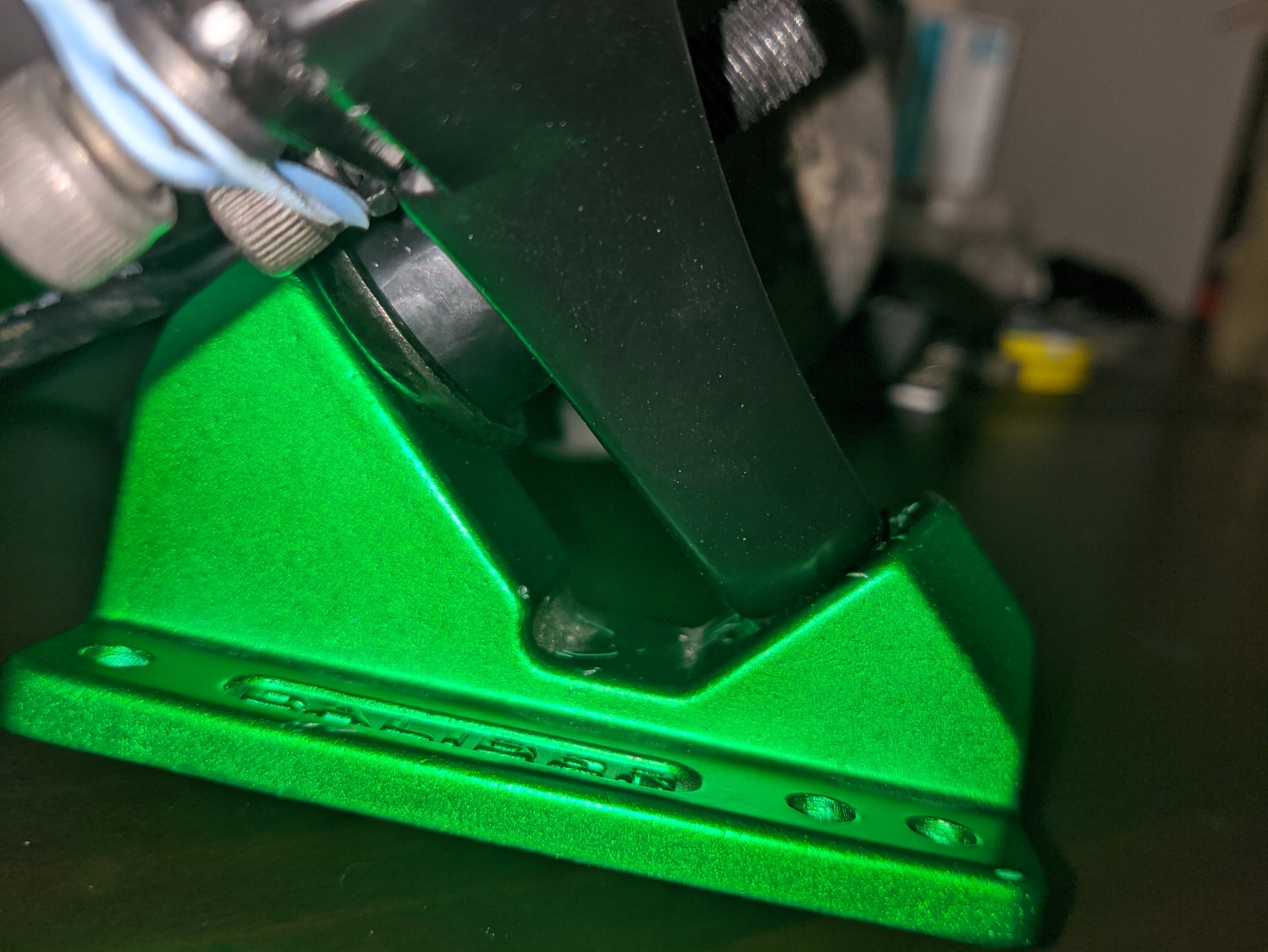

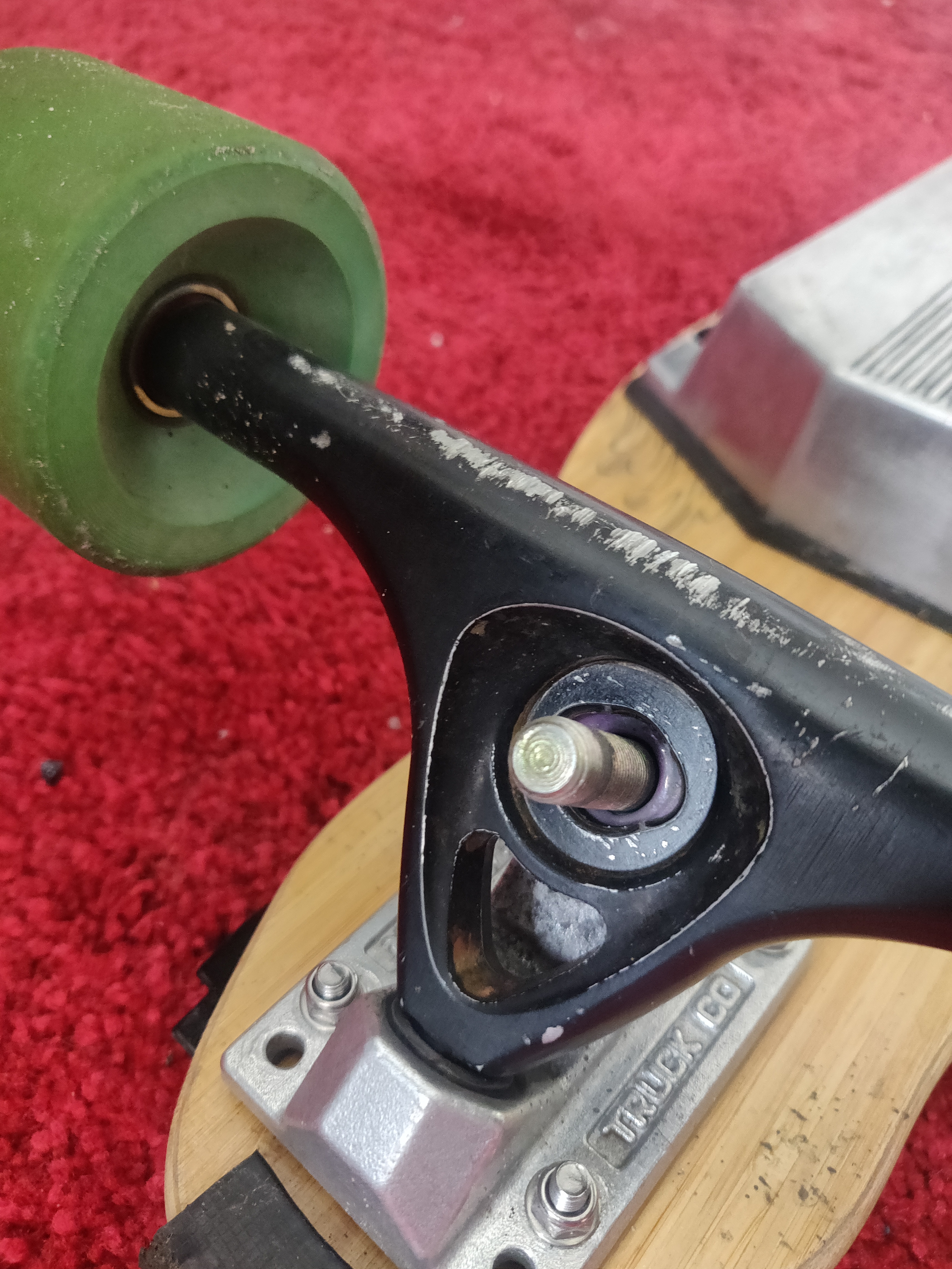

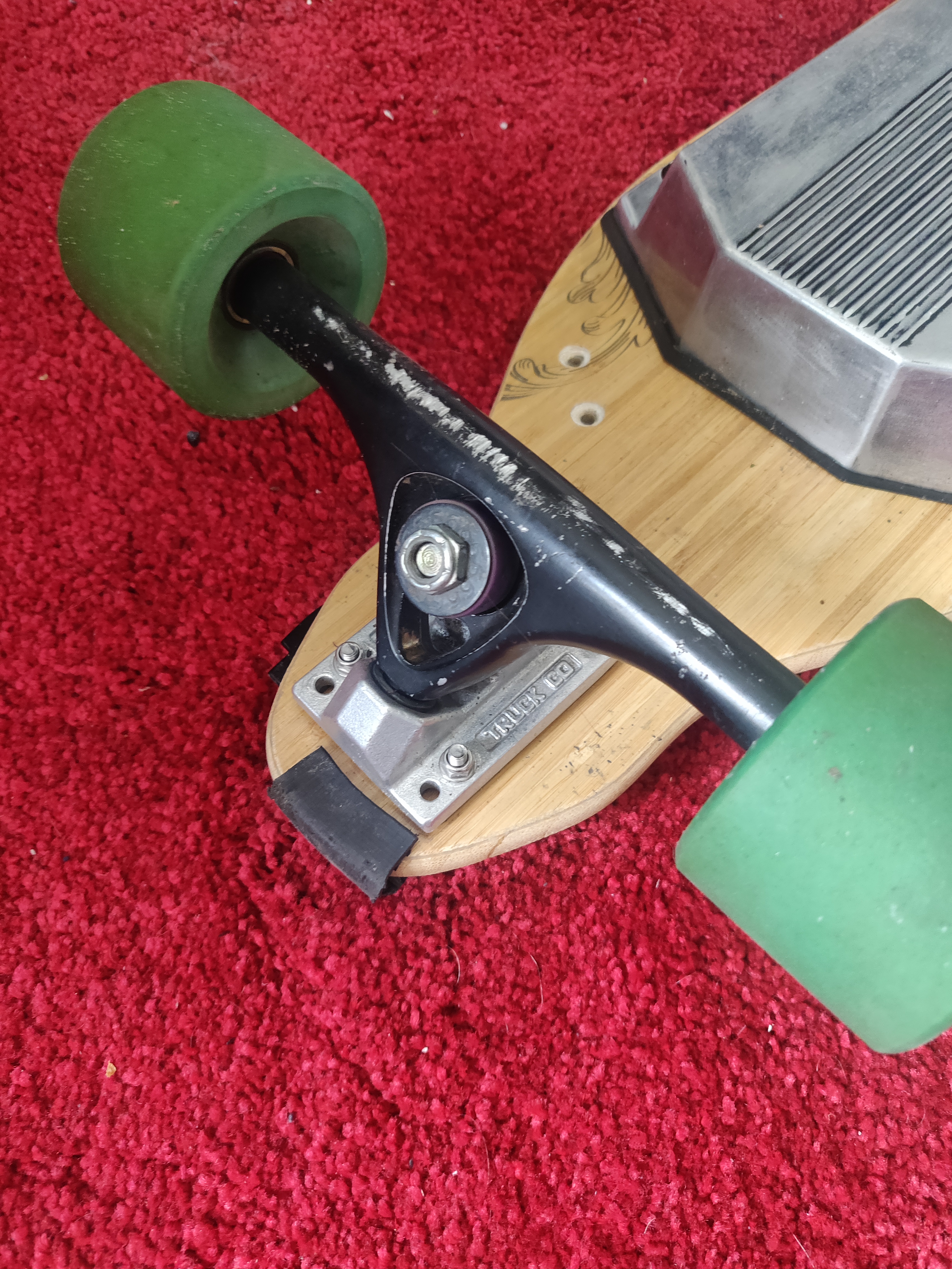

anyone have a single Paris hanger thatâs extra? Any condition or color, as long as itâs not bent or broken
canât be clone
I donât have a Paris hanger but I do have baseplates and the clone hanger didnât fit the OG Paris baseplate

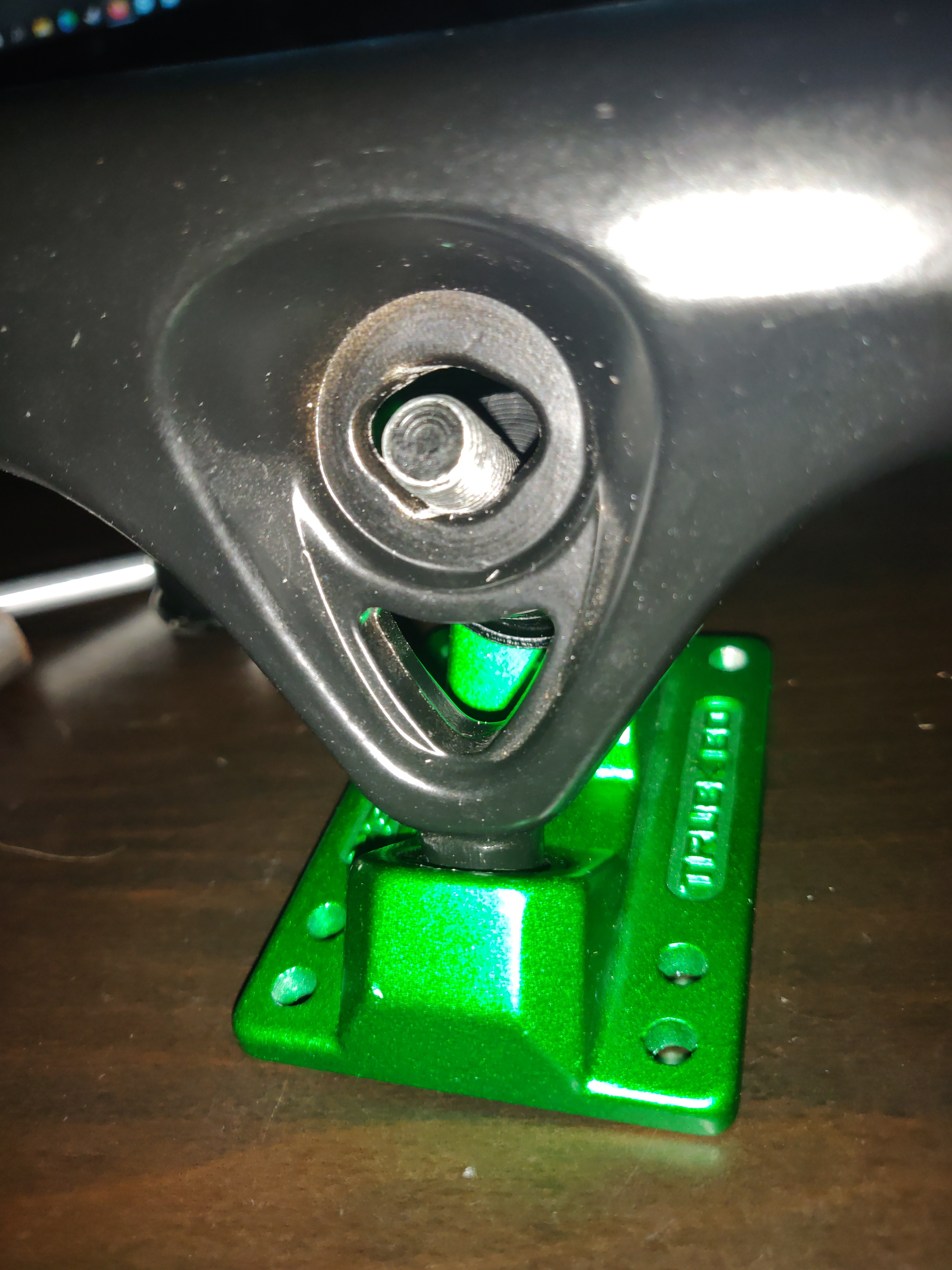

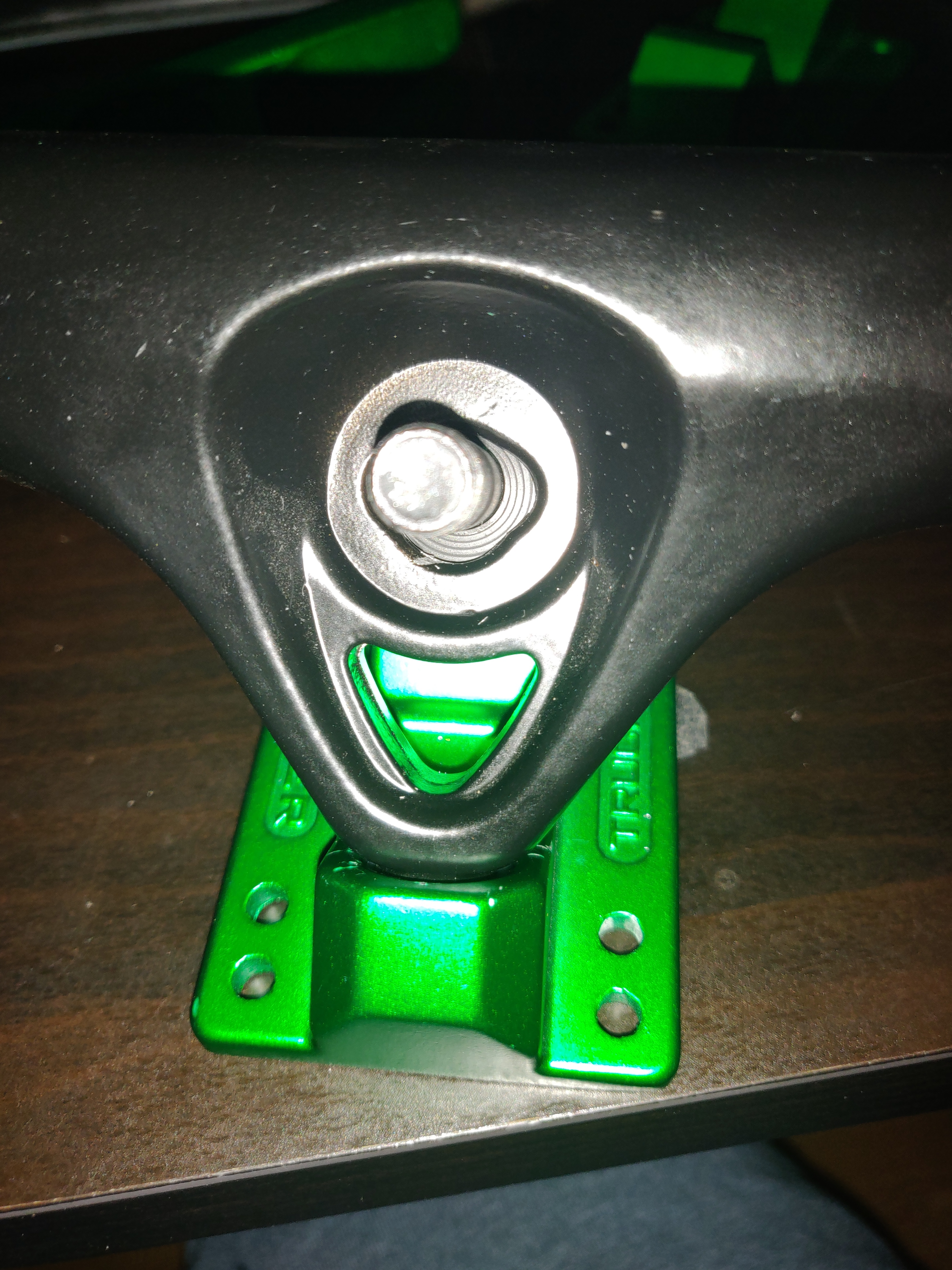

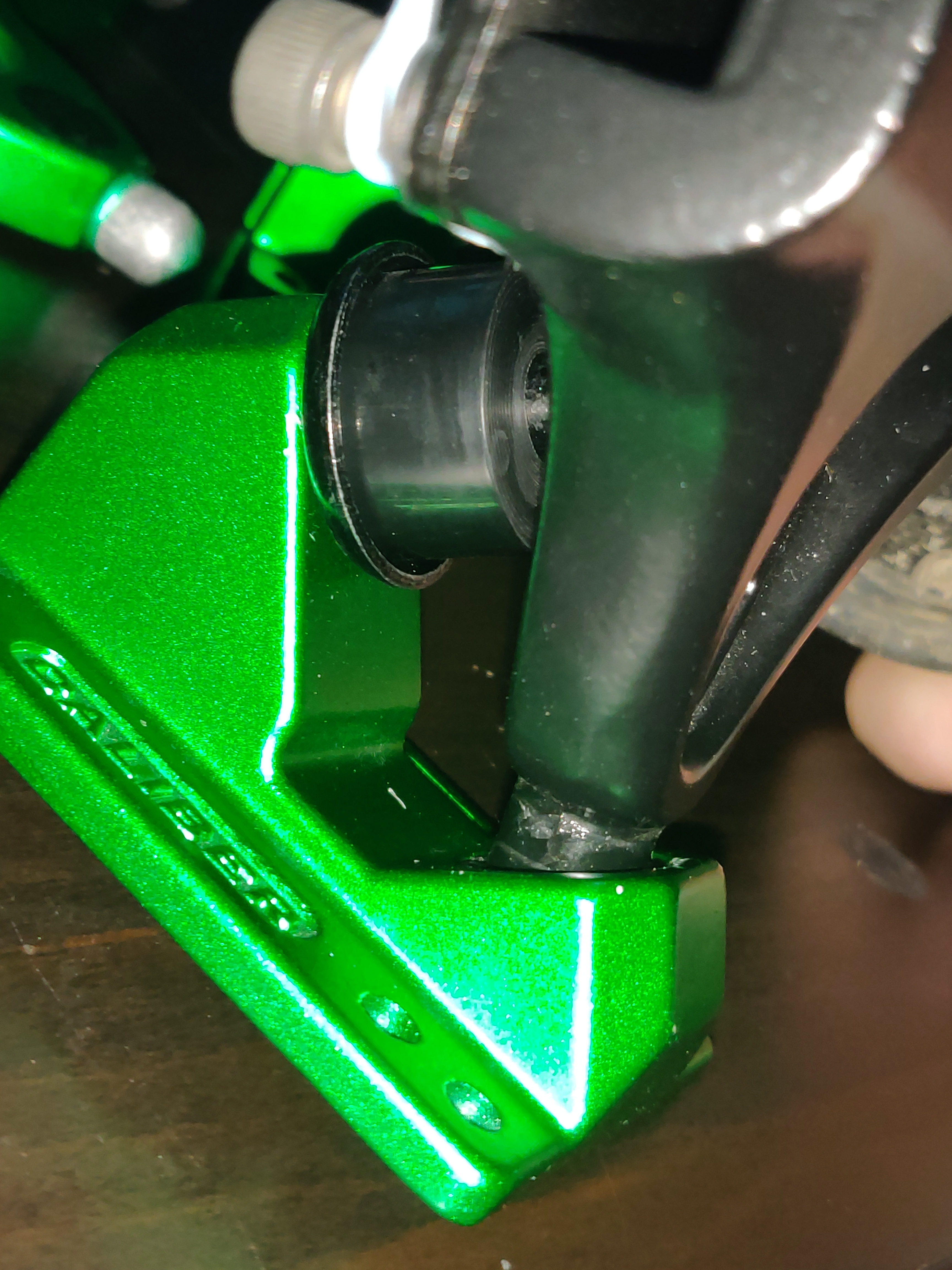

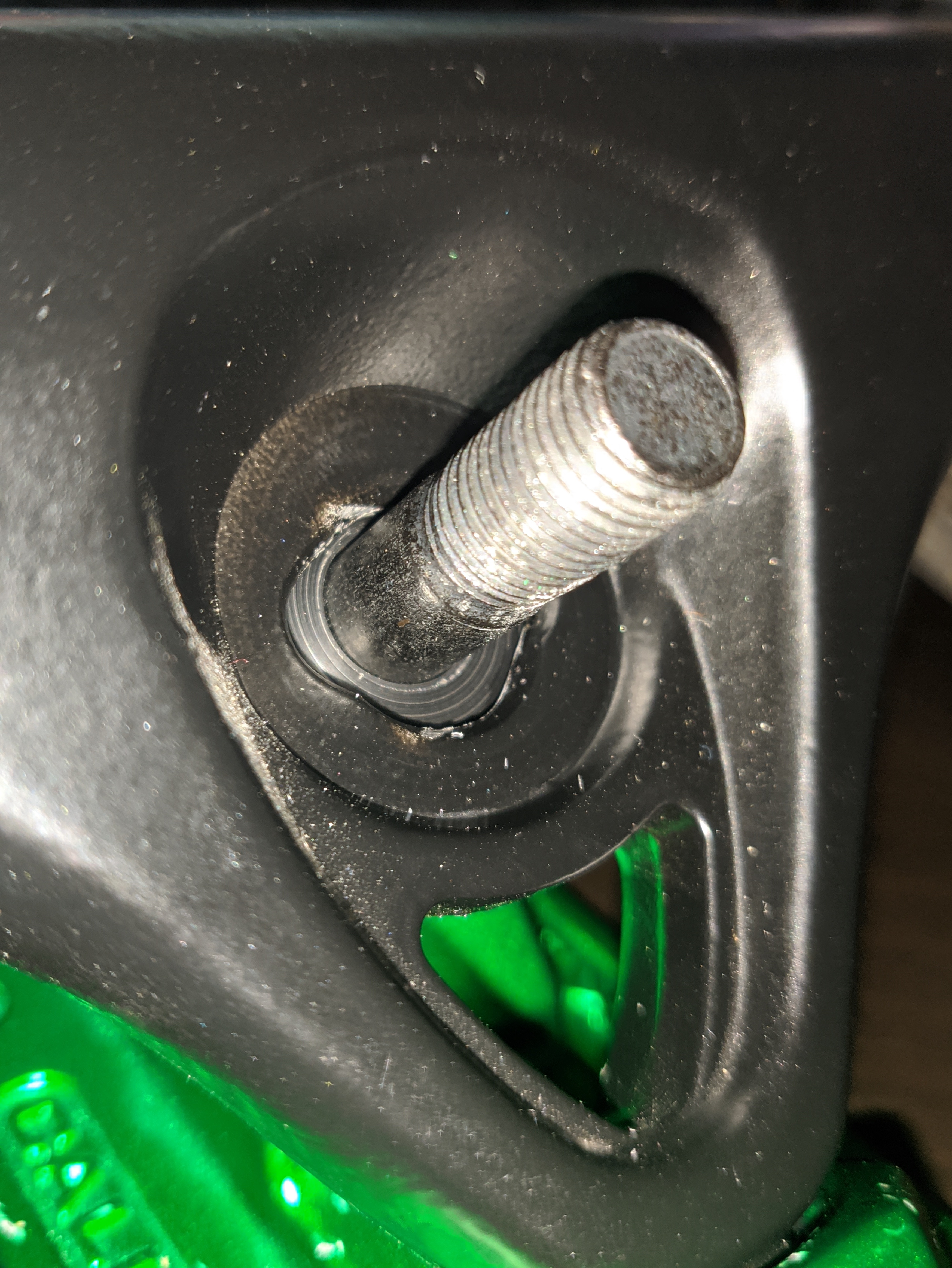

Uhm wtf. It seems like that the pivot cups was the cause. I used a different one that is shorter than the one is tested it with.
Can somebody with the Riptide pivot cups measure the height? *caliber

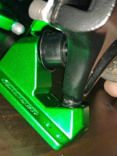

With the taller one i couldnât get it over the kingpin
this is with a different pivot cup
Yes the pivot knob is a bit thicker on the paris i believe so maybe swapping out the cuo helps!
Edit: now that i see all the pictures, congrats i smell the diy spirit!
Luuk back at it again with the thick knob.
My other problem now is that the fitting pivot cup only fits in the 50° baseplate and not the 44° i want to use now.
Gotta order riptide ones and hope they fit
*on the 44 it just flops out when turning the plate upside down
you mean @mackann his baseplate or the normal caliber?
normal caliber.
cup fits 50 but not 44
Donât forget thereâs like 3 different caliber pivot cups on riptides site haha
Already got that sorted out ![]()
This is super normal. Riptide bushings are thicker. I know when I had Paris trucks and baseplates, and switch from stock to riptide, it was mega hard to fit. So either you scratch some paint off like you did, or you use superman force like I did to squash the bushing with the hanger and make the kingpin fit without scraping the hole
iI have not experienced this with Paris trucks except the V3 since they shortened the king pin and bushings to non standard sizing
Yes I had V3
Paris really screwed the pooch on that choice. You now need a conventional .6" boardside and a .5" roadside in the Paris V3âs
i forced on the caliber bushings Brad and it works
itâs a small not very fast board so i didnât care.
@BigBen just so you know, thatâs what the aileron was running when i sent you it
Thats nice man! It even looks good! Glad you got that sorted out.

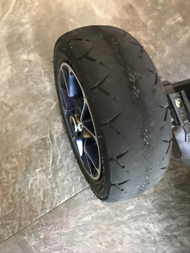

Anyone got any street tires that fit mbs rockstar IIs. anything 150 - 190mm
some old race slicks you want me to finish off? I can do it.
managed to fully kill 3 more tires in one day on the same board.
With this deal in the works and the sunmate group buy on order feels silly to order another set of tires from somewhere⌠but hmm. Iâm kinda out of tires.
