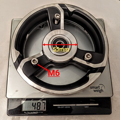

I’ve been looking into tires with short sidewalls because they roll better and steer sharper. I wanted wheels bigger than my 200x50 but smaller than 10".
I found the VSETT ZERO 9 split hub on AliExpress and paired it with 8.5x3" off-road wheels.
The sidewall is a bit shorter than my 200x50 - 40mm compared to 43mm.
https://a.aliexpress.com/_EHALuir
While the Zero 9 hub has a 60mm axle width, the seller pointed me to the ZERO 8 scooter front wheel hub, which sits at a narrower 41mm.
The bearing seat accommodate a 6000 bearing (10x26x8mm). I grabbed all four wheels (hub, tire, inner tube) on a deal for 156 euros during the ‘Back to school’ sale.
As a bonus, the seller threw in 12x26x8 bearings and spacers suitable for 12mm axles. Just a note, these bearings might be tricky to get out because they’re tight together.
Now, I’m curious if anyone here can craft an HTD5M pulley (ranging 74T to 80T) tailored for this hub. If there’s enough interest, we might even consider a group buy for it.
Thoughts?
Cheers!

I can absolutely design a pulley for it, with that much surface area i’d wager you could even 3d print one lol.
I think it’s 3 parts with 2 o-rings sealing them

Thanks! I was actually thinking of a 78T or 80T aluminum hollow pulley. Do you think it’s safe to use a plastic pulley of that size?
can’t confirm that. The part of the hub that contains the two bearings seems to be press-fitted metal
If it was me, id do a plastic pulley insert with lasercut aluminum shims to construct the teeth. But thats just because i dont have access to a CNC machine.
