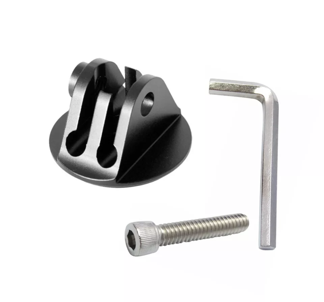

Maybe something like this? (Ignore the orange phone mounting part)
A thin plate mounted onto the headset of the handlebar. Would be universal for all bikes and won’t come loose ^^
Comes as a GoPro mount version too
How many vibrations per second does your tripod experience? :laughing:
That mount is specifically designed for bikes so I imagine vibrations is something that has been taken into account. Also, the baseplate could have a rectangular recess that mates with the mount profile. That would prevent any rotation. It’s a simple solution that could just work. IMO it’s worth testing before going with something complicated.
That also looks good. I’m just not sure how universal it is. I imagine it won’t work with some (many?) handlebar designs.
Apart from super high end road bikes this should be compatible with pretty much any normal bike afaik
This cap on the fork/stem is standardised.
My bmx be like, but I’m also normal bike :joy:
