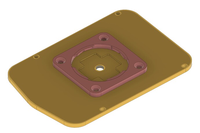

I spent some time on the handlebar mount. Here’s what I came up with so far. The idea is to have a general purpose baseplate that could get attached to pretty much anything. For a quick setup one could use this simple inexpensive camera mount:
That one would attach to this part of the baseplate:
The recess would prevent any unwanted rotation. The cross shape allows 90 degree rotation.
There are also four new M3 holes that could either be used for custom solutions or one could 3D print and attach this Quad Lock adapter:

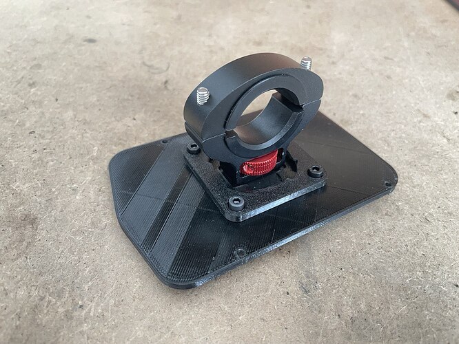

Here’s how my test print came out:
The camera mount feels very solid, even in combination with the 3D printed baseplate.
I don’t have any Quad Lock holder on hand so I haven’t been able to test that one yet. One is in the mail already though so will hopefully test soon.
One issue with the camera mount is that the screw is a bit too long:
It’s not a major issue. It still wouldn’t collide with anything inside the Megan housing. It just looks ugly. This is just a grub screw though and it’s easy to replace for a shorter one – if one can find it. This is a 1/4"-20 UNC thread. Not so easy to find in the EU (though it does exist).
Any comments or suggestions would be much appreciated.
You could make the plate thicker for more thread engagement, but seems pretty good otherwise. Maybe some more holes, like M4 or M5 in a square pattern for custom solutions would be nice?
