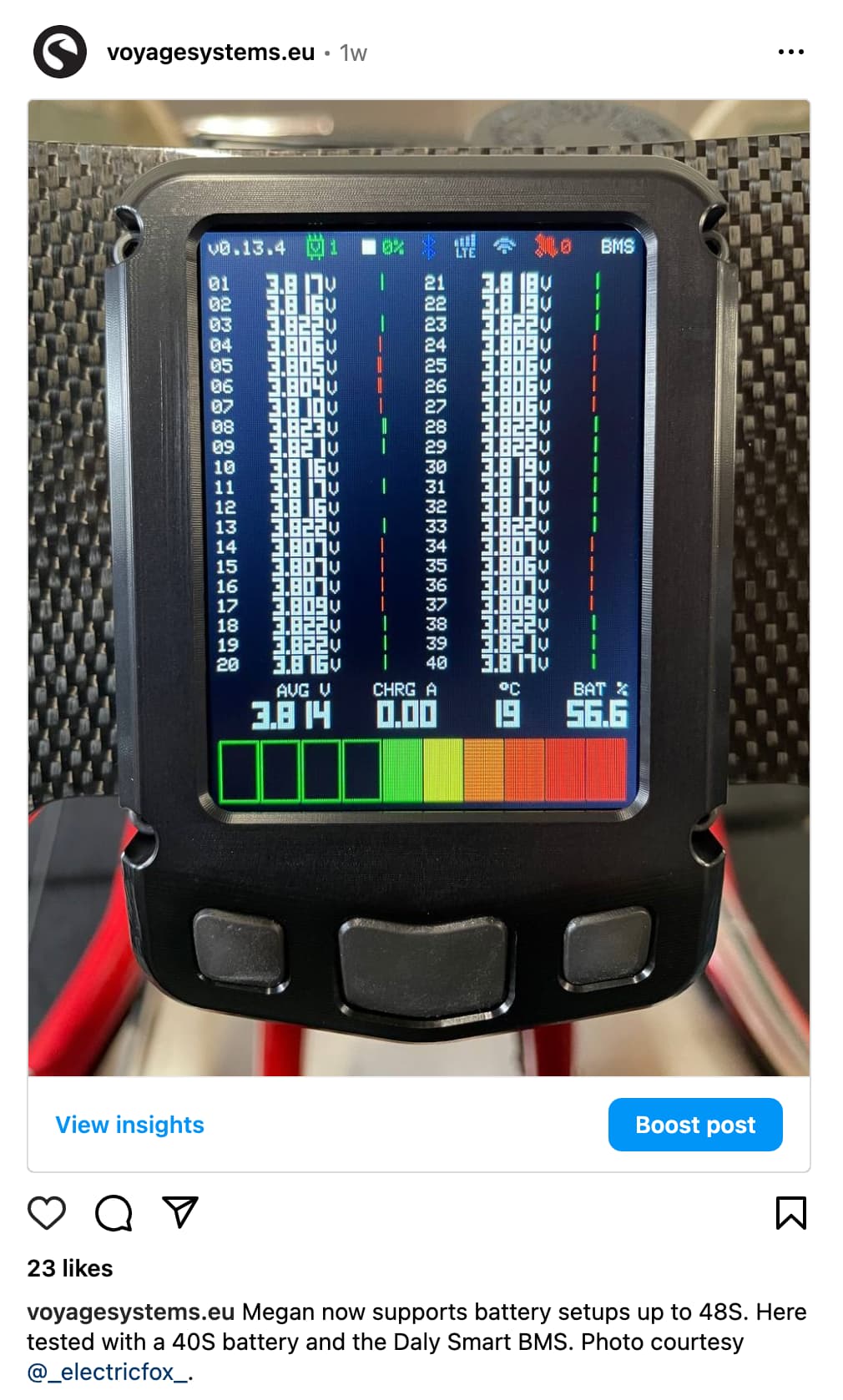

trying to read the cell voltages at 48S on the display like

I’m just hoping that 48S is ridiculous enough for anybody because I’m really out of ideas on how to squeeze more items on the screen.
Scrolling screen
Like @frame said, I think the answer is you don’t squeeze more items into a screen, you just make the screen (synthetically ) bigger.
Having multiple pages with different layouts you can cycle through seems ideal to me. Maybe one of the options would be the ā€œsee everything at onceā€ option, but I have a hard time imagining this page being useful just based on how hard to parse it is (not to mention doing so from a standing position). I’d think it’s most useful to just display the highest 5 (or whatever number fits comfortably on one side) values and the lowest 5 values on the screen and if there’s more than 10 or so values just hide the rest to make the important ones more legible. IMO the highest and lowest few values are probably what anyone looking at all the cell voltages is looking for anyways. If you wanted to give a quick representation of how consistent the middle values are, you could also include a statistic like standard deviation.
Only list the highest, the lowest, the average, the standard deviation, and the maximum delta.
