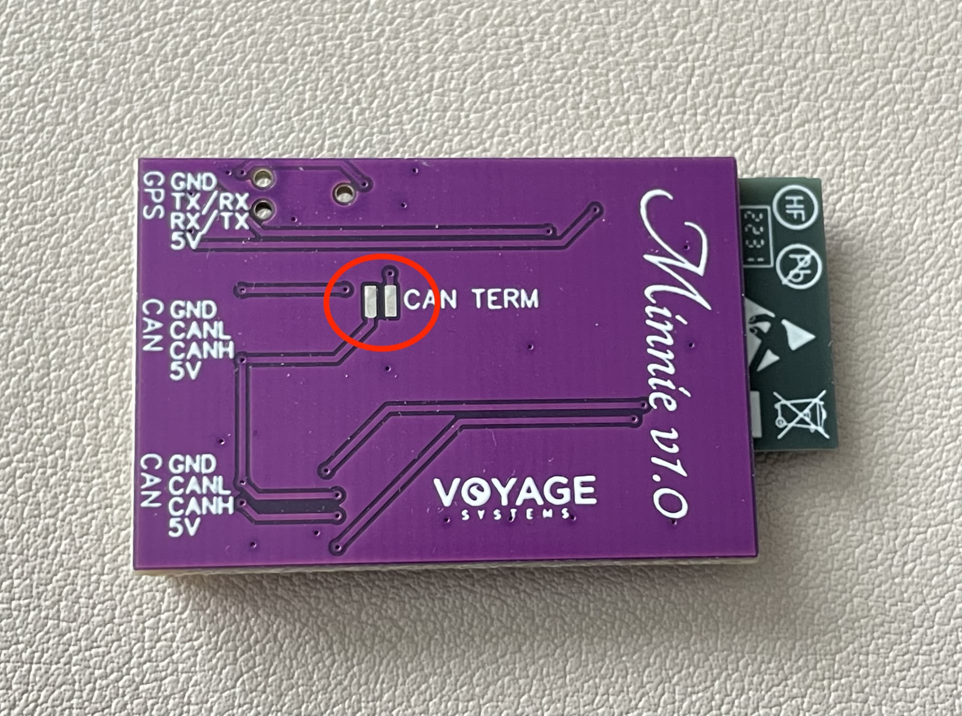

However isn’t Daisy chaining the can line a bad idea anyway? What’s the can impedence on that line with the Minnie in circuit? Does it drop to 40? Or does it become end of 2 lines?
that’s how canbus works
Is there a 120ohm resistor in the Minnie?
that’s a question for creator, not me
Pretty sure you want the total resistance on the can line to be 120ohms, ie 60ohms on first node and 60ohms on last node in CANBus chain.
Yeah 120ohm resistors in parallel at each end for stability and to prevent signal reflection. Just wondering how it’s running in this situation.
What about connecting a tvs diode in parallel?
Do you know how it works? Or just that it doesn’t?
There is, but it is disabled by default. To enable it, you need to solder this bridge. In practice I have never seen this actually make any difference.
Ah cool :+1:. Still a good wiring practice to follow or place to start if there was an issue.
