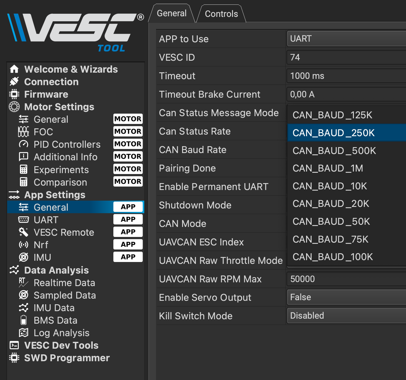

We just finished implementing the integration with the Daly BMS units. It will be available for both Megan and Minnie. The setup is as simple as connecting the Megan/Minnie, VESC, and the BMS to the same CAN bus. BMS data can then be viewed in the Metr app or directly on the Megan display.
Just to add, it requires getting the CAN baud rates aligned. Daly BMS communicates at 250K and it can’t be changed. Most VESCs are pre-configured to communicate at 500K but it’s easy to switch to 250K.
Megan/Minnie auto-detects the baud rate so no configuration needed there.

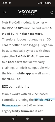

Little confused here… Will Minnie work with ESCs runnings custom fw like Spintend ubox v2 and MakerX D100s?
Yes. Spintend snd makerX firmware isn’t ‘custom’ as such, it just requires several default values to suit their hardware to be safe.

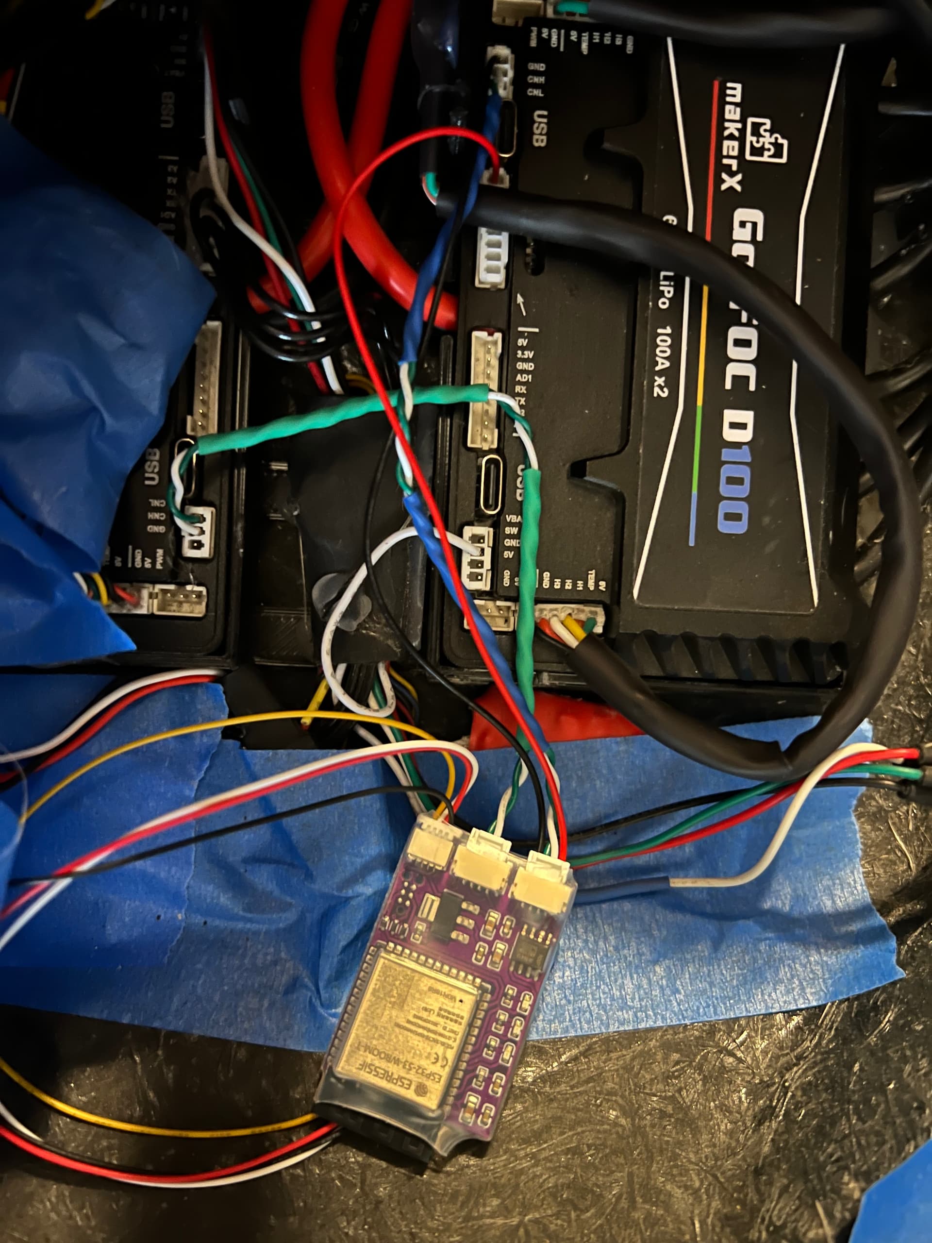

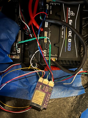

Got mine installed, twisted up the CAN cables and heat shrinked it.
MakerX CAN ports unfortunately are only 3 pins
Gross. But I guess it’s better than a fake 5V pin like some ESCs. Notoriously, the TB6
