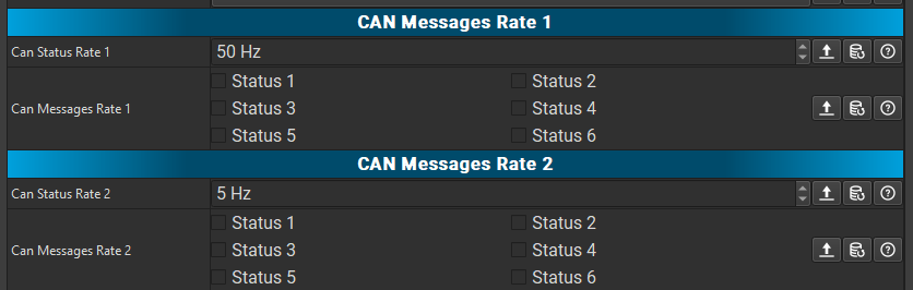

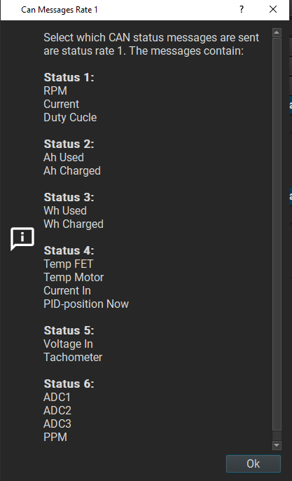

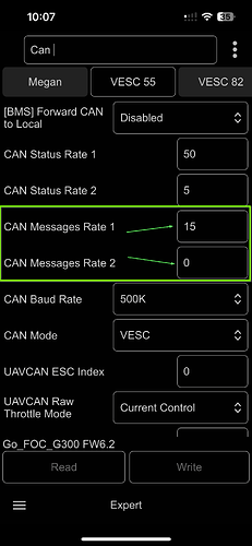

I assume this is because vesc is bitfield packing the Boolean values into a single integer variable(or something), and vesctool has the checkboxes hard-coded for those variables. Having 4 messages enabled is 00001111 = 15. Just a guess tho
Specific toggles/dropdown for these would be really nice

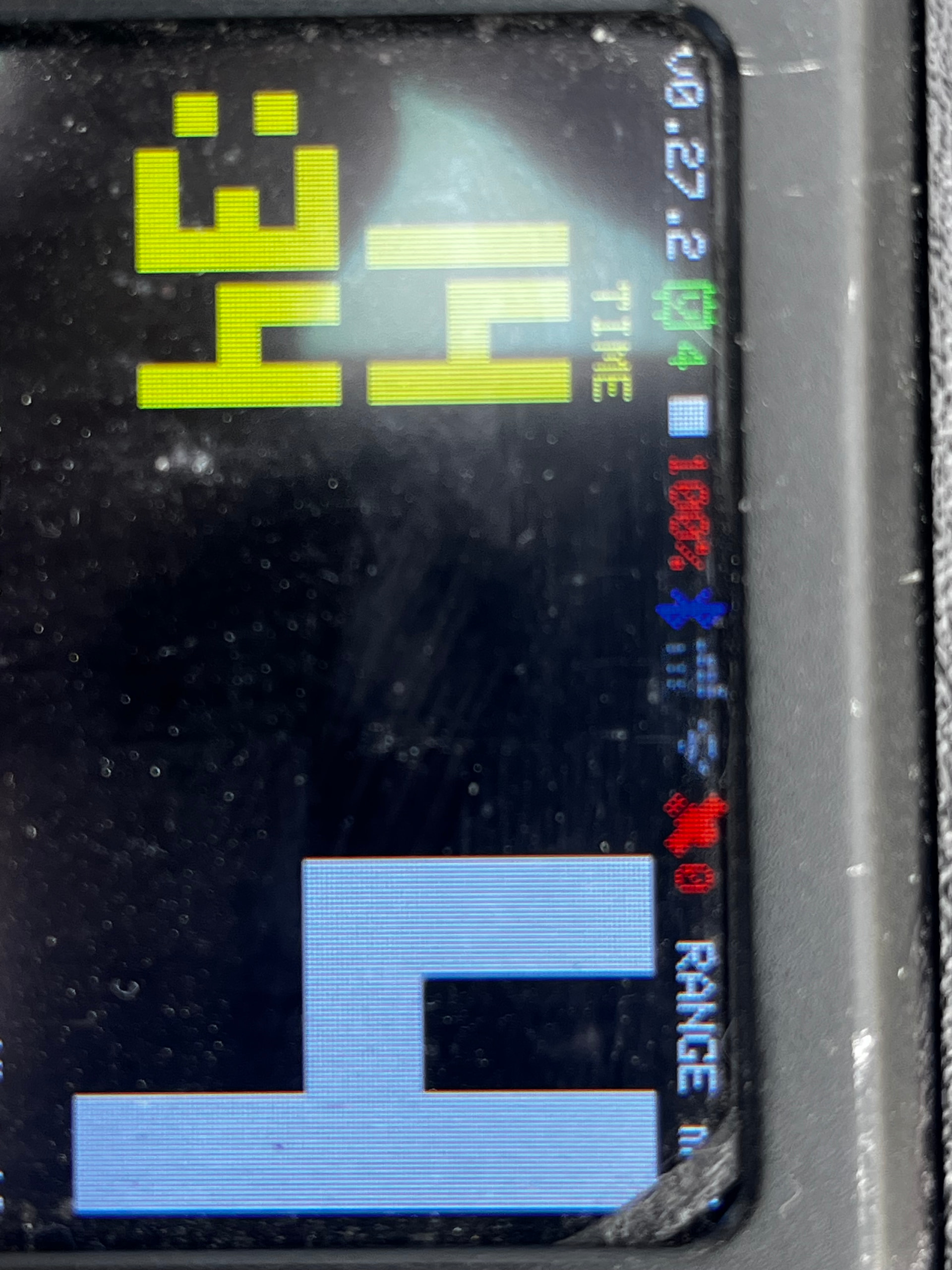

On Megan, open the menu and select “Upload records”. That should upload whatever can still be uploaded. The 100% flash use typically indicates the filesystem got corrupted, which may happen occasionally. If the “Upload records” fails repeatedly or if the use still shows 100% after the upload succeeded, you will want to reformat the filesystem. Simply select “Format filesystem” from the menu. This won’t affect your Megan settings. Only the not-uploaded records will be lost (I hope you didn’t have too many).

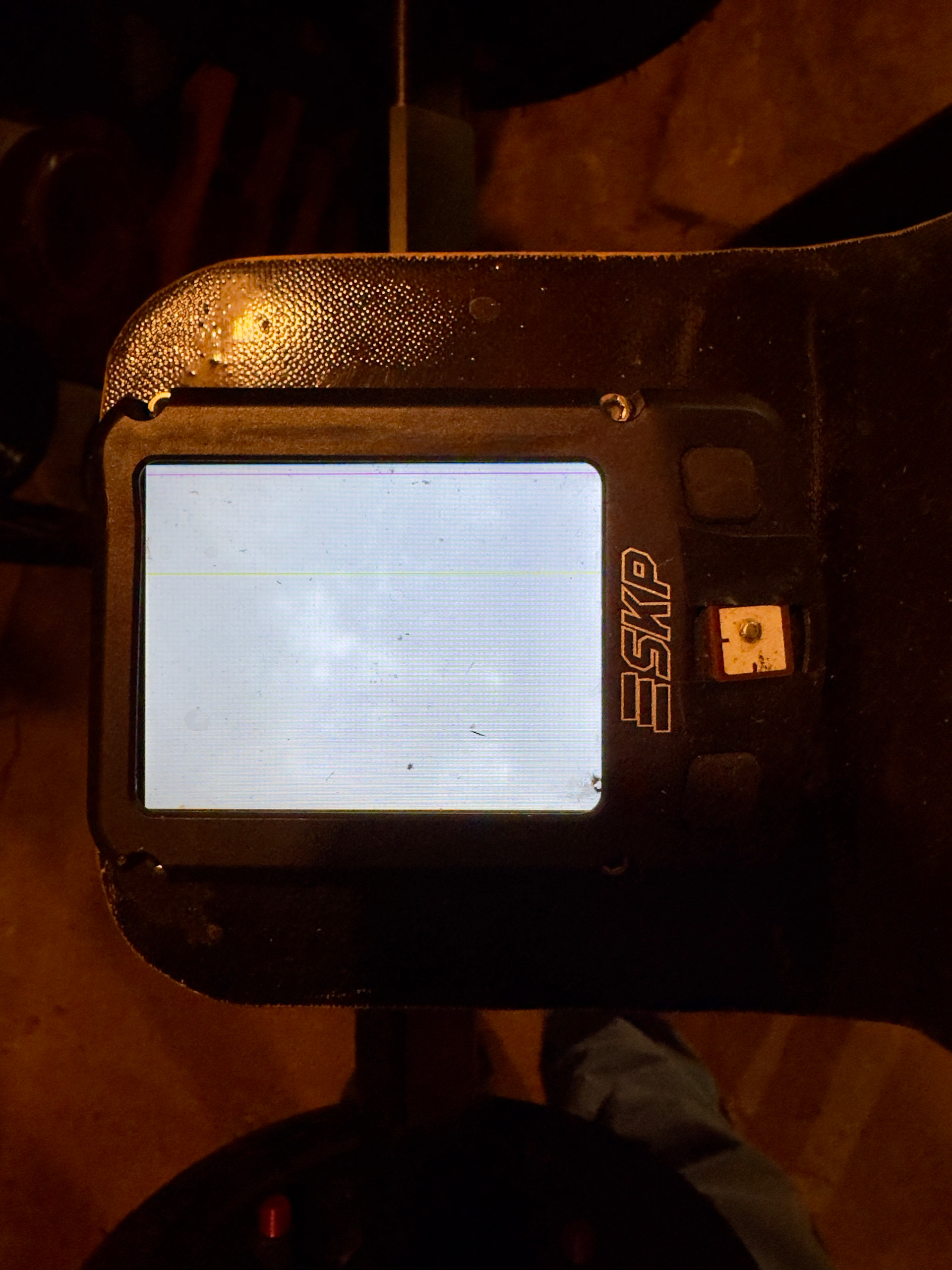

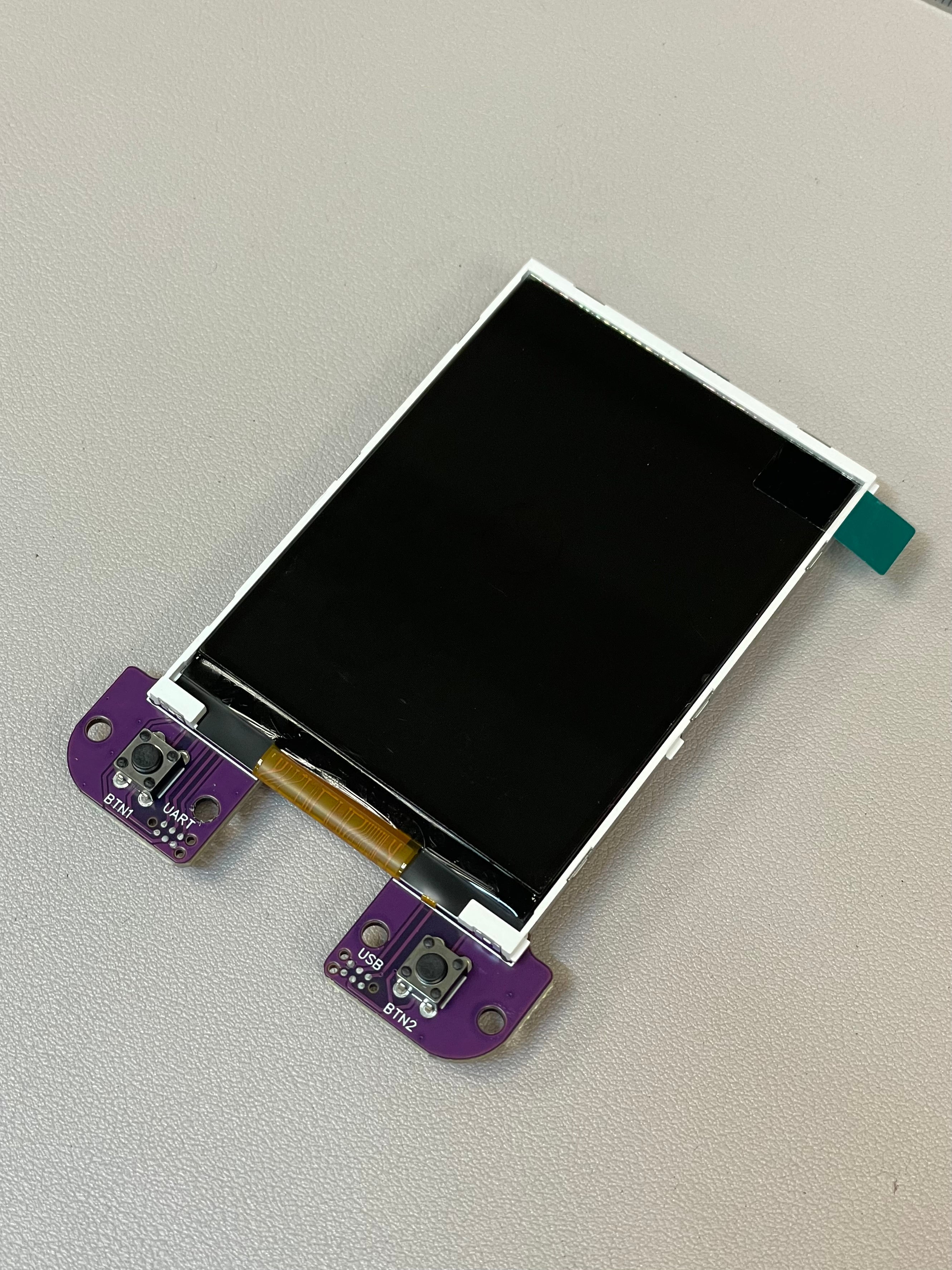

So tragedy - my screen looks dead. The rest of the unit works fine (telemetry, logging, connectivity). Any way to just replace the screen, or is it too integrated?
