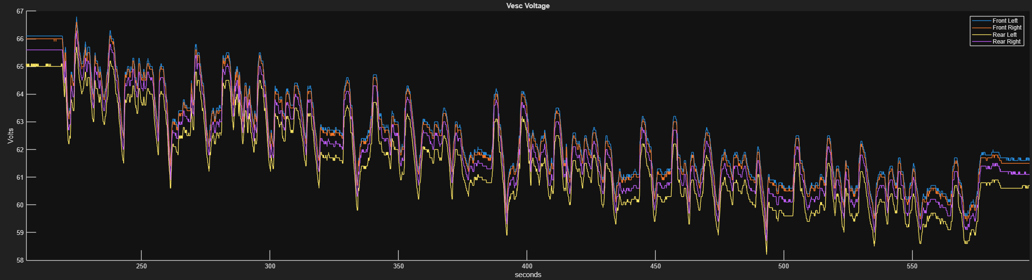

I noticed that in logs battery voltage isn’t split out for each ESC like currents, temperatures, duty cycle etc.
On Ankle Wreacher I have 4 VESCs wired individually, and was/am curious if I’m getting voltage drop across the wires between my G300s.
  1. Would it be possible to record individual voltages from each ESC?
  2. My Megan is connected over CAN. It is an average of all 4 reported voltages, or from a single vesc? Which one? (lowest CAN id or something?)
I have found that vesc voltage readings are not completely accurate compared to the actual battery voltage and it makes me wonder if they would be accurate enough at all to calculate voltage drop?
I found they have like a ±0.5V gain error and I have voltage drops of easily 10V+ on the battery so it’s definitely good enough to record overall sag, but most of sag is in the batteries and internal connections, not in the output cables so I don’t think measuring multiple vescs really help anything here.
That said the voltage data is in the CAN packets if anyone wants to make a logger that records it.
There’re also settings in Metr to smooth out battery voltage readings and margin. Not sure if that matters or not.
Megan does actually log the voltage for all ESCs. However, when we process the uploaded file, we only keep the voltage data from the first ESC – the first would be the one with the lowest CAN ID, yes. The reason for this is that for most people, all ESCs are connected to the same battery and thus the voltage is the same for all.
Your particular setup is special and I understand that for you specifically it would make sense to retain all voltage values.

So @janpom, I looked into this more with TITS, where I can log stuff.
Here’s a chart of the voltage from a couple minutes of racing.
@Dinnye is totally right. My 4x G300s read up to 1.1v different at rest.
Subtracting out this static offset, all voltages remain within 0.1v of eachother, even when pulling 100’s of battery amps. Considering this is the resolution of the data in the CAN packet, literally couldn’t be closer.
TLDR; there’s no appreciable difference in the voltage at the 4 vescs
Pending an even weirder setup then mine, I now think individual voltage logging is entirely unnecessary :smiley:
would likely only cause confusion to users (from the static offsets). Thanks for humoring me :slight_smile:

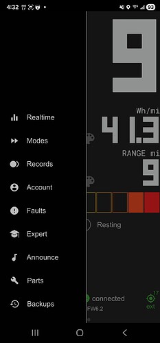

I’m missing the open menu icon at the bottom left of the screen. I can still access it if I tap all the way near the bottom. But when the menu opens I’m missing the setting tab, I could still access it if I tap all the way near the bottom. I’ve reinstalled Metr app and updated the firmware.

Just had this issue last week. Reinstalled the app made it worked again for me but I lost the menu icon at the bottom left of the screen, the interface still seems to be there cause I can still open the settings menu. It seems be to be doing some weird stuff.
Sorry about that, I accidentally released an update that targets new Android SDK 35 and this issue is not easy to fix. The old releases did not have this problem but I can’t upload any of the older releases anymore, because those were targeting SDK 34 and Google does not allow that for new releases :frowning:
Please use this APK as temporary workaround Sign in to your account

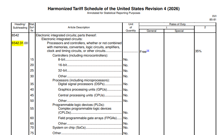

FYI for anyone dealing with tariff issues, a Minnie will fall under the US Harmonized Tariff Schedule heading of 8524.31.00, suffix 25 for a 32-bit microcontroller (specifically an ESP32-S3). This is 100% tariff free (see column 1, column 2 is if you’re importing it from a very few number of countries you would never import from, like North Korea.)

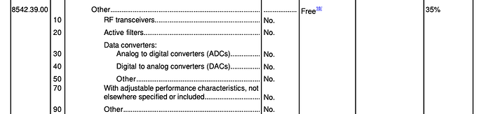

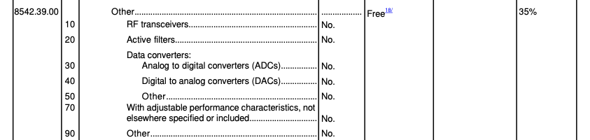

Section 8542.39.00 would also include the GPS and probably WiFi aspects, though I doubt it’ll come to that (this is also tariff free).

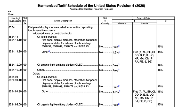

If you import a Megan, that would also include the display, which would fall under 8524.11.10 (actually 8524.91.10 – 8524.11.10 excludes a hardware driver for the display, but neither heading has a fee, and I doubt someone looking at the unit will be able to assess the difference). This is ALSO tariff free:
