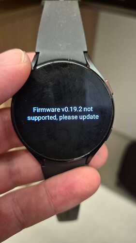

@rpasichnyk I managed to install on my samsung watch, but receiving the error of wrong firmware. But firmware is up-to-date. Do you need to release a new firmware for this to work?

I had the same issue on my Apple Watch but I msg them and you have to turn on beta updates. Also I did the update through the metr app due to some weird WiFi signal error on the voyage connect app and it worked.
It worked! Thanks man.

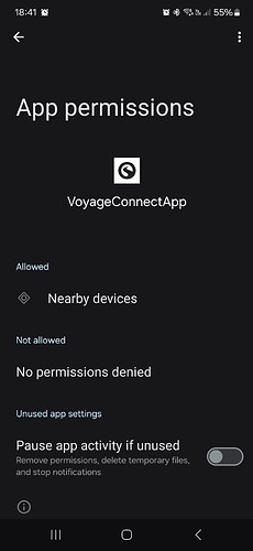

  • It says it’s missing permissions, but all permissions are granted.

**[W 14:21::49.456] :0 Search not possible due to missing location permissions**
[E 14:21::49.457] cble_discovery_agent.cpp:123 onErrorQBluetoothDeviceDiscoveryAgent::LocationServiceTurnedOffError

Maybe try to delete the app, install it again, pay attention to permissions which the app is requesting when pressed on the scan button?
I will have a look on Monday and try to figure out if there is anything missing with permissions.
I did that couple times, erased app data, forced it to stop, uninstalled, installed again…and even got my wife phone to do a fresh install…nothing working.
Here are some screen shots of app permissions hope it helps.
I haven’t been able to reproduce this issue. I have tested with Samsung Galaxy S23 FE (Android 14) and Google Pixel 6 (Android 15 Beta 2)

Can you please make sure you have all the latest software updates installed on your phone? Maybe you also have an opportunity to test with some other phone?
Thanks for looking at it.
I have used on S24+ on both phones (Android 14 as well)…i am pretty much sure the bluetooh was on, because i could connect using Metr…not sure what else to look.
