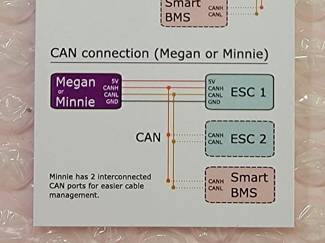

Iā€™m planning to install my new Minnie on my build which uses two single VESC6ā€™s. Based on this wire guide, it seems to me that the easiest way to connect everything is to plug both of the CAN wires from the Minnie into each CAN port on each VESC. That seems to be the intention of your design, based on that note in the bottom left corner.
My question is, are the CANH and CANL pins of each CAN port on the Minnie directly connected to each other by copper with no components interrupting them? The reason for this question is that I am always paranoid about the reliability of my esk8, and I would be replacing my current CAN connection (which is a simple wire connecting my VESCs) with the Minnie, essentially putting the Minnie ā€œbetweenā€ the VESCs. I just want to make 100% sure that the Minnie has zero chance of interrupting the CAN connection between the VESCs.
Hope that question made sense!
Yes. Hereā€™s the detail of the traces:
Thatā€™s exactly what I was looking for, but I didnt want to ask for trace layouts because it seemed like a presumptuous question :sweat_smile: Thank you so much!

Update on this:
Installing the Minnie on my 2x VESC6 was so unbelievably easy.
  1. Unplugged my old CAN cable
  2. Unpinned the GND and 5V from one of the two CAN cables on the Minnie.
  3. Plugged both Minnie CAN cables into both VESCs.
Done! Zero VESC tool setup required, everything just worked! Completely plug and play. And the Minnie having two CAN ports/cables means I dont have to make a janky y-split to hook everything up! My wiring can stay clean and tidy. Great work Jan and Roman!
