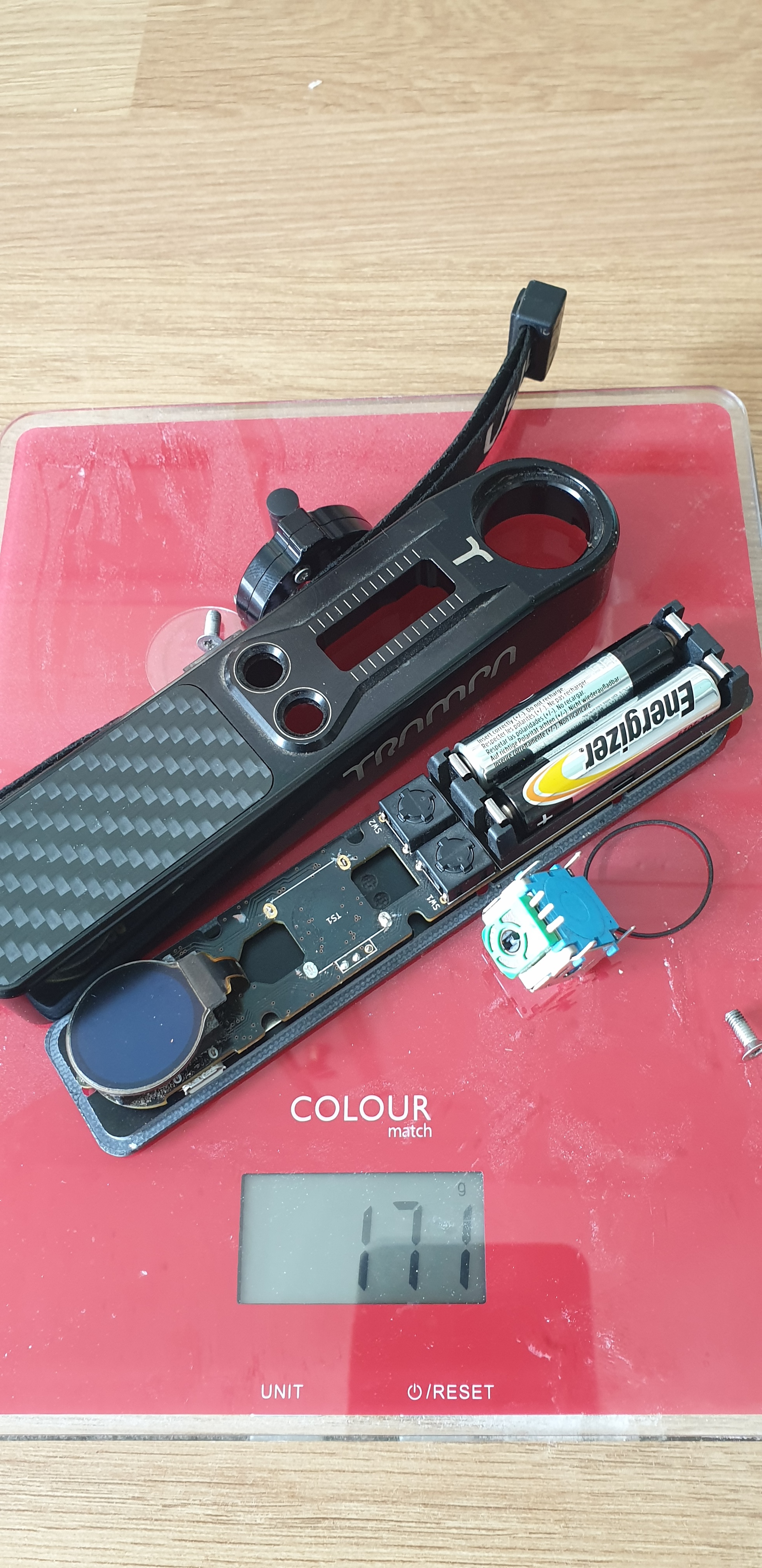

I think we are going to start seeing people with poti issues cropping up. The remote is relatively heavy, and the potentiometer not very beefy or durable. I dropped mine from no more than 20cm from the ground (was putting my heel straps on) and it landed face down and that was that. I was in Belgium with no alternative and had to compete with a broken remote (still came 3rd :stuck_out_tongue_winking_eye:) I have another potentiometer and will fix it but for now I’m back on the VX1.
It’s my only complaint for the whole remote, the rest of it is brilliant. It feels fine, I can be really accurate with it but it’s the weak part and I think there will be issues with it, oh and it’s a pain to change, pcb tracks really close to some of the pads etc.

If it died from that, it is definatly a mechanical issue, if the knob takes force from falling and that force translate into the POT its a poor solution. The force need to be absorbed by something more. Preferably the POT is relieved from stress and the PCB absorbs the hit as it should be more durable.

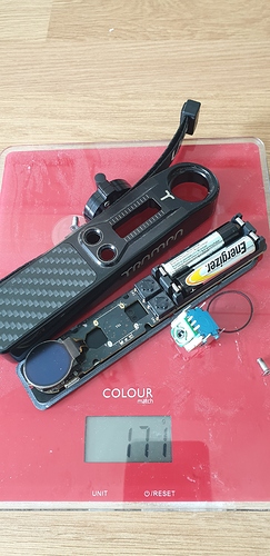

Frank I’m not trying to hate on the wand, I have plenty of good things to say about it. Here is the potentiometer
The wand with batteries weighs 171g
A direct hit to that potentiometer is not gonna be good. I’m just playing with the data I have, owned 4 months? Failed potentiometer once and joystick once.

The green part is the actual potentiometer (a variable resistor of sorts). I thought you meant that was the thing that broke.
IF its the mechanical contraption that is the joystick that is breaking, then that is another issue.
Ah yep you are correct, it’s the mechanical part that broke on mine, the potentiometer seemed to be functional still. Either way you have to change both parts I guess as they come together.
