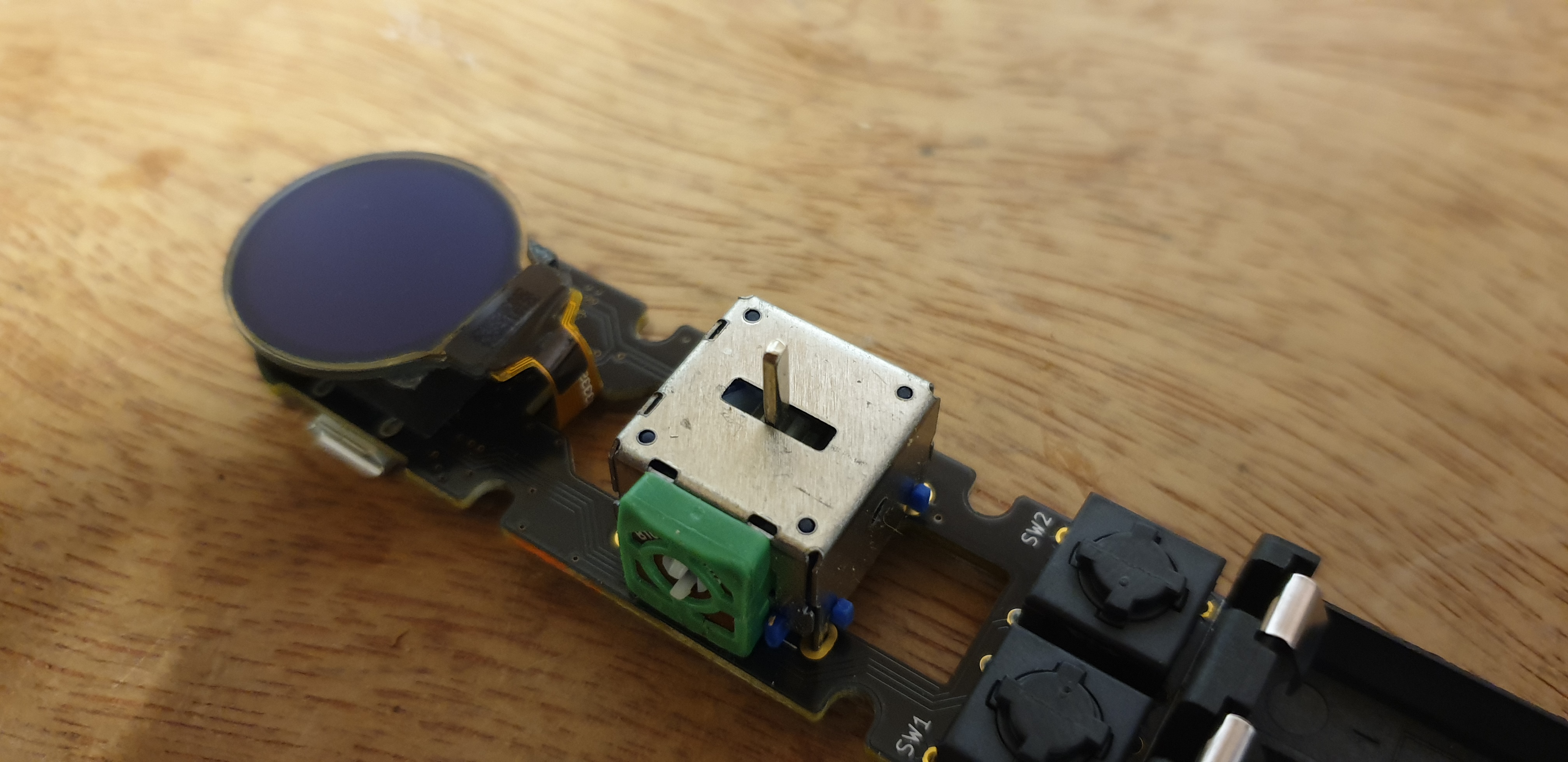

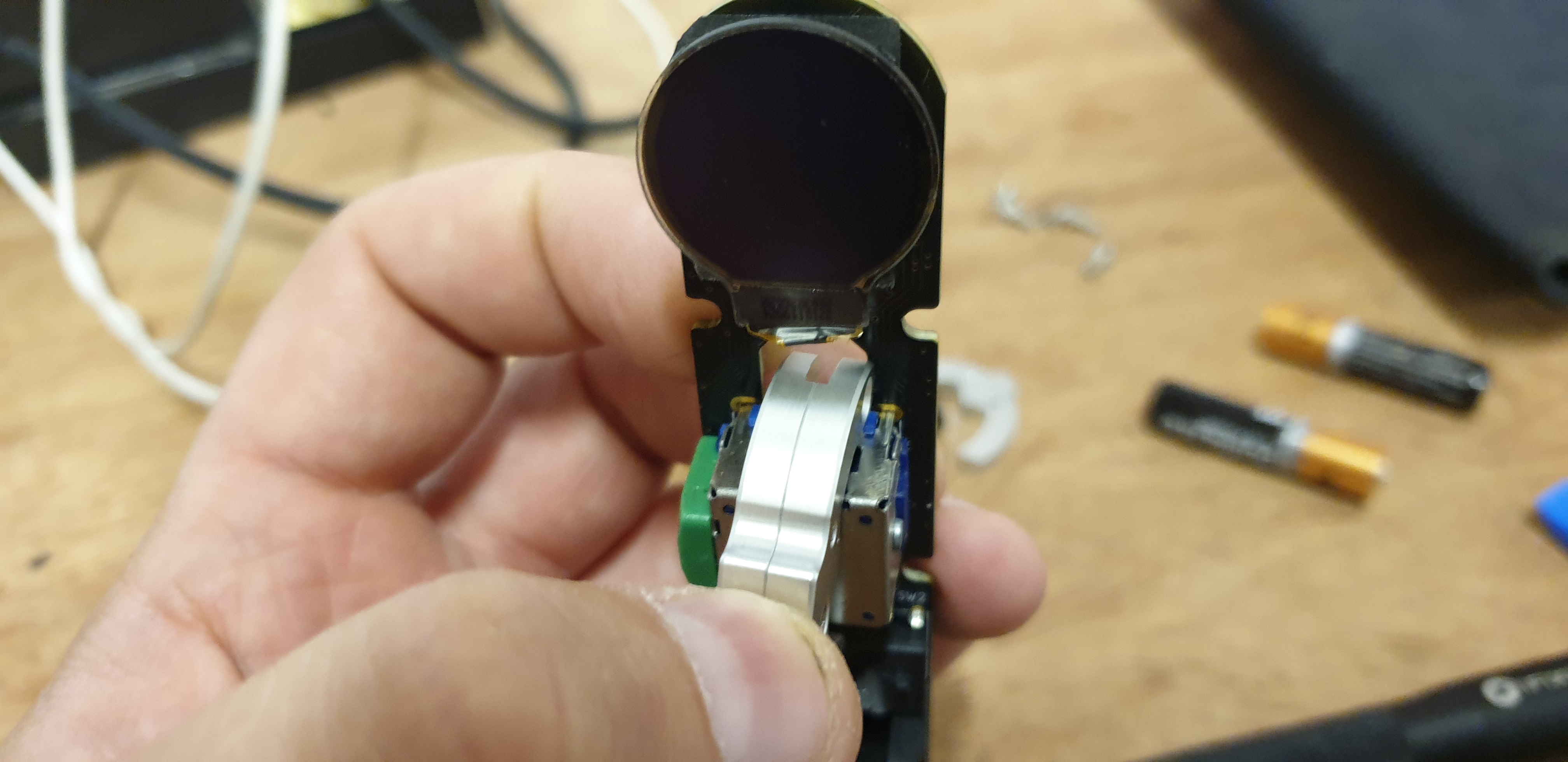

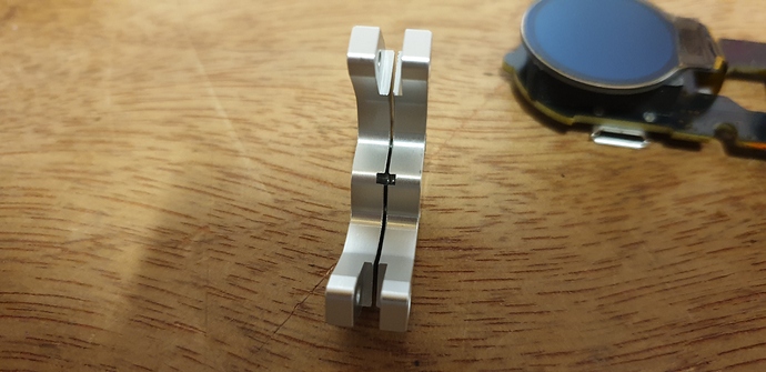

So I’ve had some fun this morning and discovered a few things.
The joystick on the controller is not ideal, this is the shape
And corresponding shape in the thumb peice
Consequently it’s very easy to put it on so its wonky
You can solve it by adjusting the tightness of the screws that hold the thumb peice down, but I cant help but think a there should be a better design in this area. Certainly something to look into @Trampa.

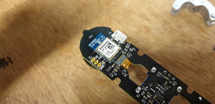

Also note the position of the antenna for the radio, below the OLED. This is no doubt because the remote is a faraday cage except where the OLED is. Still this seems to work great on my remote and I have experianced no problems with my signal strength. I intend to measure the radio on this wand at work with a spectrum analyser when I get chance and compare it to other remotes.
