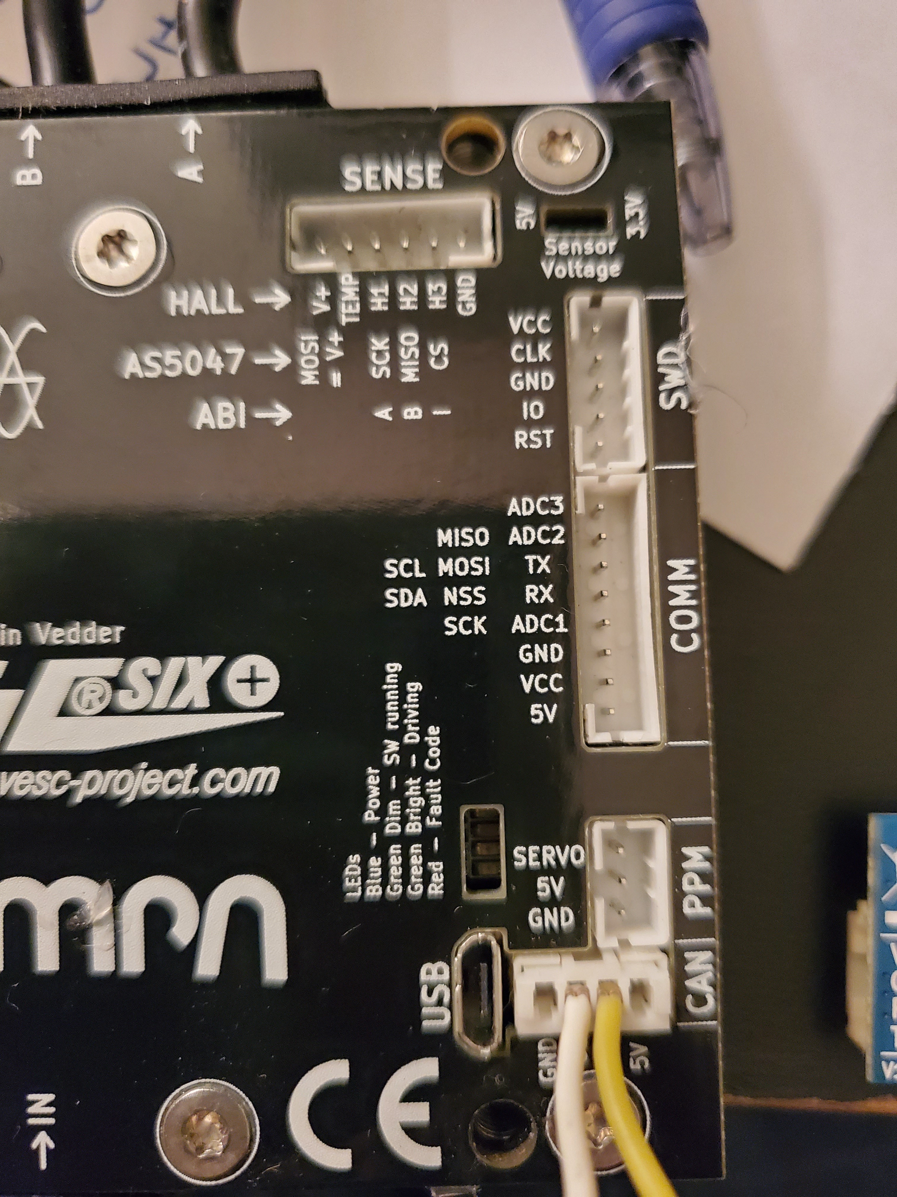

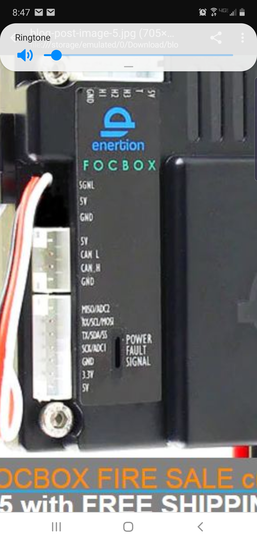

I want to hook up my wand to an enertion focbox single in my Lacroix DSS50. Just double checking that the VCC terminal on the VESC is the same as the 3.3V terminal on the focbox. If anyone can confirm I would appreciate it. Thanks
SWD is only for uploading fw for the dongle. Just connect the dongle to the focbox UART port. You may need to switch your Rx and tx pins. That what I did to my friends single focboxes.

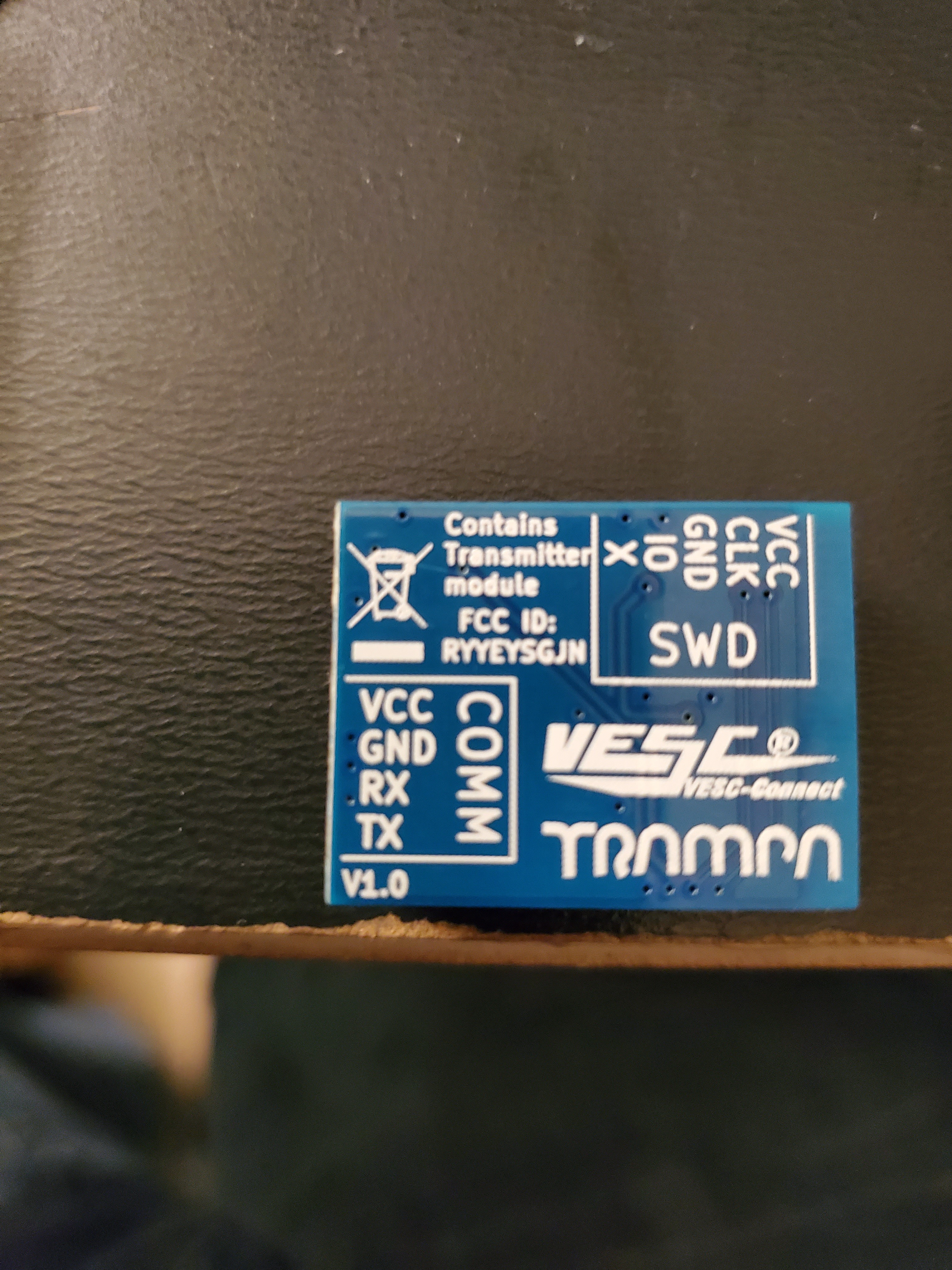

I’m sorry not the SWD port, on the Comm port on my Trampa VESC 6 plus there is a pin labeled VCC, on the same pin on the FOCBOX it’s labeled 3.3v. Just want to be sure these are the same pin. Thanks for the help @pookybear
If you look at the pins, it’s 5v gnd Rx tx. Where do you see the 3v?
Edit I see the 3v now. Look at the back of dongle. You should see the pinouts there. It should be 5v.
Edit 2
No 5v on there. Just VCC like you said. Same as mine.
3.3v is second pin up from the bottom on the focbox and that same pin is labeled VCC on the VESC
If you line up the connector that you received w your wand to the vesc6 comm port, it goes to 5v (red wire). That’s what I have on mine on my Vesc 6 as well as my friends focboxes.
@Trampa should be awake soon.
Thanks @ pookybear, my Trampa connection lines up on VCC, and the dongle has a VCC terminal. I will reach out to @Trampa for clarification. Thanks again for all the help
3.3v = VCC
And just to add to this I have my VCC going to the 3.3V pin on my focbox and it works great
