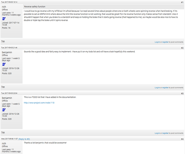

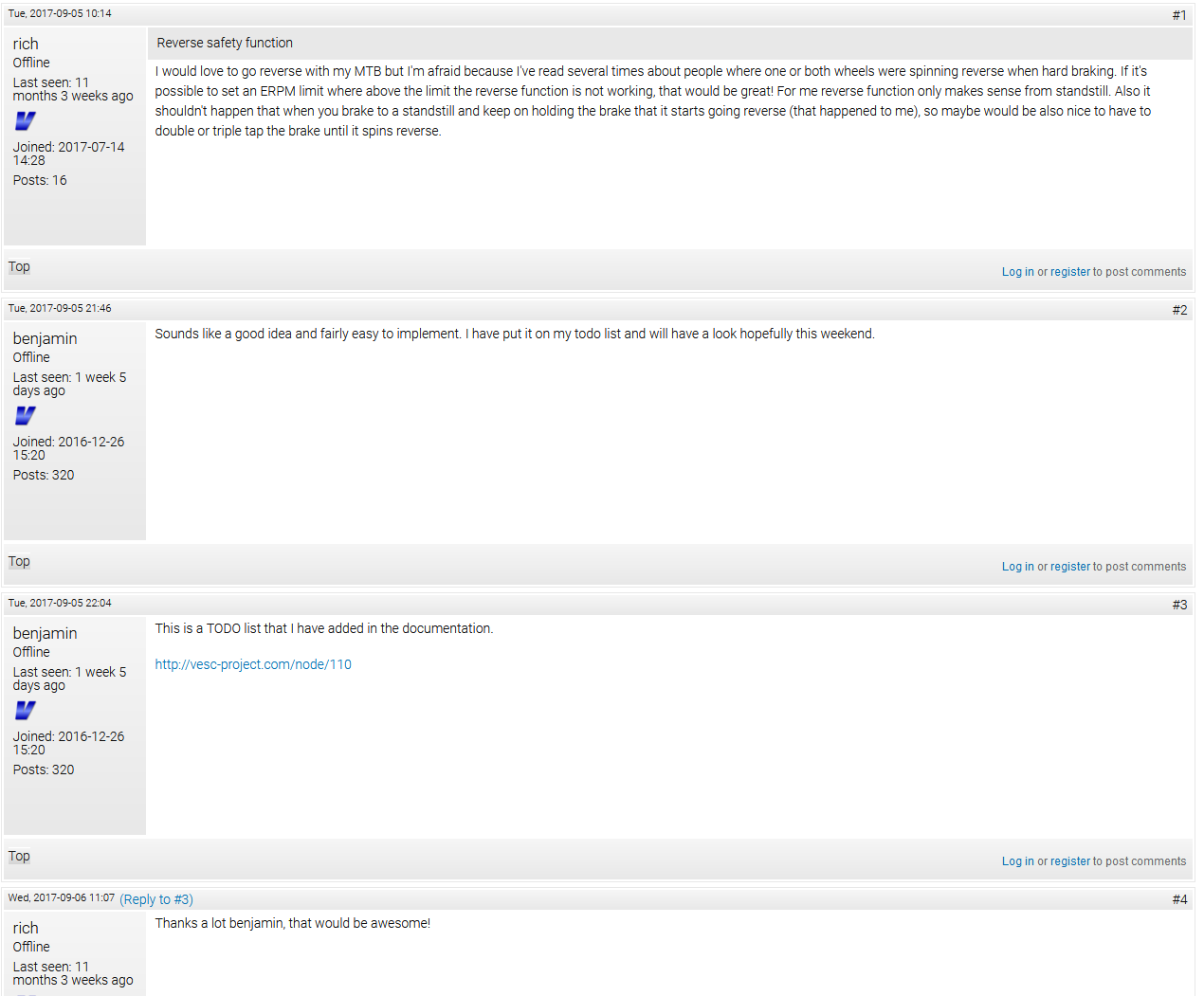

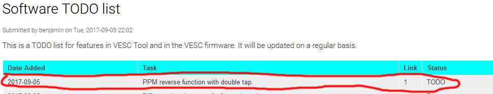

I’ve made an official feature request on the Vesc-Project forum almost 2 years ago :thinking:
It was exactly what @mmaner and many including me want. Setting ERPM limit for direction switch plus double tap for safety. Best would be selectable single, double or triple tap from standstill. I’m just dreaming…
According to Benjamin it’s not difficult to implement
