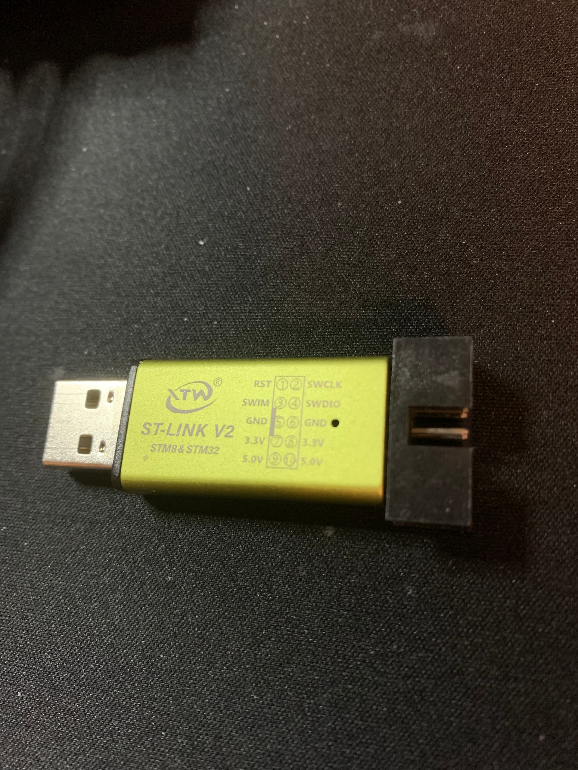

Would probably need an ST-LINK v2 if these don’t work :\

No idea what it is, how it works, or how to use it…but I got one, came with some guys box of skate shit way back when
Oh you have one! You will still need the file above, but follow these instructions
ST-LINK over the SWD port.
  • Download the firmware .bin file for the hardware version you have
  • There is a JST PH 4 pin port. It has GND, DIO, CLK and 3.3v
  • Hook an ST-LINK v2 up to that port. Only use the GND, DIO and CLK pins. Have the battery plugged in. If you cannot plug in to the battery, then use the 3.3v pin as well, but this is not the recommended method.
  • Plug the ST-LINK v2 into the PC
  • Download the STM ST-LINK Utility
  • Open and click Target → Connect.
  • Click Target → Program & Verify
  • Click Browse and load the .bin firmware file.
  • Click Start.
  • Wait 30 seconds then unplug the STLINK and the battery from the ESC. Plug in the ESC to the battery and connect through the normal USB port or bluetooth to configure with the VESC tool or VESC app.

Ope NVM we got v6.00 boys :grin: thank ya for the help
