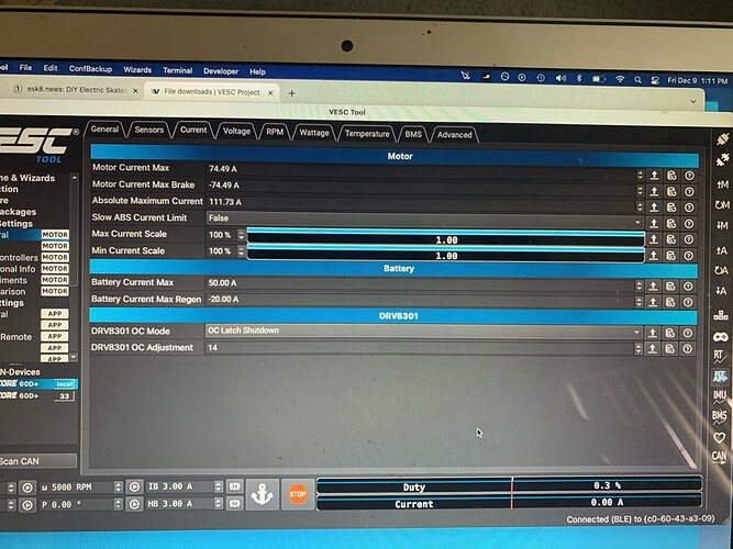

Also worth noting, the 6.0 vesc tool introduced a new way to attempt to kill itā€™s users. Using the FOC wizard, I would always previously get an absolute maximum current of 200a. Firmware 6 set this at 111.73a . My understanding is that setting the absolute max too low will make you hard fault your ESC. If this is rightā€¦ not great. I upped it to 200, but it makes me concerned there are other default values that I should be worried about.

Is there any downside to setting absolute max at 200a? I assume itā€™s a bad wizard value because after detection, when I noticed the 111a setting, I hit read default values and it plugged in 200a. If detection assigns 111a for good reason, Iā€™d love to know.
edit - I misinterpreted your point. I see you probably mean the wizard is optimized for setting things up for a propeller. Yeah makes sense, but the esk8 mode defaults were changed in this case. Maybe itā€™s just me and nobody else will have this issue.
