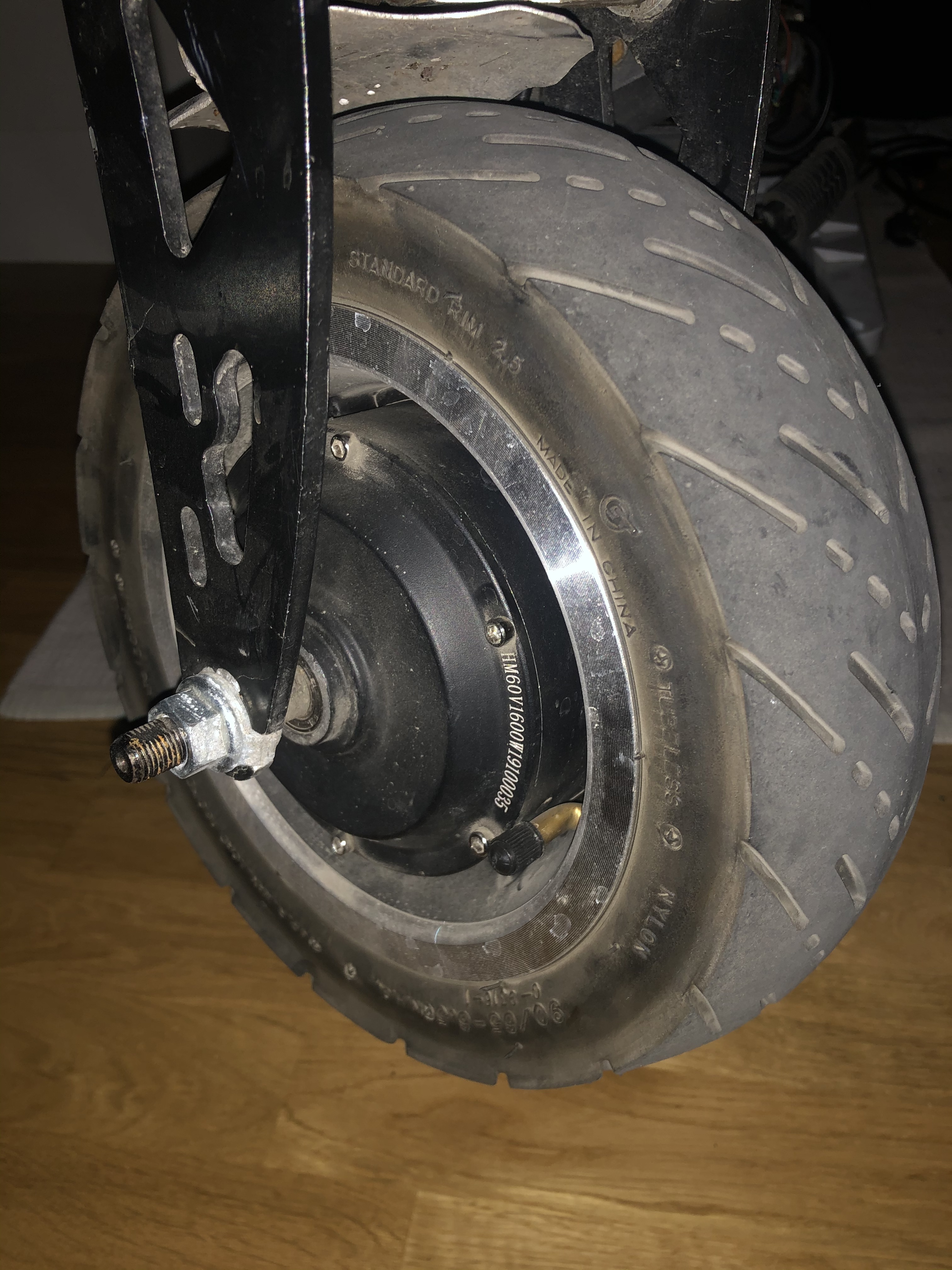

Today I found out how to eliminate the resonance/ vibrations I have had in one of my front hub motor on the scooter. They appear at two places in the rpm span.
I simply set ā€œHigh current sampling modeā€ to TRUE
ā€œEnabling this option will make the current measurement compare all motor currents and derive the highest one from the two lower currentsā€
Is it possible that one of the current amplifiers in my ESC is not feeling well and enable this setting covers for this issue? :thinking:
With BLDC i don’t have these vibrations.
I will see how it works out Tomorrow when I put load on the motor. (The motor have performed like a champion as it was but it would be pretty sweet to get it to run as smooth as the rear motor)

Its the vibrations I wanted to demonstrate anyway :slight_smile: (the noise is not from the motor btw. It’s from the not so amazing front suspension)
Here is how it looks… use your imagination to make it spin :smile:
