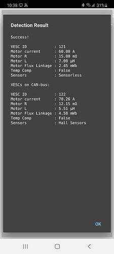

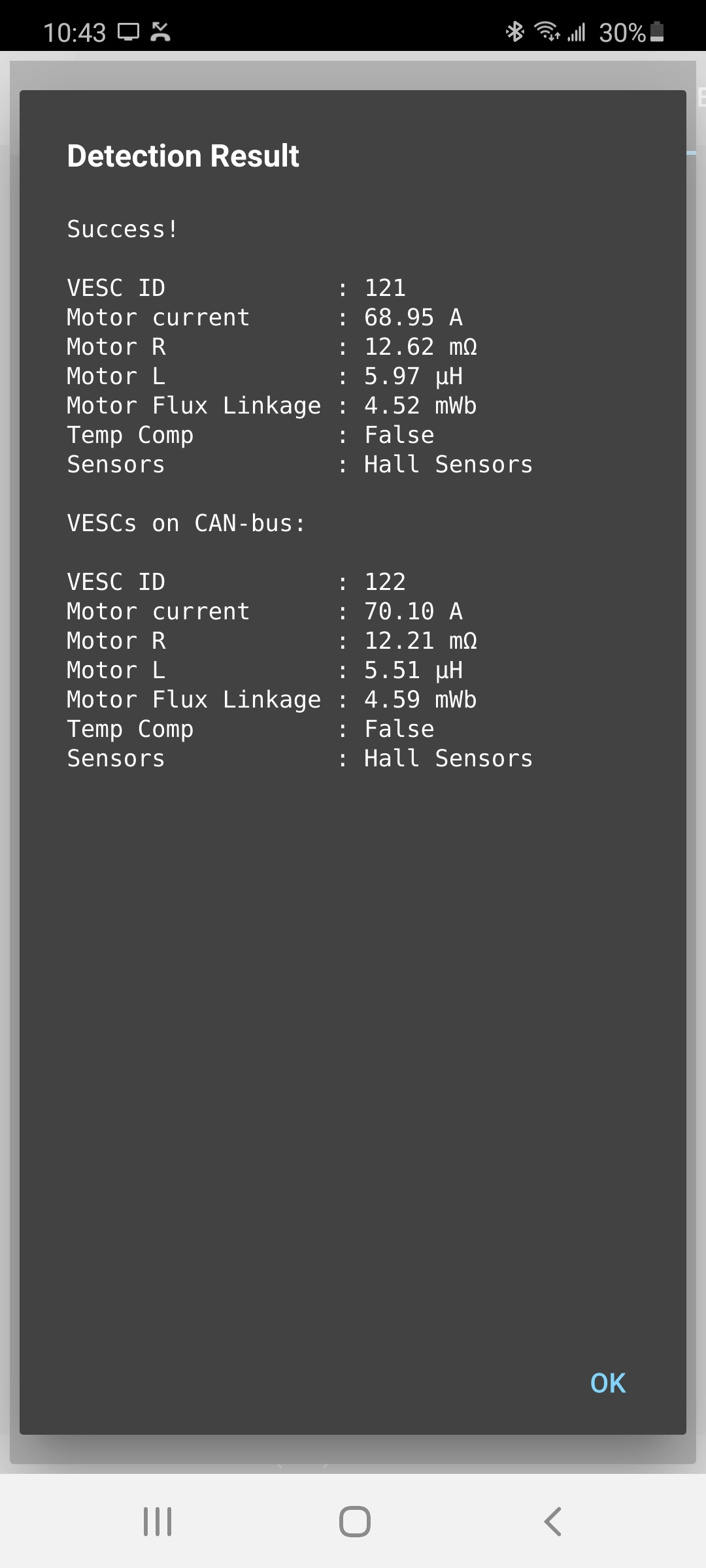

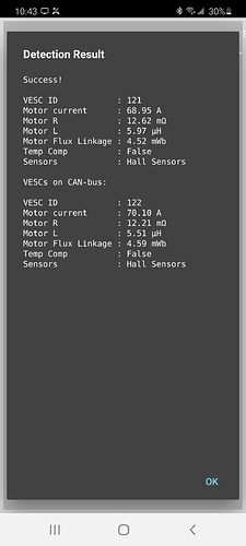

I hooked up an older Unity today and flashed the new firmware with the vesc tool.
I did it using the PC and it was quick and I just worked…

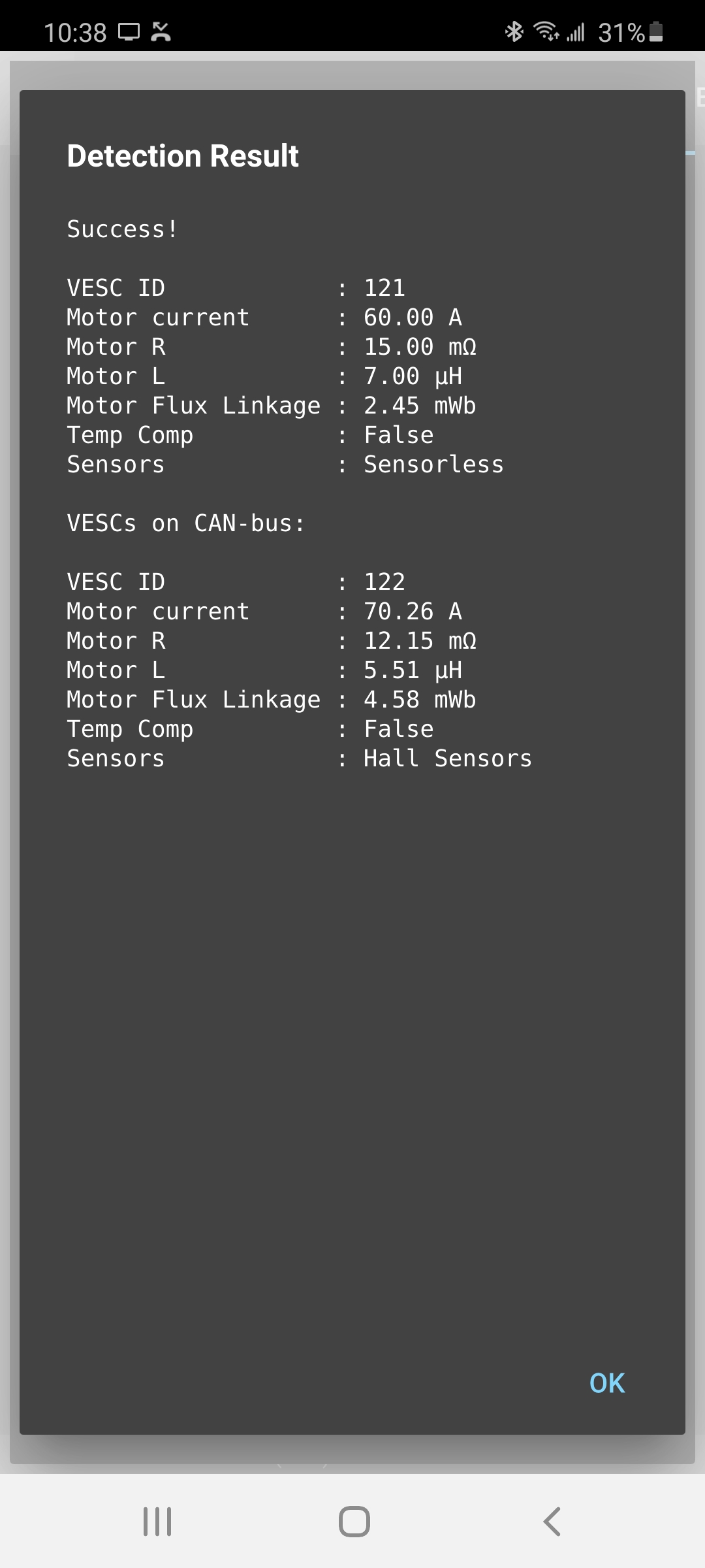

I then unplugged the PC and ran the wizard off my phone like I usually do…
First pass I got some weird different values for the motors and one said unsensored…
So I shook some wires and ran it again and everything seemed normal.
Did ten miles on new build and it all seemed good.
Oh. And push to start is freaking cool.

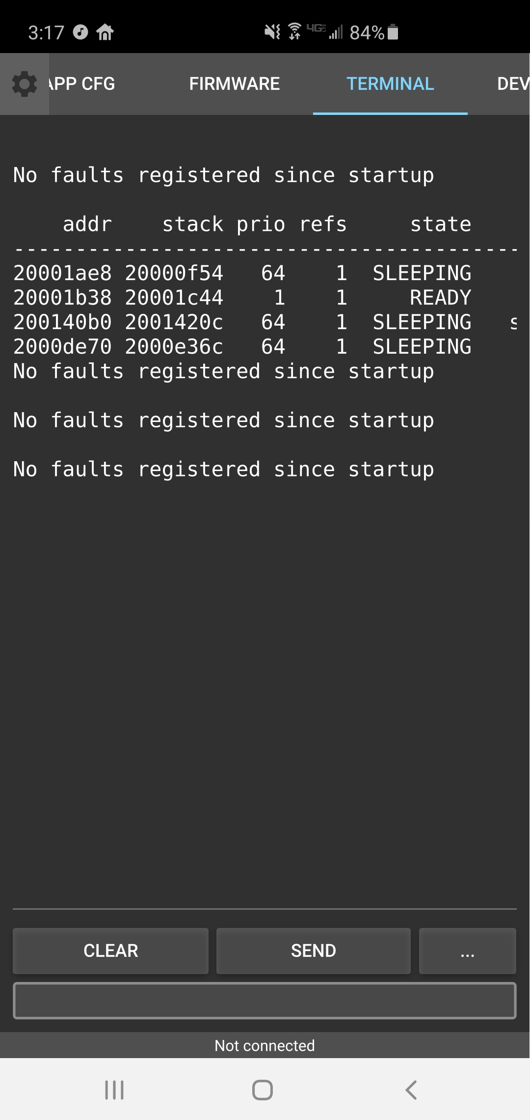

I got up, checked for fault codes and got nothing.
I checked for the other side of the esc and got no faults as well.
I propped the board up and got this result when throttling under no load.
