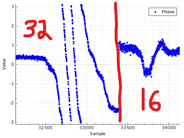

Was just messing with the HFI settings, whats the difference with the HFI samples? On the default of 16 I get whats shown on the right side of the picture and with 32 I get a tighter grouping like on the left. Are there different pros/cons of the sample rates? image
Yes the sample rate is always the same, so when you double the number of samples taken it also doubles the amount of latency in the sample. The algorithm runs a circular buffer where it always updates one of the samples each time step, so you always be 1/2 number samples * sampling frequency delayed from the true motor position. At slow speed this is not a big deal at all
(0.0001 seconds * 8 samples * 1000 ERPM )/ 60 seconds = 0.013 revolutions delay
But if you run 32 and set the transition at a higher ERPM 32 will start causing issues. The tradeoff is you get a bit better resolution, as you see with the decreased variance there. I think the best way to know what works best is just to test.

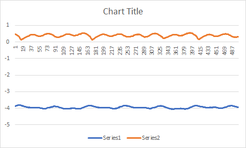

The motor saliency information is embedded somewhere in here right? :thinking:
Any tips on how I can extract it?
Because if so, this may obviate the need to inject such large currents into the motor for HFI.
This waveform persists down to Q axis currents of 5A.
Wait, hold up, this is literally the approximate inductance for every single theta (ratiometrically).
Huh, well I just figured out a way to compute the inductance for every rotor position on the fly. Drive the motor in open-loop, either stall it completely or let it spin. Observe the Q axis waveform. Find inductance at theta = 0 by driving phase A high and phases B and C low. Use graph to determine ratio of inductances to every other rotor position.
The second graph also reveals that the PI current controllers inherently estimate the BEMF. I’ve found that at low currents, the resistance and inductance terms are rather small so errors in them end up being insignificant, so this explains why the VESC can track a motor despite having erroneous resistance and inductance measurements, and why performance degrades at higher currents.
Yes, the measurements are erroneous, two different RCL meters say so.
My official Trampa VESC 6 put a TB 6380 I have on hand as having a phase resistance of 24miliohms, RCL meters and my own controller put it at 21miliohms. VESC estimates a phase inductance of 13uH, RCL meters say 19uH, my controller says 17uH.
Open loop FOC can get up to 14k erpm unloaded, so that’s pretty neat.
Huh, flux linkage is also wrong, VESC says .004901, excel says .0045915, but I guess it’s close enough.

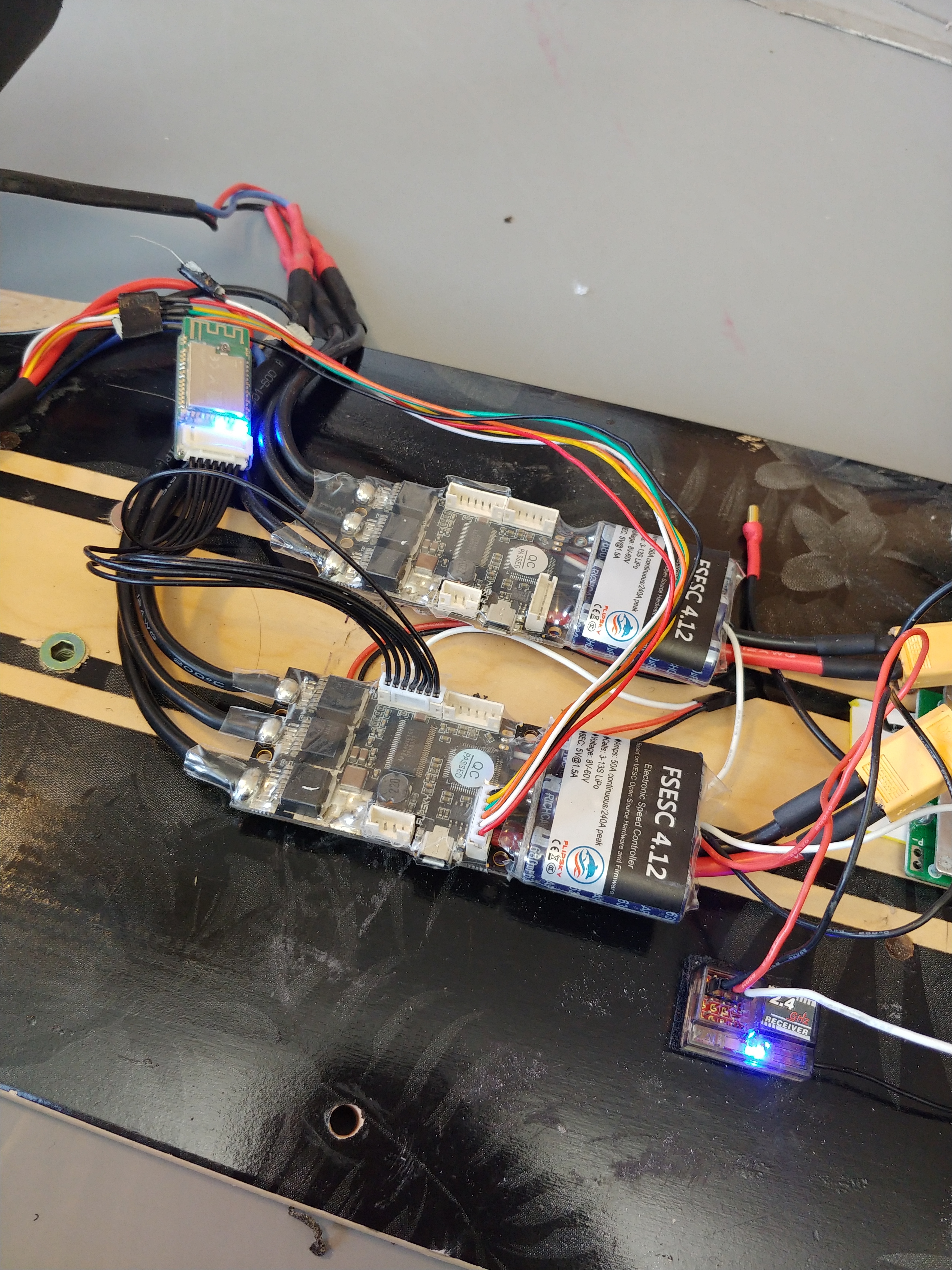

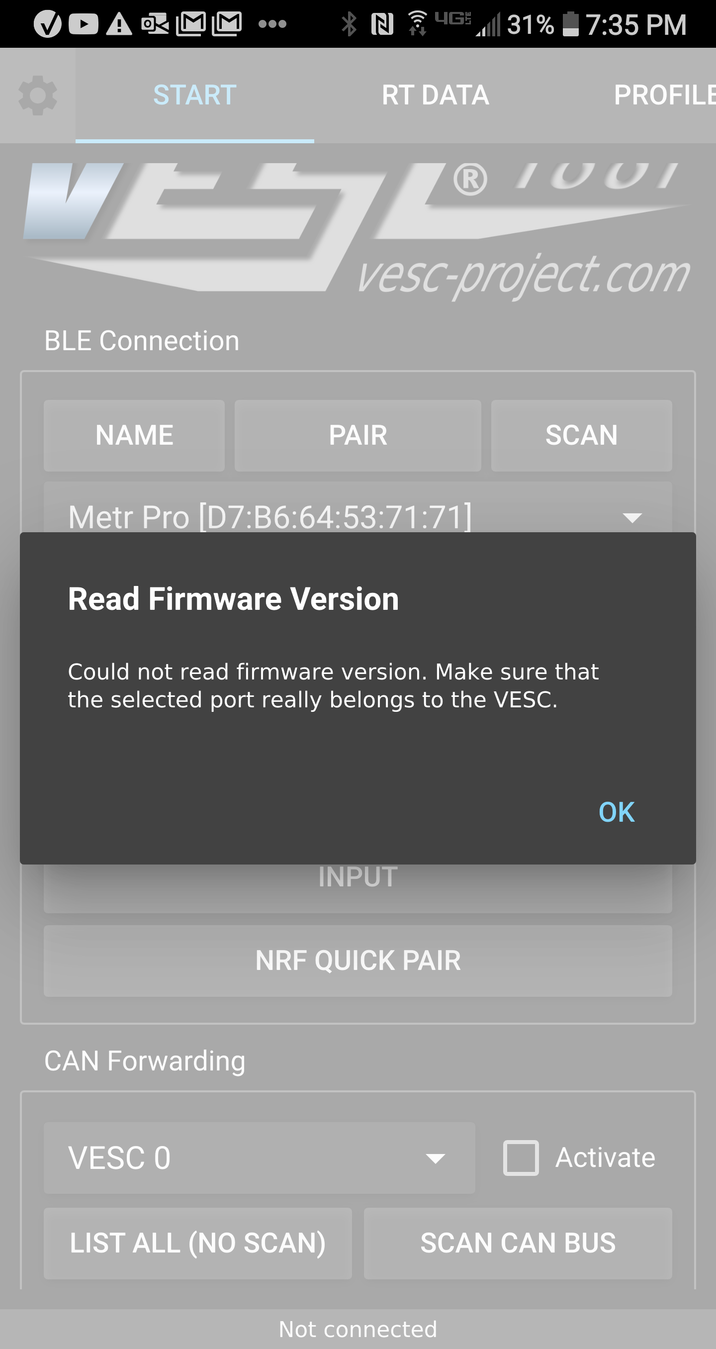

who can gimme a hand with this. I havent used old vesc since i started a few years back and even then I was running dual focboxes solo on split ppm… so A how do i setup canbus nowadays on the new app? and Im a mac user so i cant plug in direct so was using a metr pro to do the setup. 1 vesc connected and updated fine and ran detection, now this is where im at on the 2nd vesc. please advise thanks!
Well… connect the canbus cable first… then from the master vesc (the one with the metr on) most of it just flies automatically after you do the motor detection.
If you want to setup something specific, press scan canbus and then activate. From that point all settings are to and from the vesc on the other end of the canbus cable.
For example: i have my bluetooth module on one side and uart remote on the other. To setup throttle curves i connect to canbus and then modify stuff
so as u see 1 connects, and the other only gives the shown screen and boots me back off. 1 vesc is updated to current firmware now and the other unknown firmware status… are u saying if i connect both with a canbus cable a) it wont fry the other vesc and b) would i be able to update the firmware via canbus? this doesnt sound possible but maybe who knows?
It seems like you have another problem here.
If when trying to connect directly to the esc you get that error, you most likely have a bust esc. Extremely common for flipsky.
One fix attempt is reflashing the bootloader through swd. Just search it on this forum, there’s plenty of cases specific to flipsky.
Or contacting the seller for a refund/replacement
