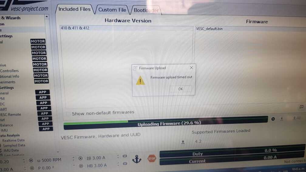

I’m having issues trying to update my Focboxes firmware, it takes almost half and hour and then I get this message:
Can anyone help me figuring out how to solve this?

if going from an old version like ack, need to update to 3.62 or similar first then 4.2

I’m guessing you’re upgrading from an older firmware? I had this issue going from Ack 3.103 to the newest version. But I was able to just let it sit and it did its thing over about 2 or 3 hours lol. The fix is to upgrade to an in between firmware then to the 4.xx I personally went to 3.62 (I think) and then to 4.2 and it was maybe a couple minutes lol.
Some sort of weird glitch with how it’s writing to memory from what I understand.

Yes, I those Focboxes have ackmaniac firmware loaded. I left it upload for like 45 minutes but got that timed out message before 30%, do you suggest you try again and let it sit for 2-3 hours?
no upgrade to 3.xx first using older tool then 4.2

no need for it. Get yourself an older version of the vesc tool and update to it, from then use the latesz vesc tool.
Jumping from Ack to latest vesc tool takes unnecessary hours but from Ack to old vesc - to the latest vesc fw just seconds.
Dudes, gold. This was what happened to me. Much appreciated.
