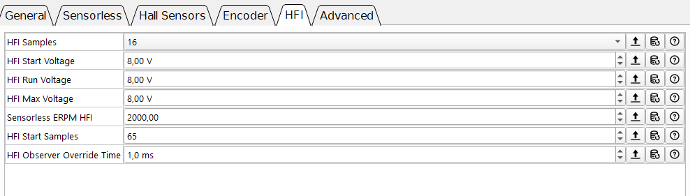

Same issue : he had to increase a lot HFI values and still has cogging.
Are there some guys here who successfully set HFI up with FSESC 6.6 ?
HFI seems to require clean high frequency switching and measurements, so maybe some hardwares can’t meet those requirements? I don’t have tons of spare time right now but we are looking into this a bit. Some people are reporting issues with the new inductance measurement routine which leverages the same algorithm as HFI, and all these complaints seem to be in relation to specific hardware. All the ESCs I have here seem to work fine but I don’t have a lot of the low-budget stuff.
It will be motor dependent and battery dependent. Setting it higher than your battery voltage does nothing for you. If you run measure inductance from the terminal you can see what duty cycle induces what current.
The more duty the more induced ripple current, ripple current generates losses in the ESC and motor so more voltage makes more losses which makes more heat. Lower switching frequency, lower inductance and higher voltage will induce more current and drive losses higher.
The start voltage is only run momentarily so it won’t be a big factor. The other two will dictate more what losses you see. It is also not always true that more voltage equals better signal.

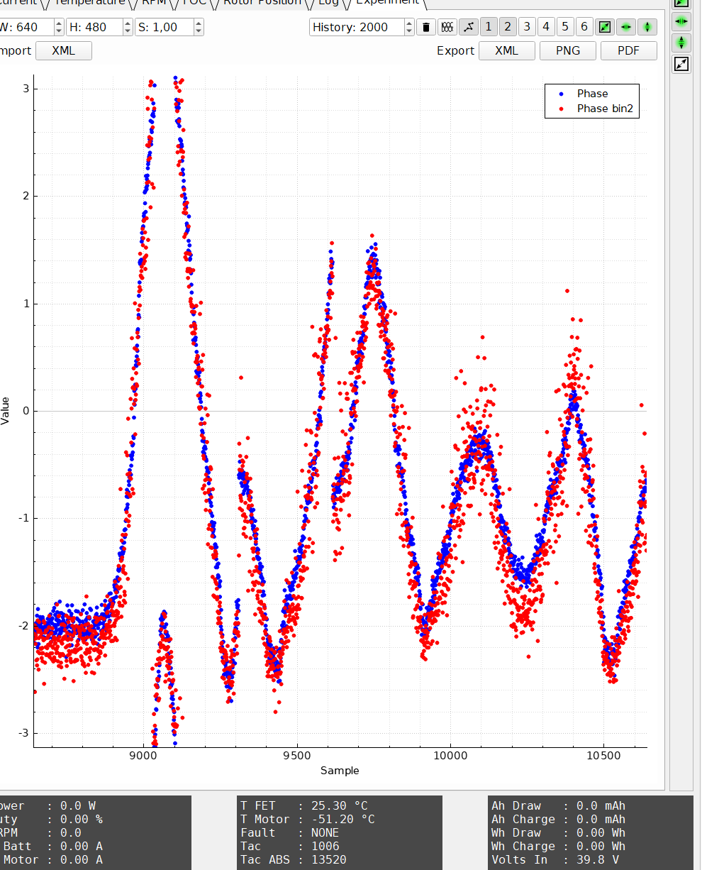

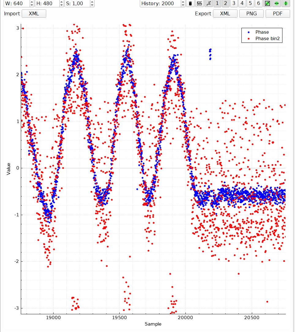

So…after i tried it the last time on February 23rd i once again tried to set HFI up.
i got it to plot (finally) but it does so only for maybe 2 or 3 seconds until it stops. I can hit Full brake again but it still only runs for 2-3 seconds.
Hardware:
Flipsky v6.6 Single
SK3 192kv motor
10s pack
Tool 2.03
FW the latest it lets me install - 4.2

Are you holding the brake on?
i just click once

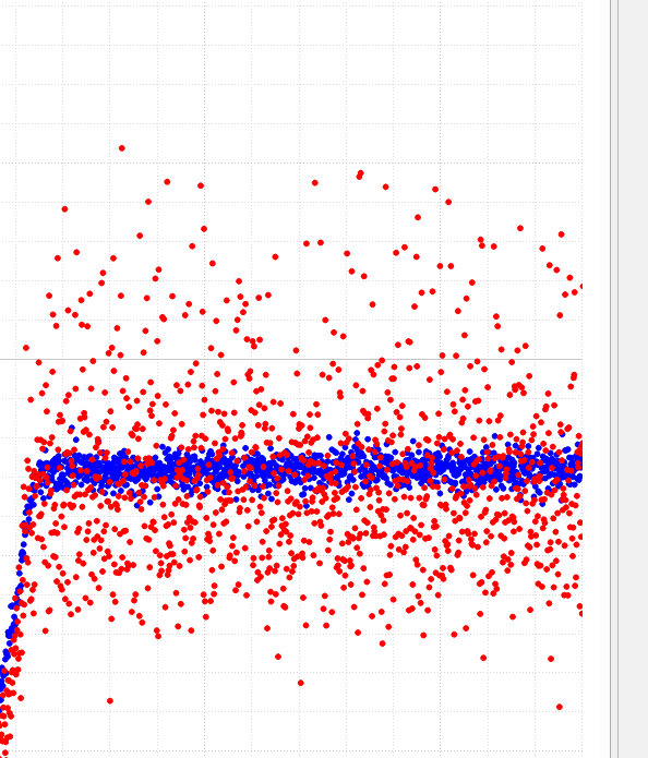

EDIT: this is with 16v each and movement. (i just spammed Full brake so it continued.)
this is the same without movement
Hold the brake with the remote :+1:
oh really? Didn’t Jeffrey say to unplug the PWM cable and set App to None? But hey, if it helps, i’ll try
I had to calibrate without the Rx connected. Otherwise it would just tick once as soon as I clicked the Stop icon, wouldn’t whine continuously like on Jeff’s video.
It seems for the test where you hold the brake, it might be better to do that with a PWM remote.
But when you do the power test, using the arrow keys would definitely be far better.
I did both without the remote, just VESC Tool buttons and arrow keys with Rx disconnected.
the remote trick works.

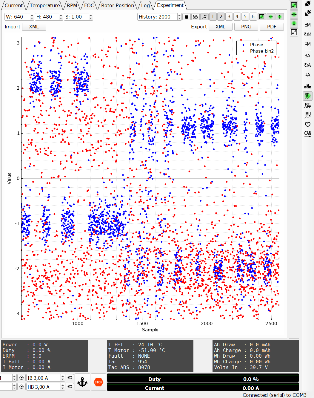

@b264
how does this look to you?
this is
start 20v
run 12v
max 13v
with moving at the beginning and not turning the motor and the end.

If this means anything about low budget stuff I have HFI working perfect on a FSESC 4.20 dual plus but it is with TB6355 190kv motors not SK3s.
Lower the amount of power you’re applying and see if it goes away.
