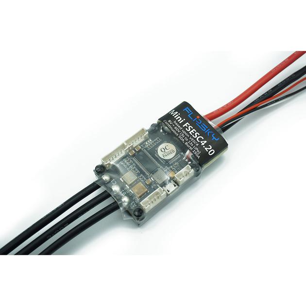

I’m going to jump into this thread since I’m not sure it really merits its own. So my build is using a pair of fsesc 4.20s (NOT the duel one) on ackmaniac firmware. the first one went through the wizards just fine and is working well. The second one has the blue led on and not blinking but it does not connect to the pc, which thinks that it’s not connected.
I don’t see any physical damage to the vesc and everything is properly connected.
Is it possible that I need a boot-loader or something?
It’s possible but if you don’t have an stlink adapter and aren’t interested in programming stm32 chips in general then probably should be mfg issue and get replacement, let them know it was shipped defective/DOA at least maybe they will consider better QC
