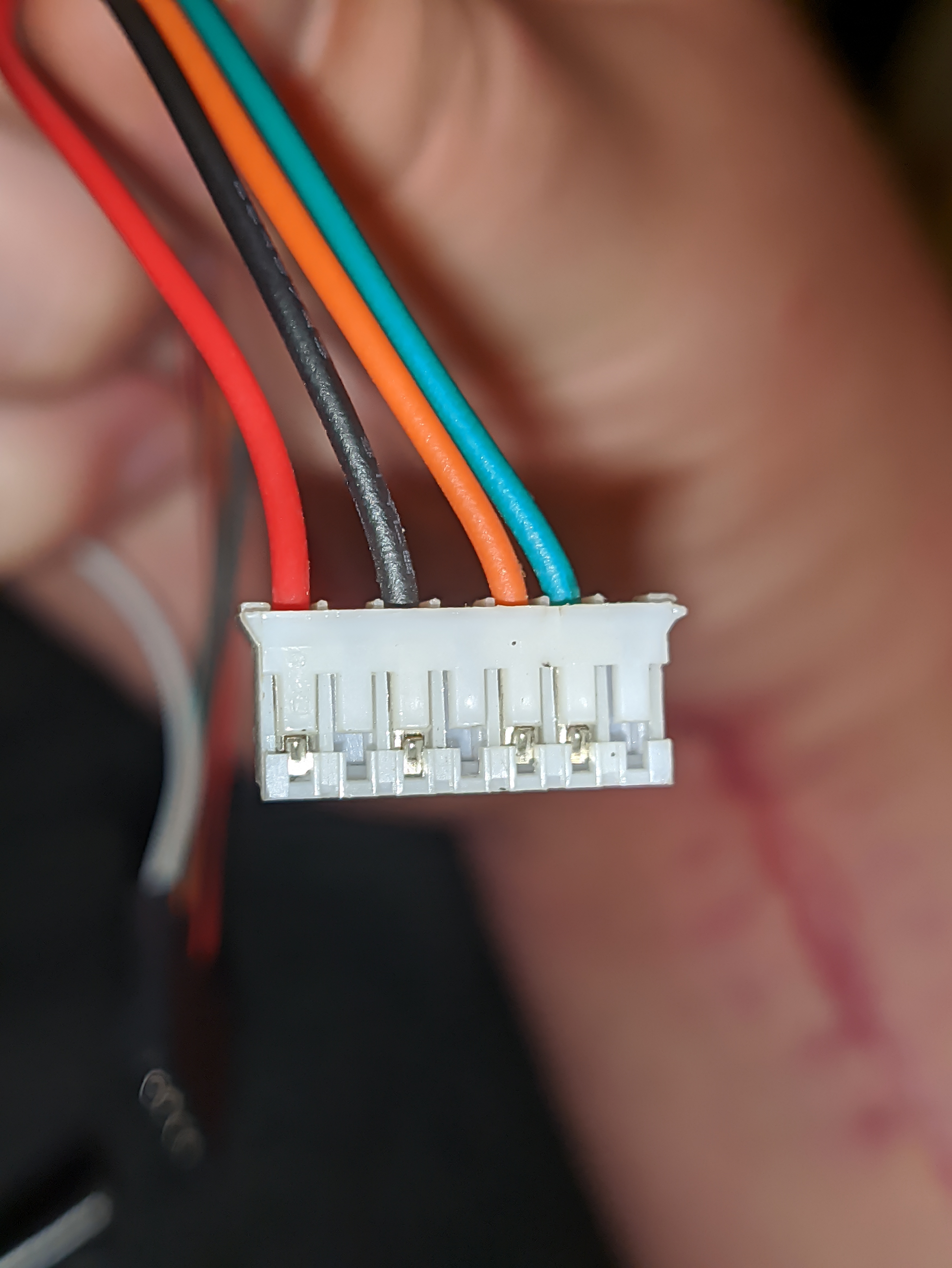

lift the little tab that holds the pins and pull out the wire, just don’t bend it too hard, or else it won’t hold the wires anymore.
worst case: solder wires directly on the pins :joy:
Thanks guys I’ll give it a shot now. Ill lyk how it goes in like 10 mins
TAKE PIX OF CONNECTOR BEFORE YOU FUKK WITH IT
hahaha look above lmao. I’m having a hard time lifting the little plastic buggers. nothing small enough to get under there
razor blade
exactoblade
pin
needle
safety pin opened of course
my rapier like wit
in the video i showed the guy kind of ham-fists it but you get the idea
what i found works the best is to push the wire in to the stops before you pry… it will only move in the JST an RCH but it matters
the lift the tab
then pull
if you start out by pulling the wire it will be super difficult to lift the plastic tab
you only need to lift the tab about .5mm and the wire will slide out
remember which way the wire and the pin come out they must go in the same way to have the tab retain the pin
holy shit i got it with a push pin. razor blade didnt work fsr. Im testing it now…
haha i didn’t see this but it is what I wound up doing :smiley:
those little pin thing that comes with a phone for pushing the sim tray out works easily, or even just a paper clip also works

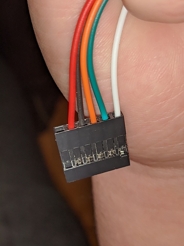

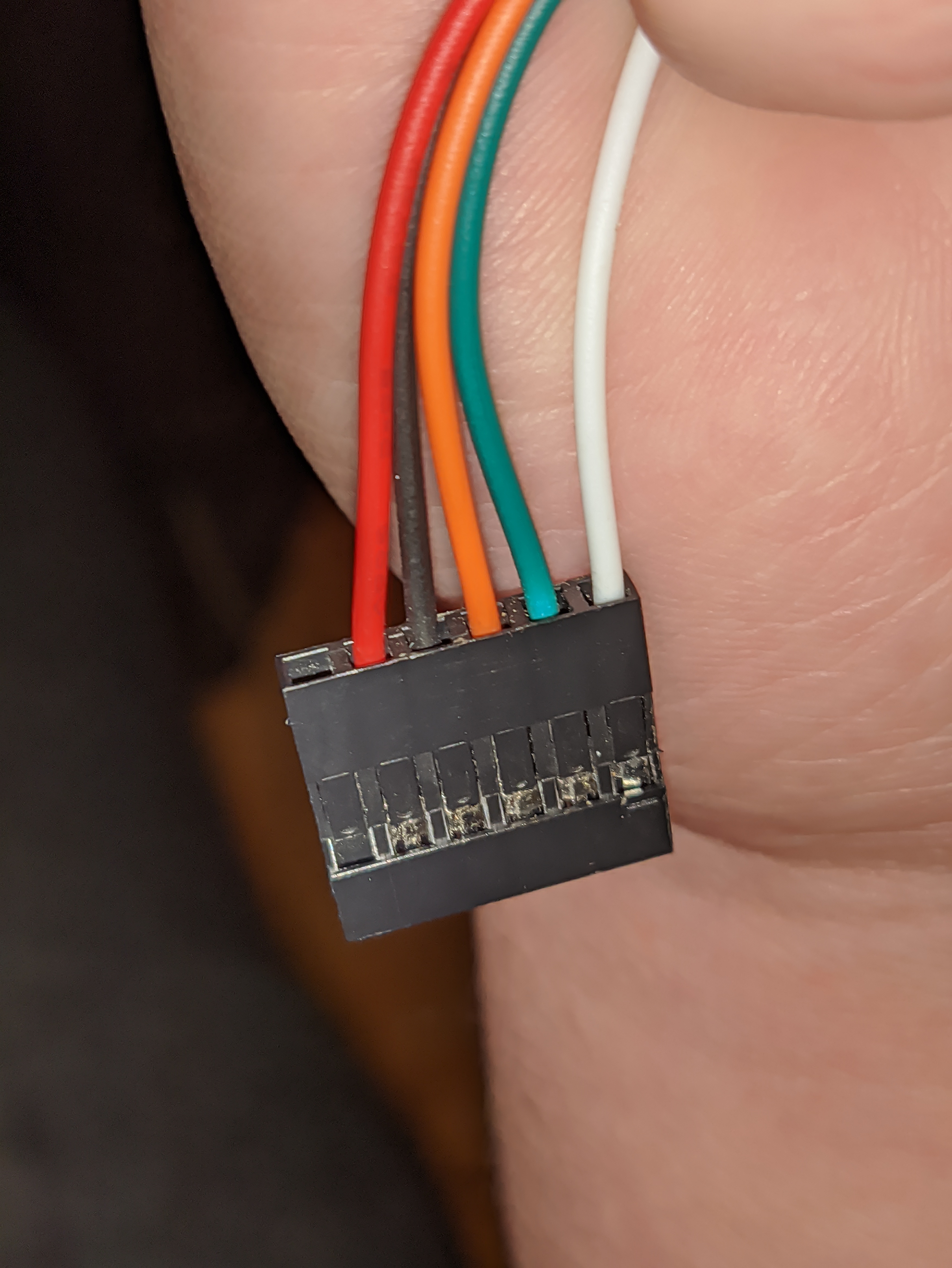

Let me get a pic of the uart layout either way (I’m also using 4.12 hw.
I’m sorry what do you mean by UART layout?
As in the order of pins. Depending on what Hardware you use, you might have to swap 2 pins to get it working.
this is for hw 4.x
