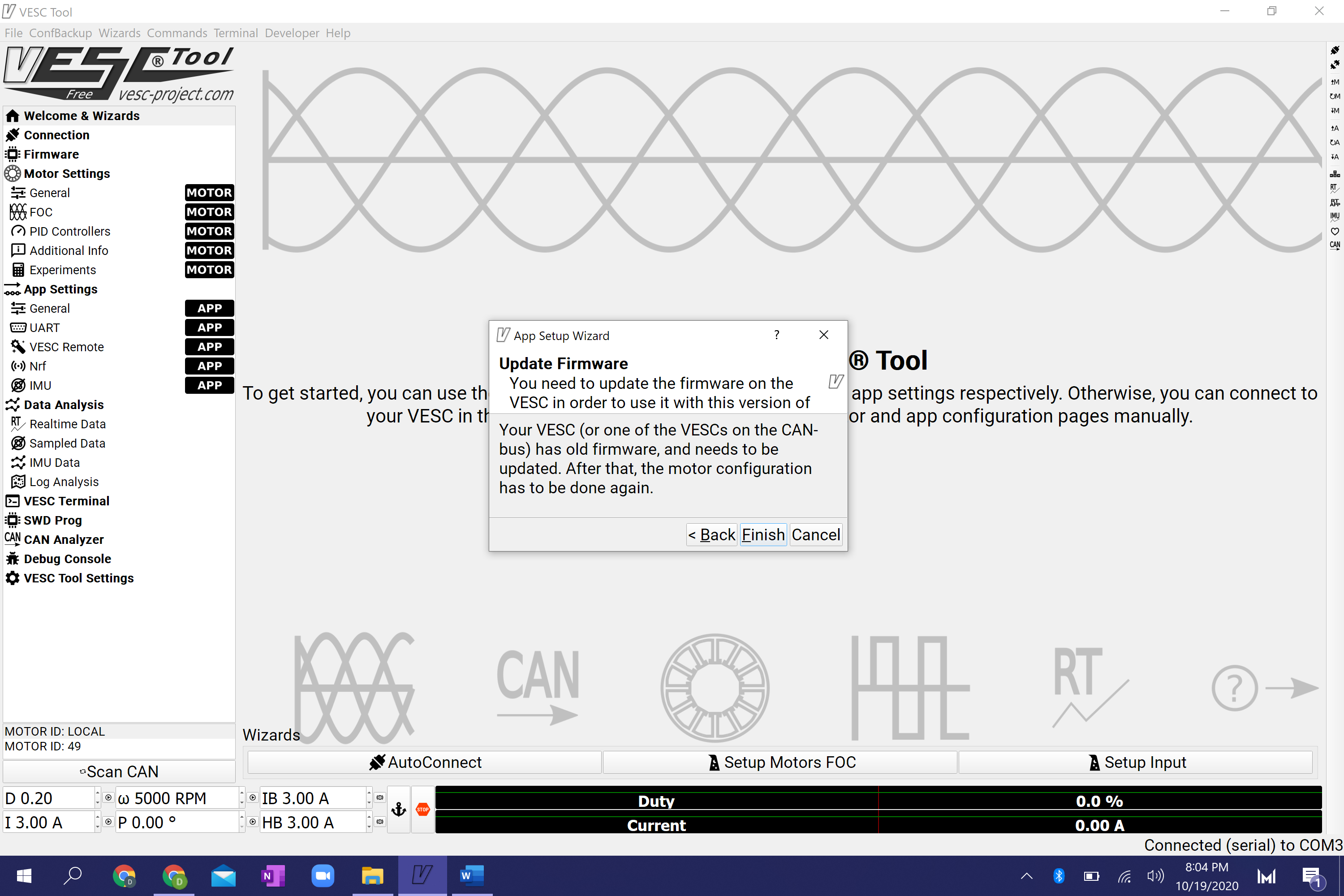

VESC "one vesc is out of date" but both updated to 5.1. HELP??!!
This is the error message I get when trying to set up my flipsky VX1 in the controller wizard. I’m totaly stuck because when I try and set the remote up by connecting to just one vesc, It will not read out my ppm mapping. Please help im just getting back into DIY ESK8 after a year and i really want to get riding again.

So you’ve updated the firmware on each esc, separately or connected via CAN?
restarted both?
Single esc, not connected to anything but the ppm (pwm) cable yields no readout?
I tried to update them together over CAM but it just kept timing out so I updated them separately. I used the latest version of the VESC tool (downloaded tonight and deleted all previous versions). They are both on 5.1 and have both been disconnected from power (after waiting 15-20s after update for safety).
PPM gives no readout, but my remote is connected via UART because it is a flipsky VX1. the Connection looks exactly like this:
ppm not giving any readings is normal then.
Did you set the vesc tool to UART instead of ppm? [app settings - General - top option.
uart does not need to be programmed like ppm
Okay so I double checked that it was in UART mode and it was which is cool. Still nothing. I decided to connect it via the PPM cable that i had laying around (thank god i have it im at college lmao) and I seem to be able to use it to get a PPM readout. Imma try and use the same values (start end and center) for the UART setup and hope it works. I doubt it will (wants to see a readout to let you accept settings) so I might just accept that I’m stuck without the extra reverse function :frowning: . Either way I will still have battery percentage and I was considering having boosted style controls anyway so wth why not.

had the same issue, used PWM ever since. VX1 and focbox.

which vesc u using? TBV6? or flipsky 6.6?
if TB, then yes u need to
if flipsky, then no
I’m using a Torque V4.12. I’ve had these for years now lmao
I plan on getting a FOCBOX or similar soon
V4 hardware vs. V6 hardware requires switching RX and TX pins
Okay just to be clear the V4 needs flipping as well?

the RX and the TX pins are in reversed locations from HW4 to HW6

RX should go to TX in the real world.
what HW version is your remote configured to?

and you’re attempting to connect to HW4 vesc
what I’d do is swap the two pins and check if it works
if you only swap RX and TX you won’t burn anything up

but yes, flip the pins and see if it works, it won’t burn anything down if only those two are swapped
Edit: vx1 remote has no different config, the same remote works for all ppm / v4 and v6, just the receiver pin adapter is different, even the receiver is the same :crazy_face:

look at these two pin outs:
HW6
HW4
read both pinouts from the VCC or 3.3v pin
VCC
GROUND
ADC1
RX
TX
VCC
GROUND
ADC
TX
RX
I specifically chose the V4 remote and I have the V4 hardware vesc. how would i go about flipping the pins?
one side of the JST has a little plastic flap, gently pry that up slightly with an exacto blade and gently tug the wire it will come free of the JST
do the other one reverse wires and slide them in
easy peasy but if you ham-fist it and break off the plastic tab it’s not desirable
