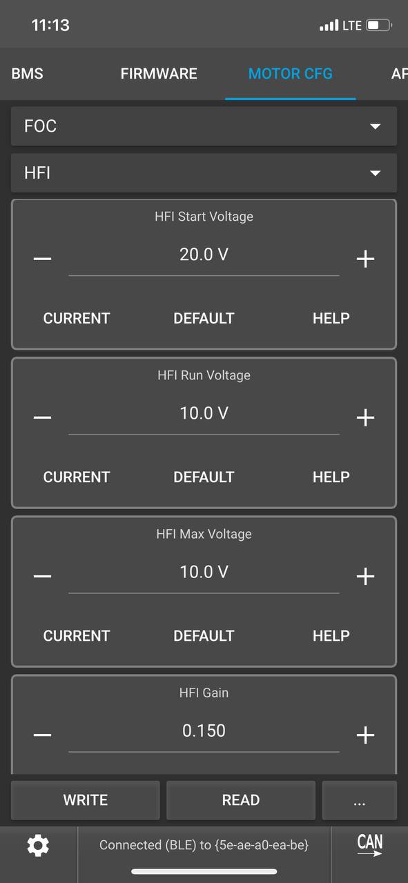

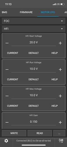

In my experience, sHFI performs better than sensors, but you need to take the time to dial in the settings.
Start by increasing the start and run voltage by a few volts, and decrease HFI gain to 0.1 or 0.15.
Try those changes and you’ll likely see flawless sHFI performance.

ok after some testing here are some good values for my BioX ESC doing the new 6495 motors: (only listing the ones I changed from defaults)
HFI Gain: 0.100
HFI Run Voltage: 7V (slightly better than 6v in my case, the 4V default is jerky a.f. here)
HFI Max Voltage 8V (only increased this as it felt it had to be higher than run voltage, no idea if it has to be changed proportionally to run voltage)

Yes, I’m not joking when I say it’s better than sensors. My board is flawless on sHFI 45.
Push the voltages up. Use my settings below. I’ll bet it gets better for you.

Did you use the settings that I recommended above, or were you using default vesc settings?
Post screenshots of your motor detection settings (L and R and Ld-Lq and λ) and your HFI settings, and what Sensor Mode you are using.
And then again for the other motor, if you have more than one motor. (So 6 screenshots for two motors)
