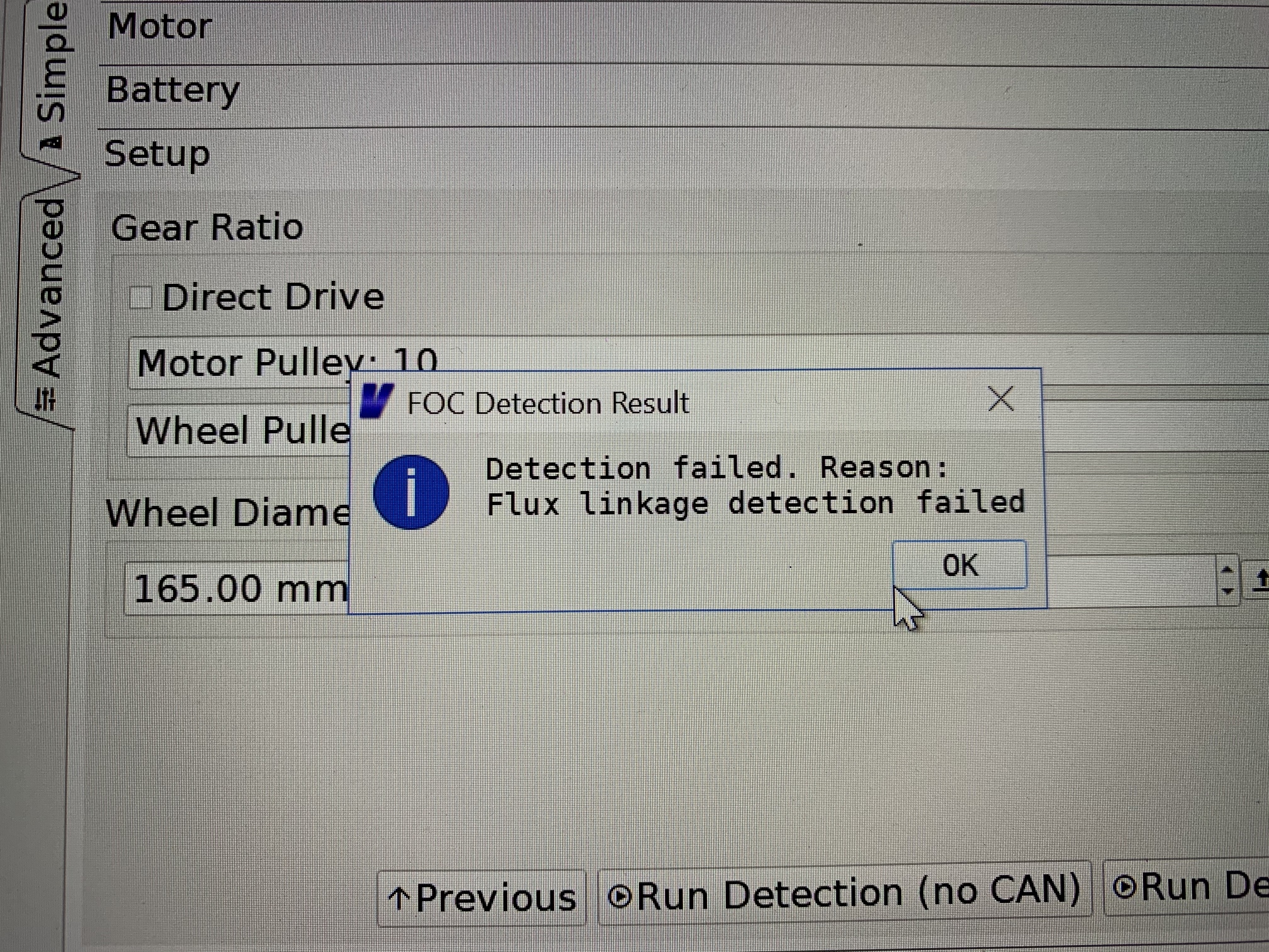

What does this mean? The one motor doesn’t spin up at all. New motor time? Fuck! What else?!
Flux linkage is the linking of the magnetic field with the conductors of a coil when the magnetic field passes through the loops of the coil, expressed as a value.
Check your connectors, bullet connectors, solder joints, if you are using sensors che the are connected…It a reading (detecting) issue…Do not think you have a motor problem yet…Also do FW update and detection individualy…

I’ll check it out, hoping it’s some bad solder joints though, easy way to test would be swap my motor phase leads around.

Turned out to be two cold solder joints in my phase lead connectors. From back when I didn’t know the difference.

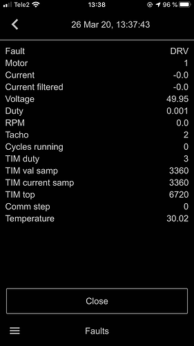

Just got DRV error while charging for about 20 minutes. Unexpected🤓
Is it a HW6 ?
If so, IIRC, you can request DRV_FAULT details from de DRV8301.
Could be interesting to know what internal error triggered it.
