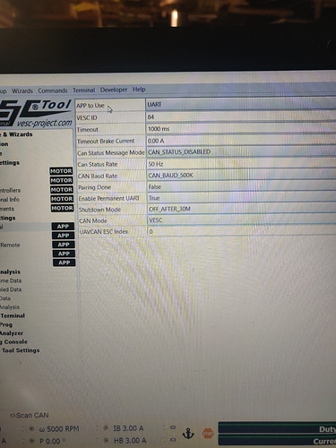

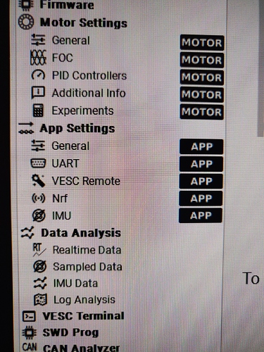

Is it just me or this last release has no PPM tab under APP.
Edit:
Nm. Had to switch app to use to PPM.
