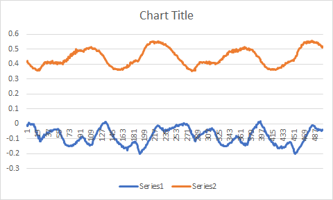

Is this the 360° excitation you are referring too?
My 15-19uH measurement corresponds to about sample number 19, meaning it is the lowest inductance. Orange line corresponds to proportional inductance as a function of rotor position. This does not explain why the number measured by the VESC is so low. From my understanding, you need a baseline measurement for this strategy. Every application note I read says to determine this value using the first and second time constants of the step response by driving phase A positive, phase B ground, phase C floating, unless there’s some formula I am missing and the stator inductance information is right in front of me and I am just not seeing it.
If you paid attention to my post, I said the motor’s line to line (from the bullets) resistance was 37.5 miliohms, which is a phase resistance of 18.75miliohms. The 21 miliohms was the resistance I measured using my own power stage. In your words, the measurement from my power stage appears to be “dead on”, and the VESC is off by an additional 3 miliohms per phase.
Now why is this important? Looking at the equations in the observer, deviations in the estimated resistance and inductance, multiplied by current, will appear in the flux linkage estimation. This in effect introduces cross-talk between the current waveform and the estimated BEMF waveform, resulting in a phase shift of the estimated flux linkages proportional to the ratio of current, the R & L deviations, and the actual BEMF. This phase shift alters the angle between the rotor and the magnetic field so that it is no longer 90° and in effect reduces the torque generation efficiency as the cross product is no longer 1. At low currents or high BEMF, this shift is small, but at high currents and low BEMF, this phase shift becomes significant.

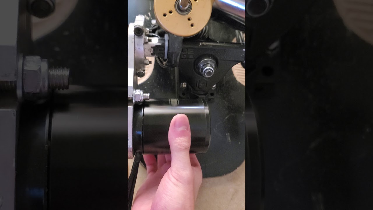

Here is a video demonstrating the performance of the observer during and after repeated stalls, using the values that I measured. It appears to be able to restart from stall condition, there is full torque generation down to about 1 mechanical RPM (although this is not clear in the video). There is no open loop or sensored intermediate, it directly polls the flux linkages from the observer. There is a 100% pulsed d axis current injection at 60hz and 50% duty cycle when the ERPM is below 1000.
It also accomplishes this at 30A. Going to dyno test this in the next week or two.
Also worth mentioning that if I use the values that the VESC detects, the observer utterly fails to track until a rather high open loop speed.
