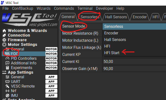

MK V is fully A.S.S capable. Using the new BETA VESC-Tool, your motor is detected as sensorless when no sensors are found and it will set it to HFI-Start when the HW supports it.
HFI-Start is a combination of a tiny zero current HFI bleep and Advanced Sensorless Startup.
You can double check if the setup is correct by looking at the FOC sensorless settings.
This method works really well on all salient motors. Some motors are non salient and the startup without sensors will therefore not work.
