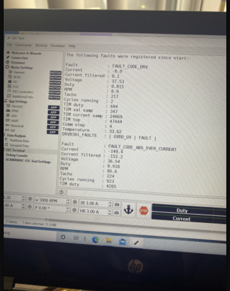

Yo so long story short, I built up my haha and the Vesc 6+ I got went poof for no apparent reason. All solder points on my motor are good and the wiring in the board as well. I’m using a makerx anti spark and I’m only running 50a to a single motor. I was just casually riding home from a group ride and the board threw me off at about 25mph. Motor locked up and I went flying. Motor then went to making a odd knocking noise and when I opened the board to investigate today, there where no visible signs of what’s wrong. Went to reprogram thinking I made a mistake with the Vesc settings but I didn’t. What’s up @Trampa Here’s my settings
Motor max 50a
Motor min -40
Battery max 50
Battery min -20
Battery is a 10s4p molicel p42a
There’s absolutely no way this was my fault or doing, battery was at 85% when it went poof while riding. I want a explanation because there’s no way I messed up.
Check the mosfets if they blew? Also, were all the phase wires fully plugged in when you opened the enclosure?
This doesn’t sound like something you did though, sounds like a faulty Vesc.
Wait can you redetect with 10a instead of 5a?
Everything was plugged in all nice, nothing loose
Not really sure wym lol
Ok so go to bldc detection screen to redetect using the wizard

Just had a thought. The lid for the haya is aluminum. Did maybe some part of the vesc hit or do you have something insulating it? Not sure if that could even cause a drv fault…
I have a little sheet of foam between the lid and the vesc
How was the foam secured?
