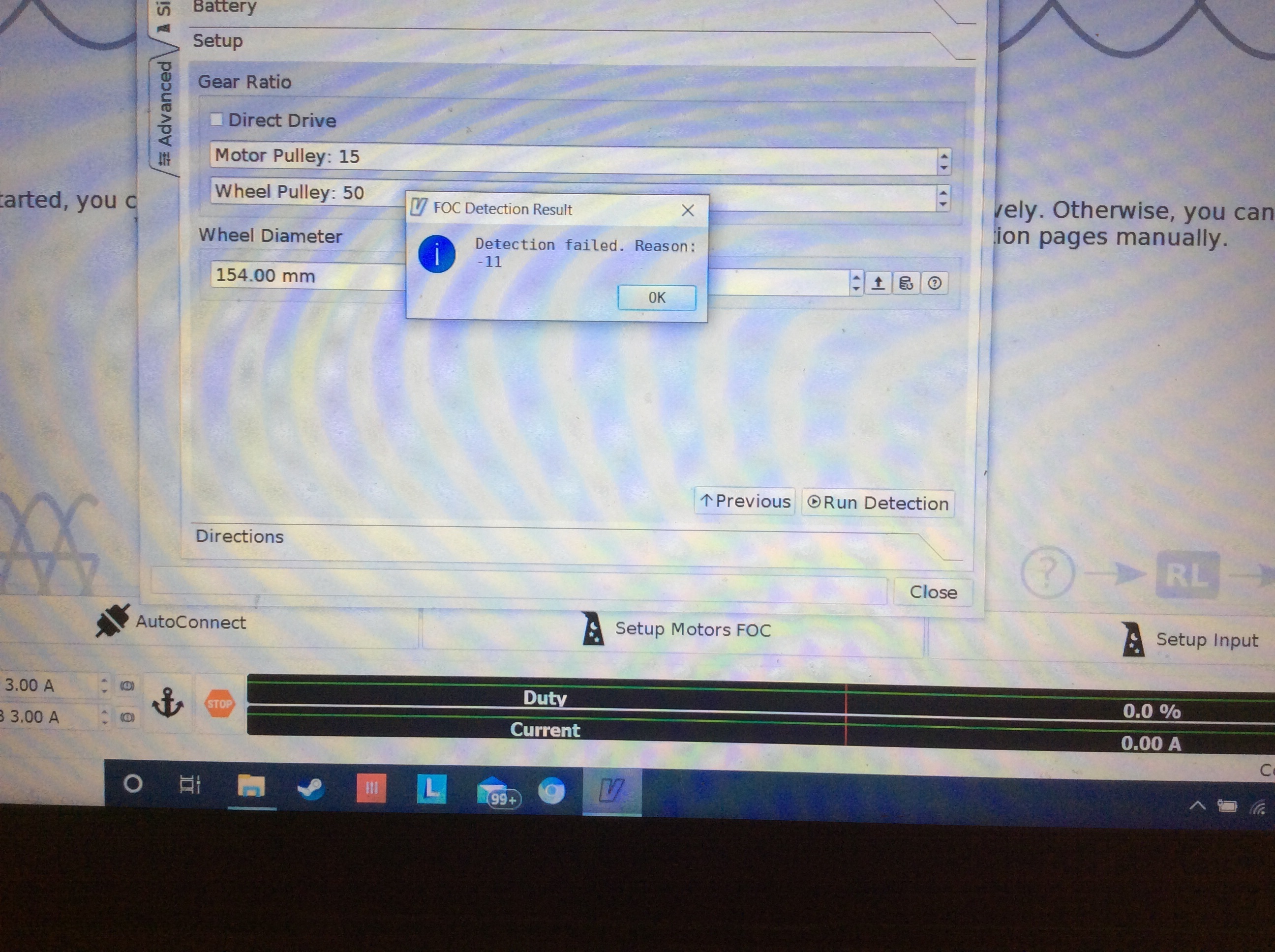

Tried doing foc on the motors and I get this error
WIll try the other motor
Think the problem there might be because of the bullets

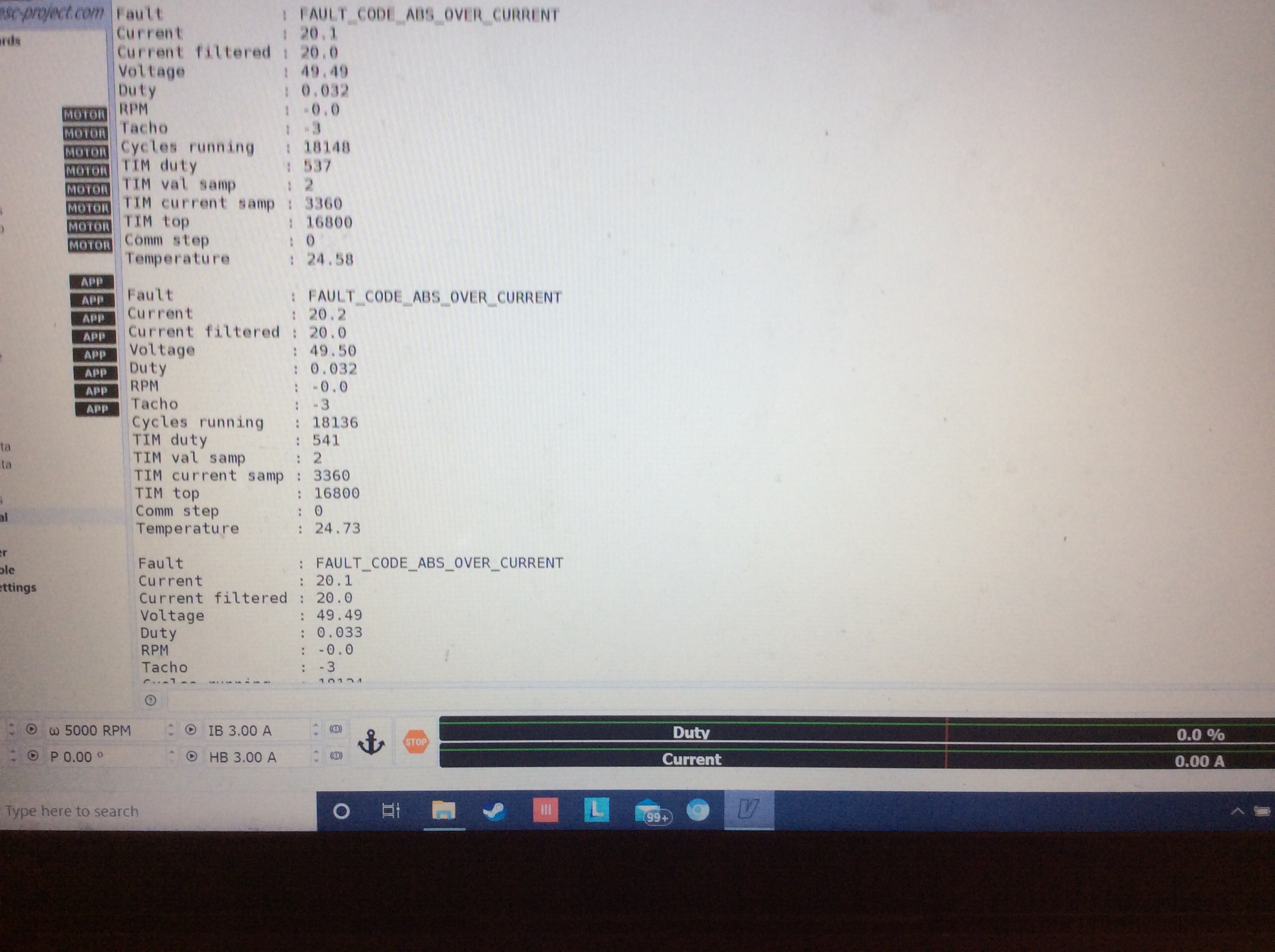

Then went to fault log and this
Can anyone shed some light?
Get the same fault on the other motor
Will check all connections and try again

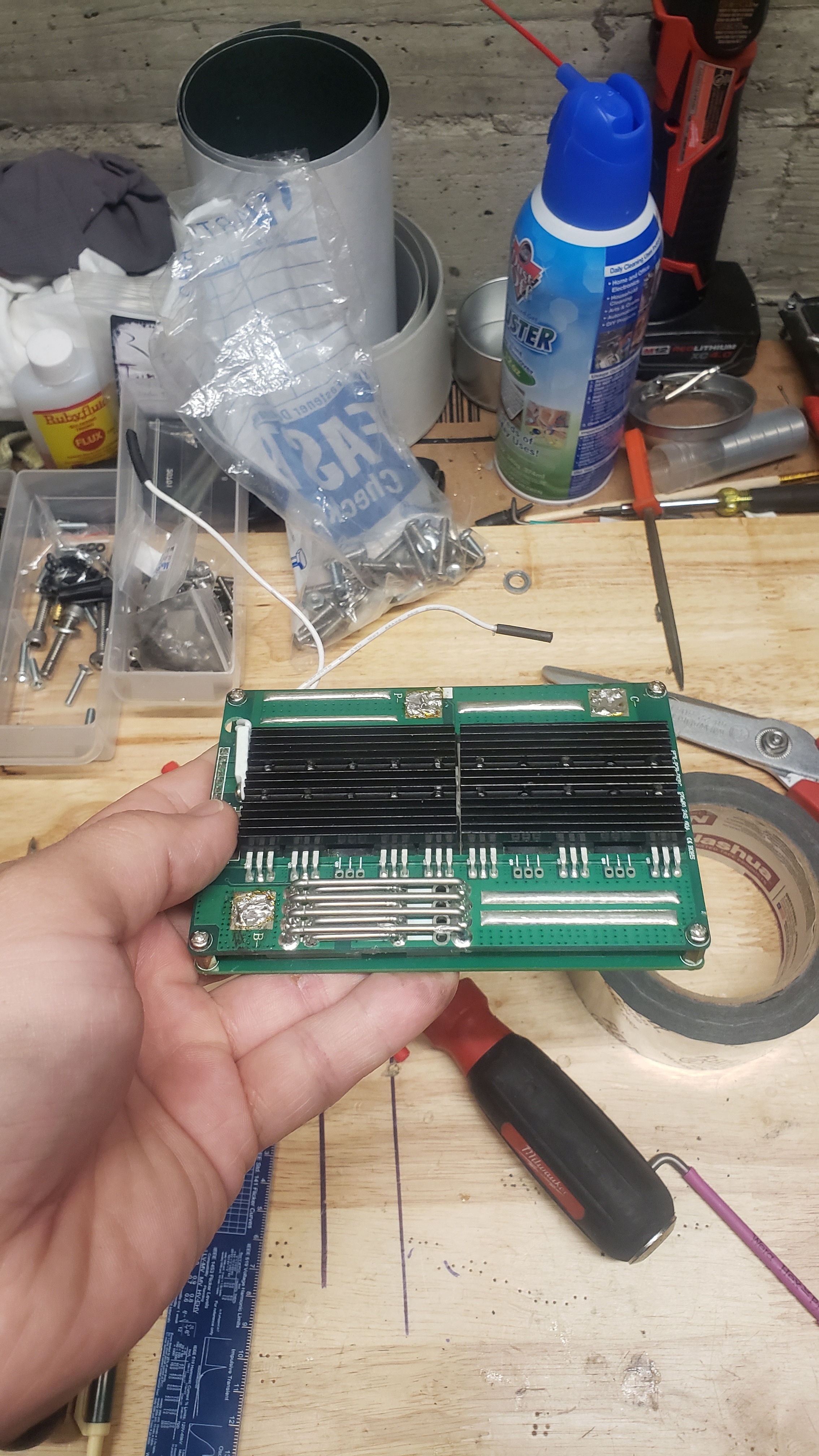

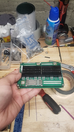

What BMS is this? My D596 started cutting me out, so I bypassed discharge on it, and it fixed it. Sounds like something similar to what is happening to you. When I would reach like 15amps draw while standing on the board the bms would just shut the battery off…not sure why it would read as a fault in vesc too tho. Does vesc tool detect this kind of stuff?
@tinp123 could you remind me
It is a big bestech one that’s all I can remember
Will try finding out

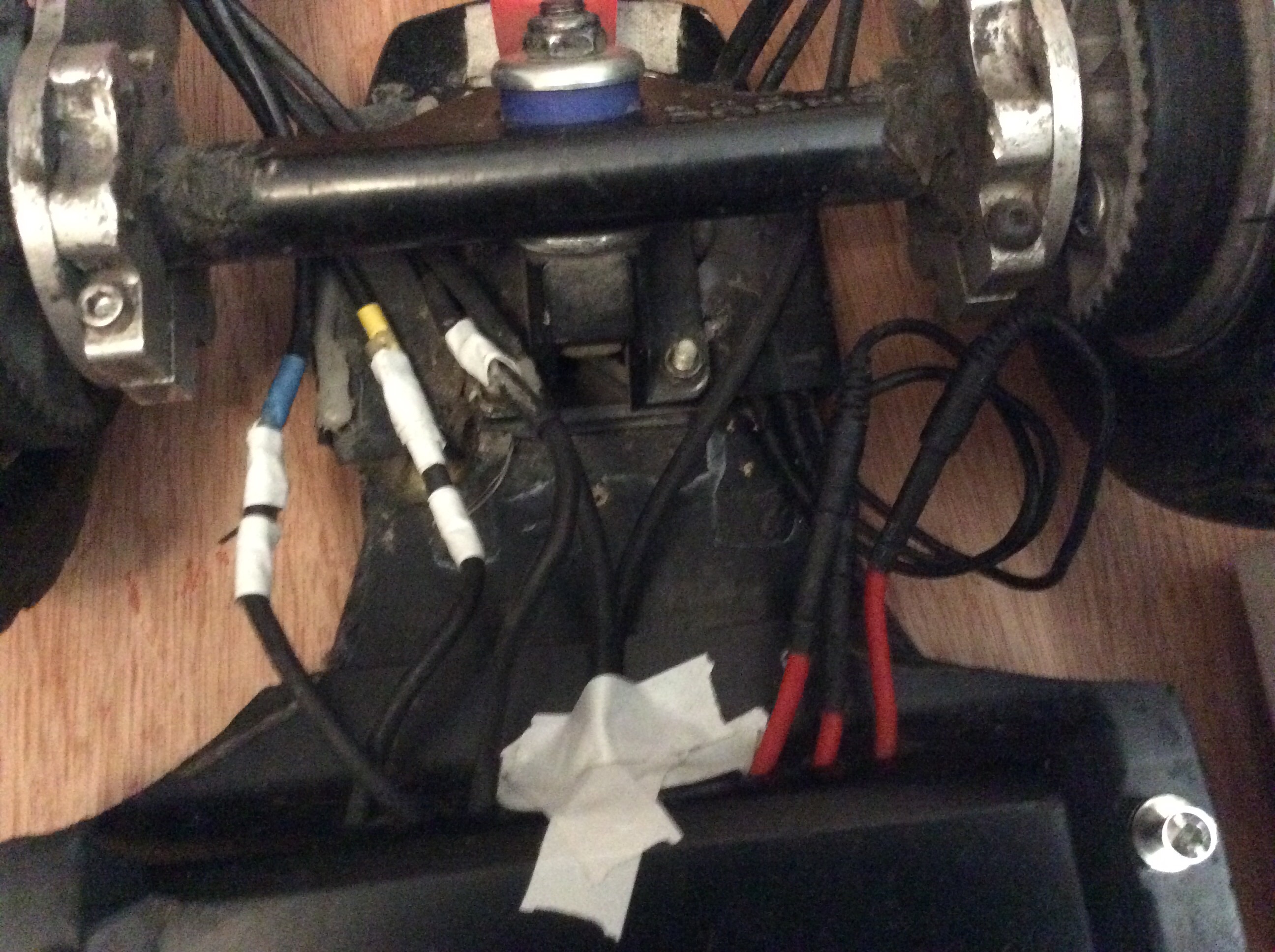

i still think of visual of your phase wiring would be useful so we can identify any obvious issues
Does it look like this?
Yeah here are the phase wires
The right motor phase seem fine not sure about the left
Do you need to see under the electrical tape
Yeah that’s the guy
Yeah your solution is to bypass that discharge and the crappy antispark that is internal to this bms.
@Skyart yes big bestech d596 is inside.

I would first check phase wires. remove all heatshrinks, inspect every soldered bullet.

I had a problem similar to this and it ended up being the solder joints of the bullet connectors. I just re-soldered them all and never had an issue since.

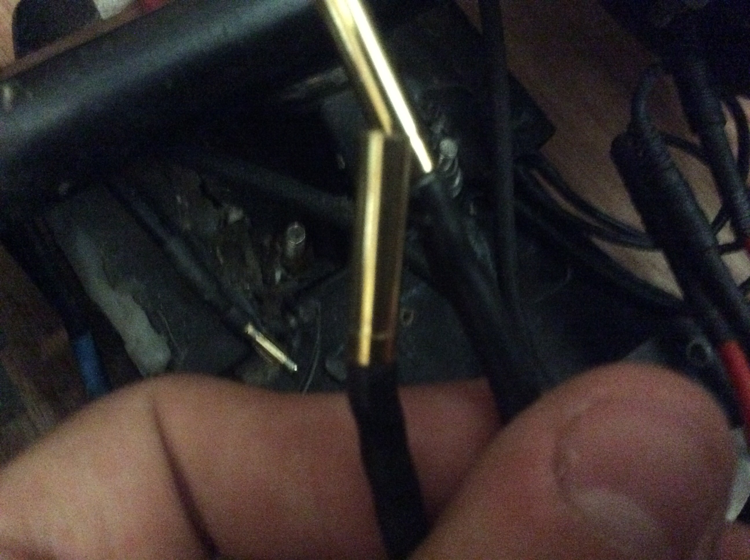

Shua, its time for the reveal of your bullets.
oh yes, post photos of your naked bullets please
WHen you ask like that of course
Stripping them now
I burnt one switch at first and replaced it
It has worked ok for like 500miles since then
Hopefully can keep the bms and not have to scrap it
All bullets have there original solder from flipsky And trampa
Shrink wrap is in slightly tatty condition and I will only have a spare battery once @skyart battery comes to me.

Maybe just heat the bullet up again to let the solder re-flow. Check if there’s enough solder inside.
