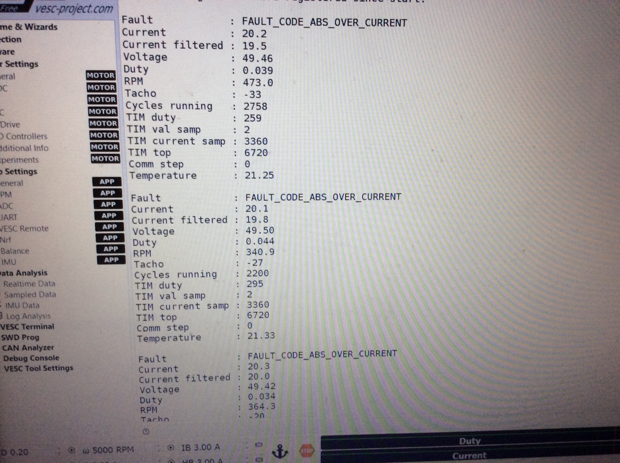

I just reset my vesc settings Andy wanted to change some and now when I try to throttle I get an overcurrent fault
On the bench the motors spin fine but as soon as any weight goes on it during acceleration I get this over current fault

I know that I am getting overcurrent as that is what my davega says when’s I try throttling

Can you post screenshots of your settings.
What was the value that triggered the overcurrent?(should be visible in the vesc tool)

Here are the faults
Do you see anything massively wrong

The overcurrent is triggered in very low current.
Check your connections.
