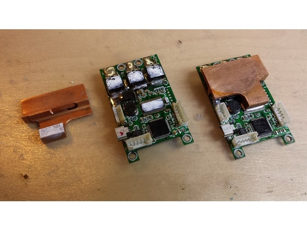

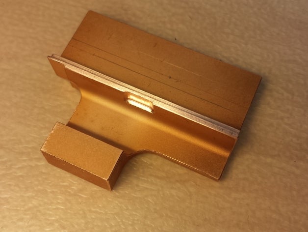

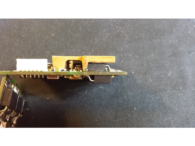

I need to check that copper heatsink out. Back to builders I think right?
Edit. It seems the heatsink also makes contact with the drv chip.

@Kug3lis Now this is how you cool down an ESC with plastic body MOSFETs, maybe you can start turning your aluminum cases into something useful given the pretty price.
@Riako do you know if the guy sells them or the files are available eventually for custom CNC?
Thanks for the link. :beers:
