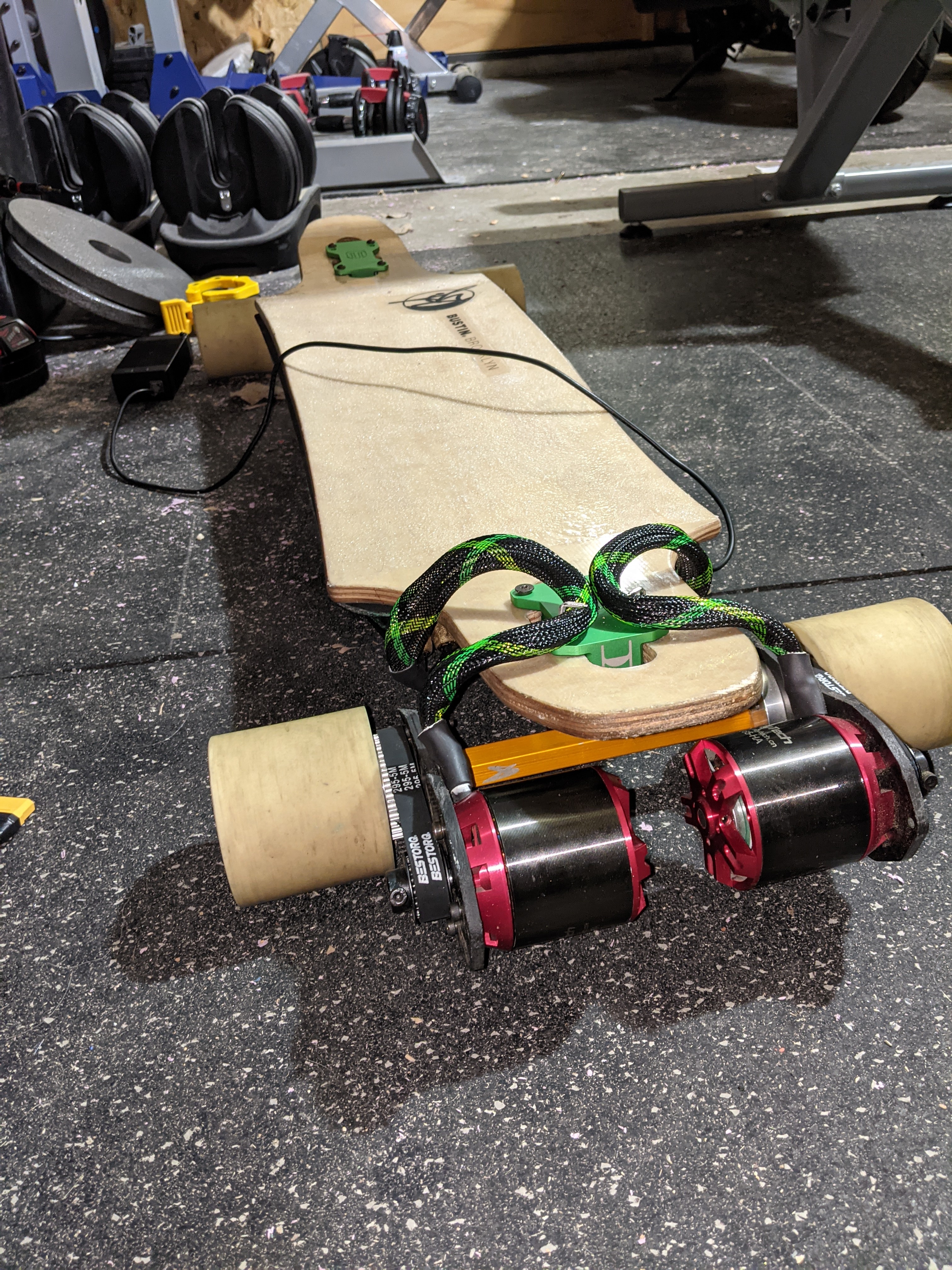

Just got some belts now it’s time to finish
That’s super nice! What is your motor can ground clearance?
Not at home right now but I’ll measure for you and message you it’s pretty low lol
I think I’m gonna switch back to 6374 or 6355
I don’t want it to be super heavy more of a fun light Board
That looks great dude that’s pretty much exactly what I’m working on with these. Clearance is gonna be real low
DROP THRU MAGNUMS CLUB OKAY
That looks nice and clean. What mounts are you using? I’m planning 6355s as well for light weight board.

With these @moon pulleys and dual 6355s, can I make it fit on BN 184s or need to go up to 220 @Boardnamics?
Dex’s picture of the 6355 mounted to what I assume are the 218s, make me think I need to go with 220s, but I hope that Kevin’s extended axles on the 184s, will work.
I think they’ll fit. These are BN 184s with 6355s. The width of the GD is pretty thick.
Yes, that should fit. If you really NEED to know, PM me and I can find out for 100% certain
Just a rough guide, 55mm+55mm+15mm+15mm+10mm+10mm = 160mm for motors, belts, mounts and then some extra space, should fit fine within 184mm.
You could probably even fit it on the BN170 hangers. IDK
That is awesome, thanks for the pic!
Between your reply and Linny’s, I’m getting excited for this build. Thanks for the confirmation!
