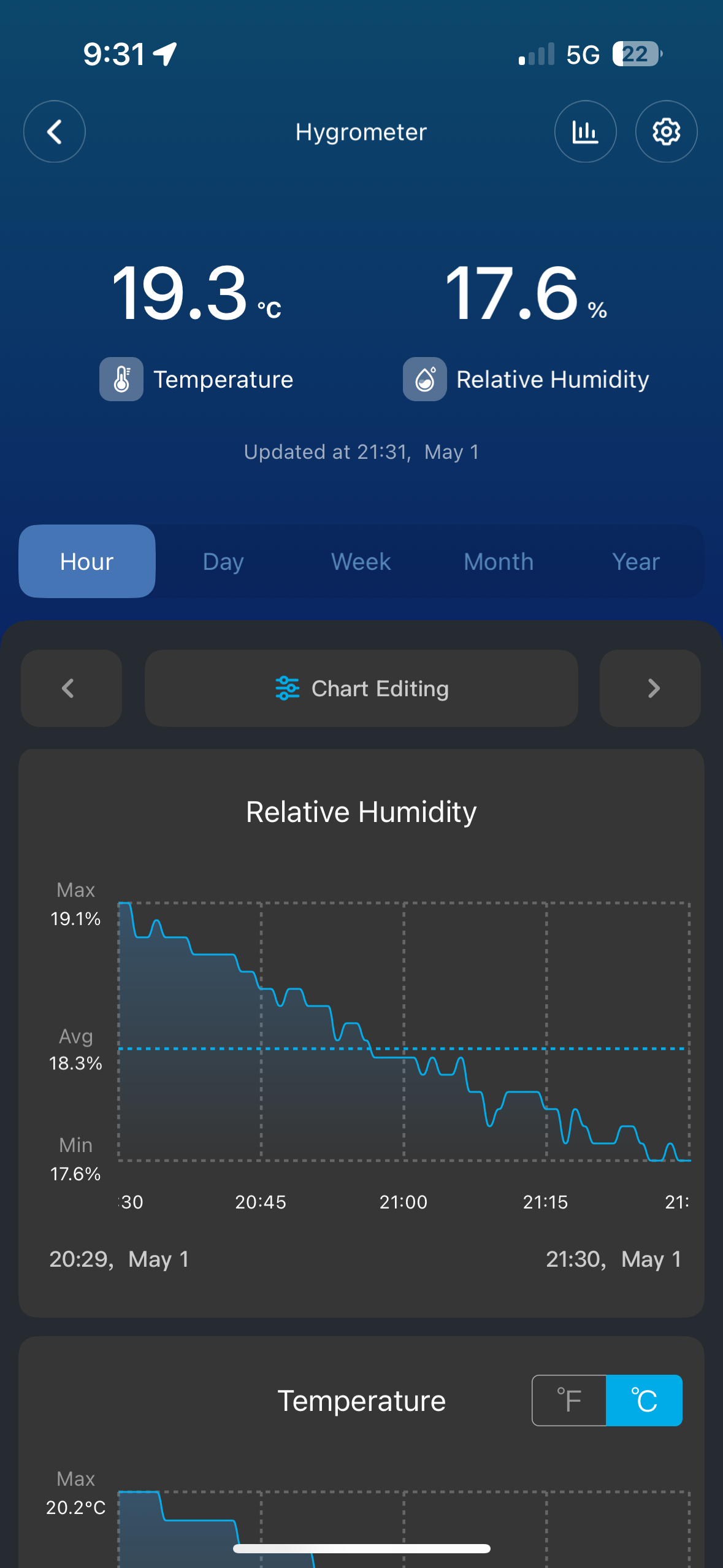

In the mean time, i’ve brought in the big guns. Got this neat little bluetooth hygrometer that shows me real-time humidity and temperature on my phone and logs the data as well so I can monitor changes over time.
God i love data for the sake of data.
For the last 2 nights i’ve had a small space heater running at medium power all night in the van and it’s brought the humidity back down to 50%. Left the exhaust fan on all day today, so there would have been fresh air coming in all day and still sitting pretty at 50%.

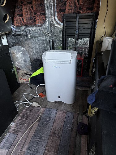

Enter the big fuck off humidifier. The manual says it’s capable of controlling humidity for a 3 bedroom house and can bring humidity down to as far as 35%….
Its been running for 30mins and exceeding expectations already :exploding_head: this gives me great confidence in it’s ability to deep dry the van. I’m gonna leave it on for the evening while i go walk the doggos and hope that my van doesn’t shrivel into a prune while i’m gone :joy:
Wow, so 5hrs total and it’s pulled around a litre of water out of the van.
I am SUPER stoked with this purchase.
