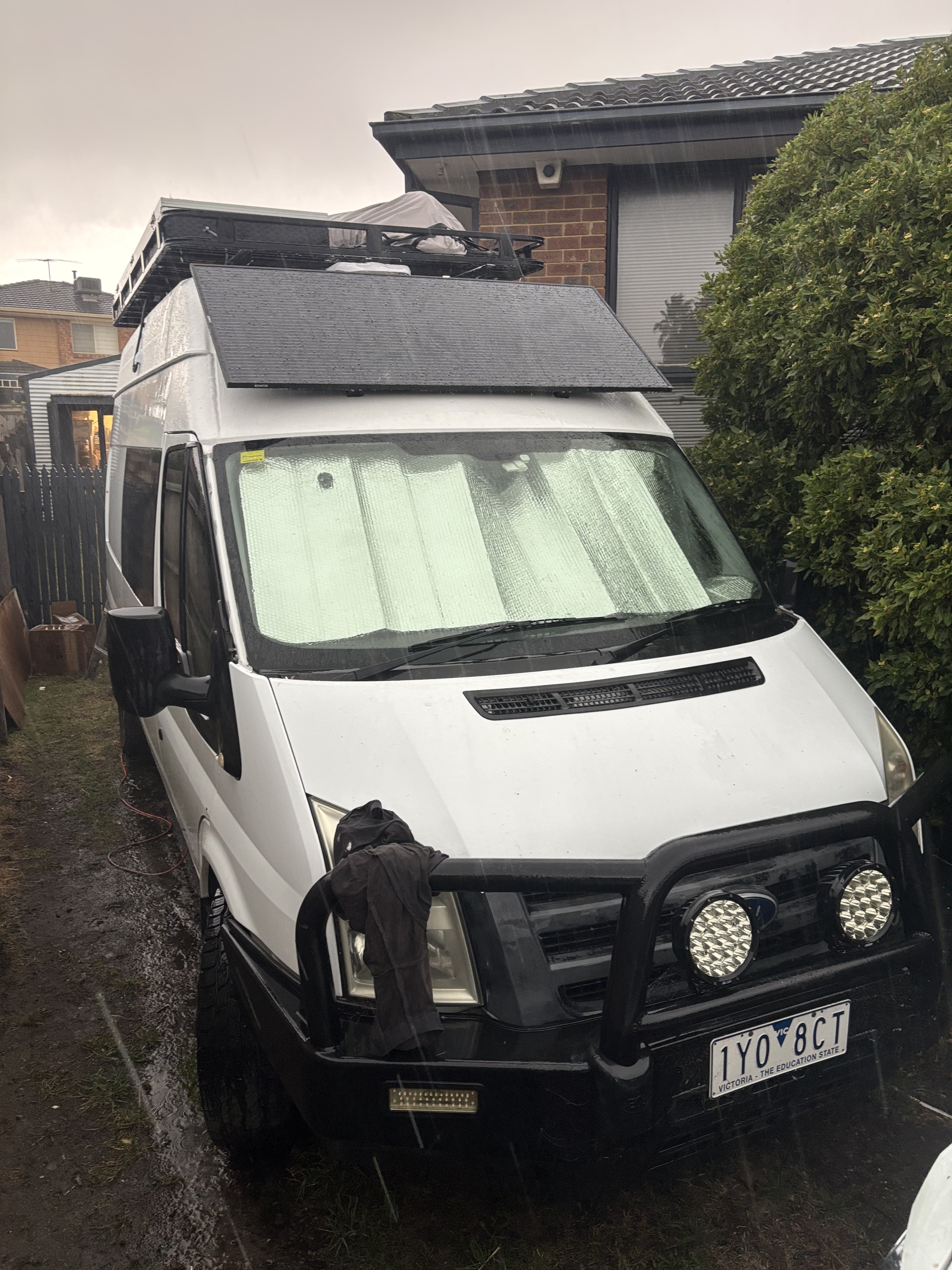

Panel installation went reasonably well despite me getting very wet!

I also turned my van around so the front panel faces the sun better… makes a massive difference! The new panel in prime position is a powerhouse compared to the rooftop ones. I’m wondering if the age of the rooftop ones affects them much… wonder if i can find new ones exactly the same size…… :face_with_peeking_eye:

So that’s basically been the last 3 weeks… not a massive amount of progress, but a considerable milestone for me as these fucking fans have been a total nightmare from the start and it’s nice to have ended on a solution that i’m happy with!
