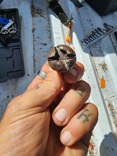

There was significant rust around the drivers seat area, in particular, one of the bolts holding the seat down. It took a hell of a lot of persuasion (swear words), but I was victorious in the end.

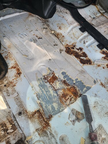

The footwells had this weird hard polyurethane like shit spread on them, and on closer inspection, rust had begun seeping underneath it :face_with_symbols_over_mouth:
It was really difficult to remove, but a hammer, chisel and a lot more swear words later, I had removed all of the foamy shit and uncovered more rust than I had hoped to find.
There was nothing for it but to get stuck in with the grinder and remove as much as I could. It was a shitty job, but I figured the more effort I put in at that stage, the longer I’d get out of it before the footwells disintegrated :joy:

After I’d removed as much rust as I could, I sprayed over it all with a product marketed as a ‘rust converter/primer’…
And then painted over the lot. Unfortunately, the topcoat never cured :face_with_symbols_over_mouth: I left it for like a week with a heater and a fan running in there, but it just wouldn’t have it.
A broken man, I removed the entire mess with paint stripper and painted again.
With that mess behind me I moved on to sound deadening with a foil backed butyl, and then ‘van seal’ a 3mm air filled foil barrier. I am hopeful that all my work here will allow me to never need to return to this area again :joy:
