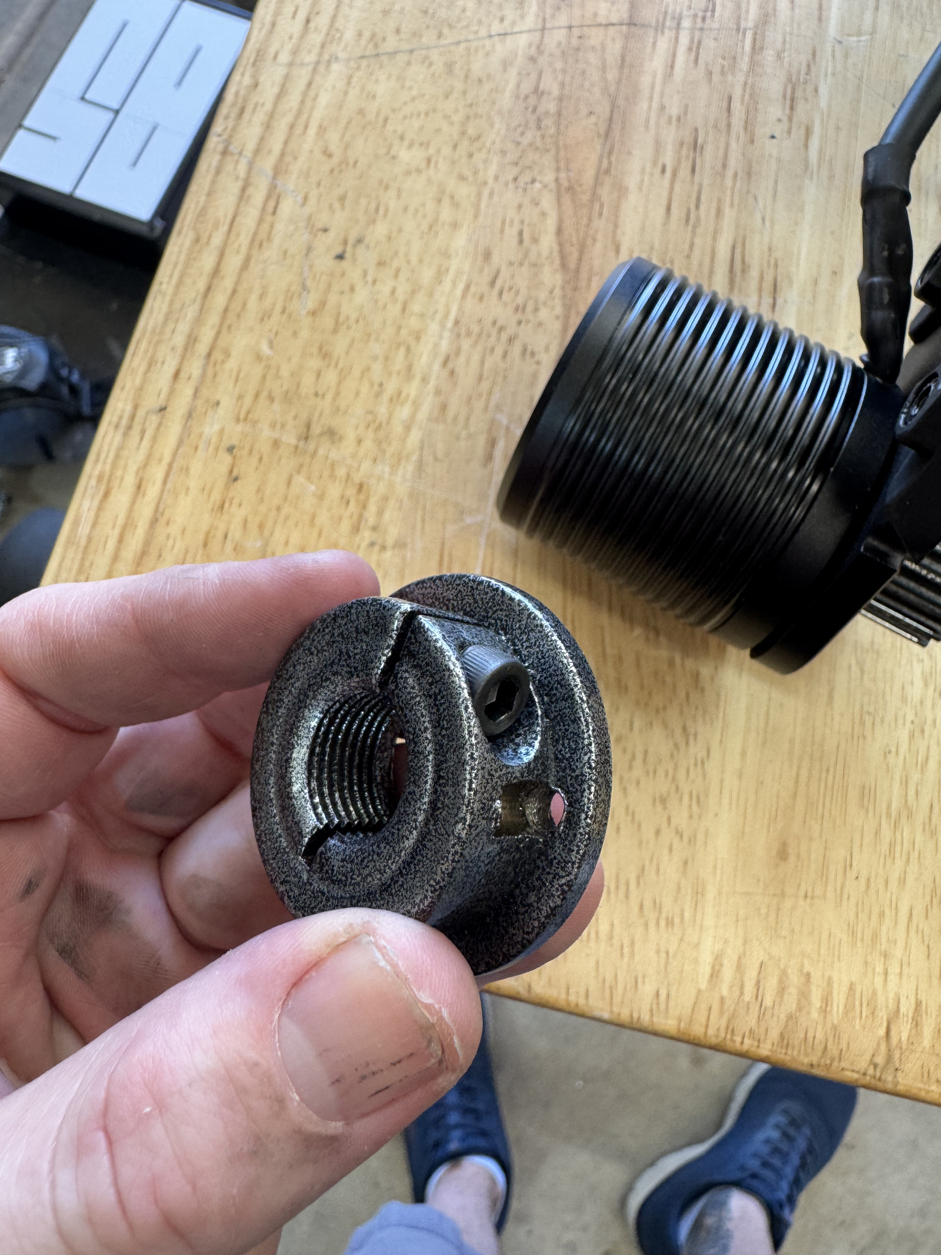

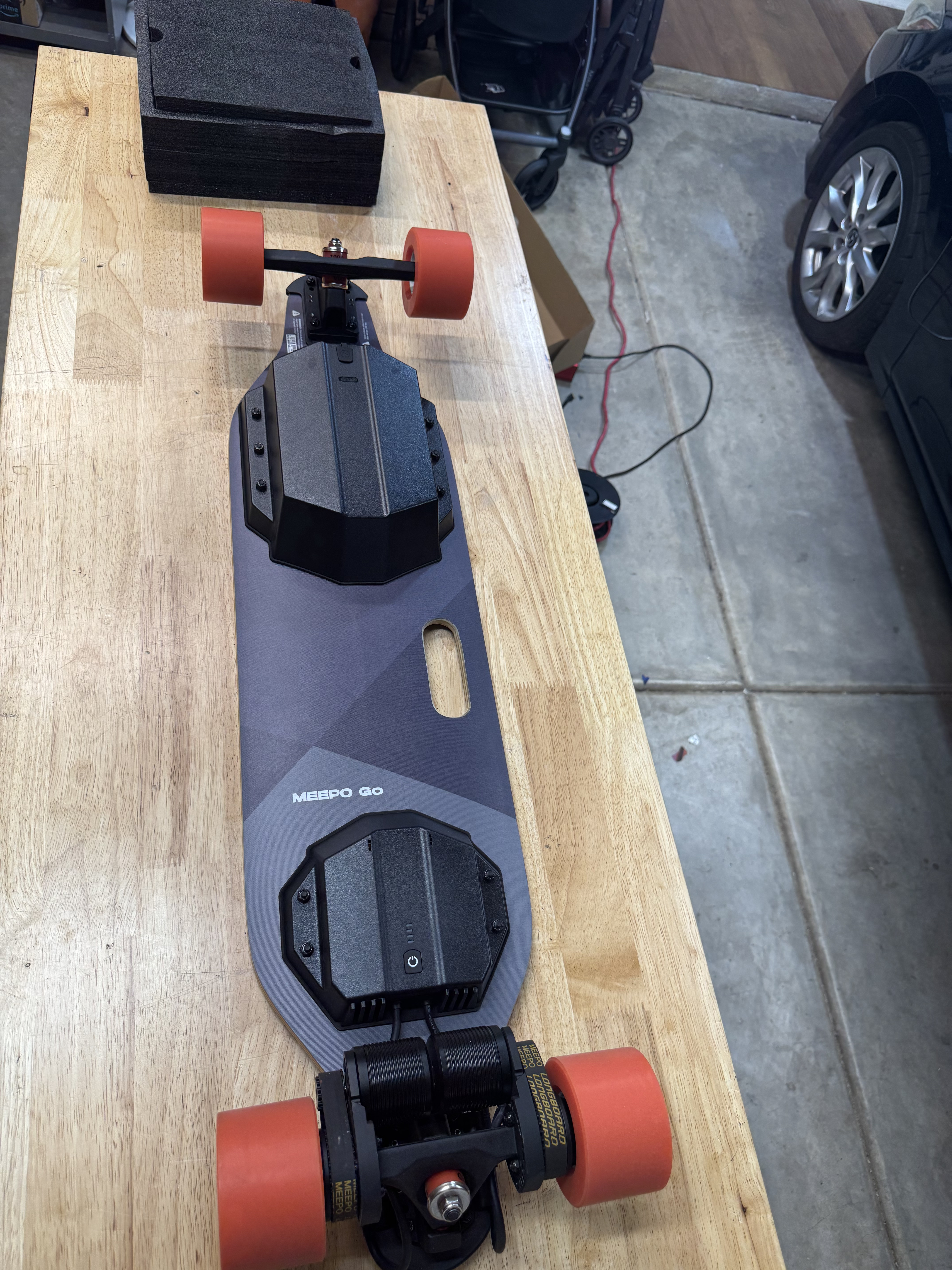

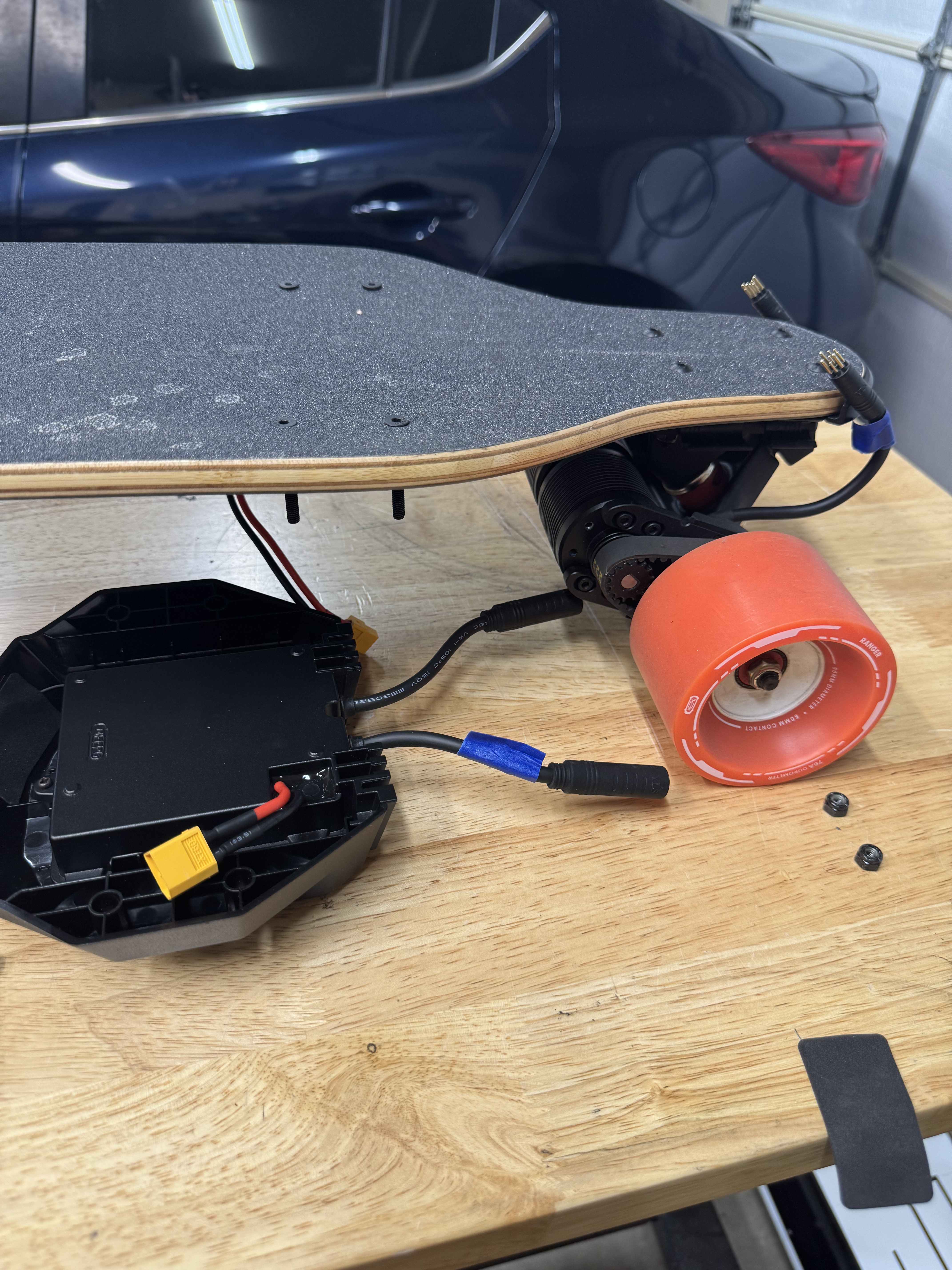

Stripping the Meepo
Easy enough process, no surprises here except for how tiny these motors are.

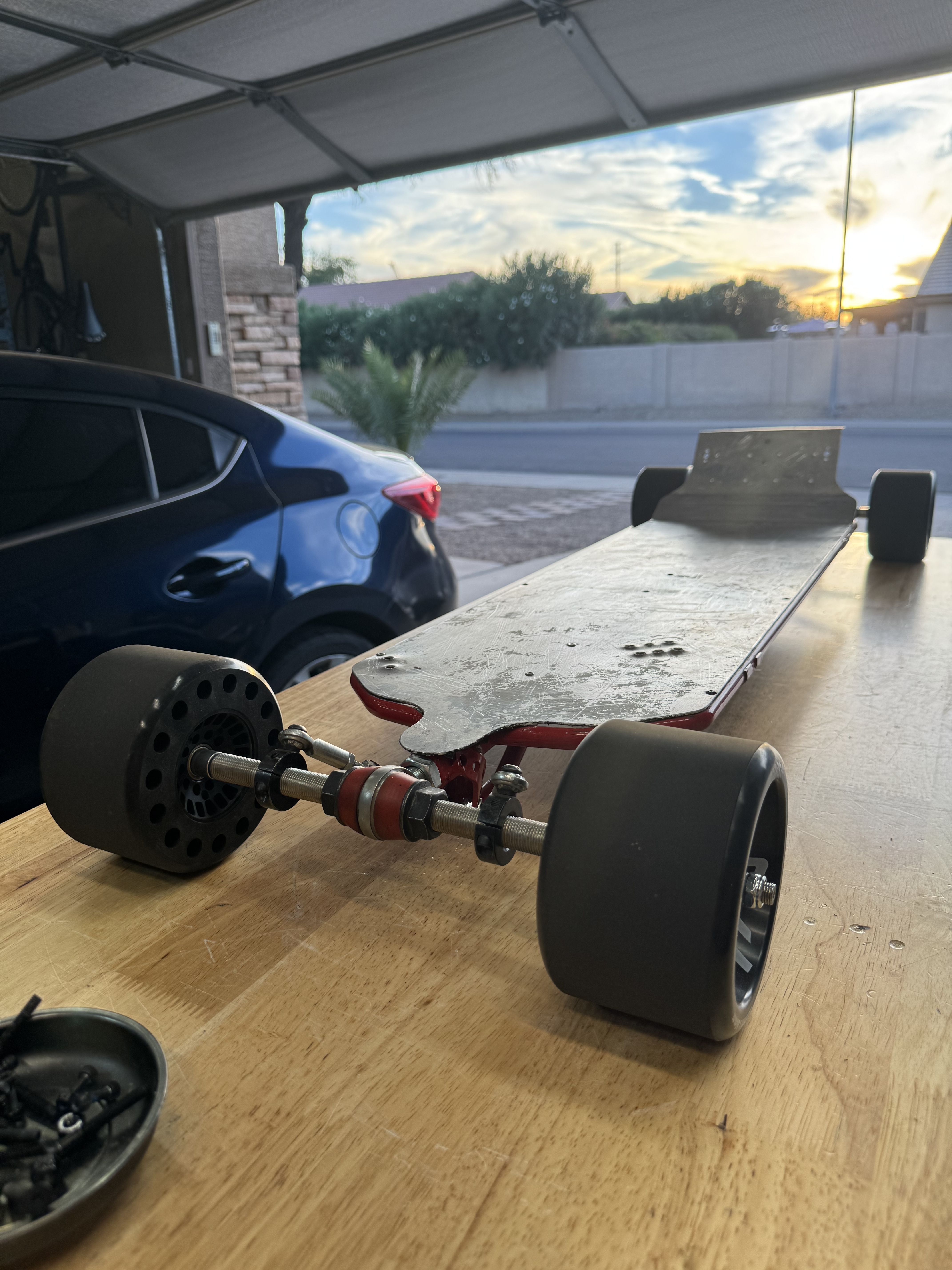

V5 on MAD125mm

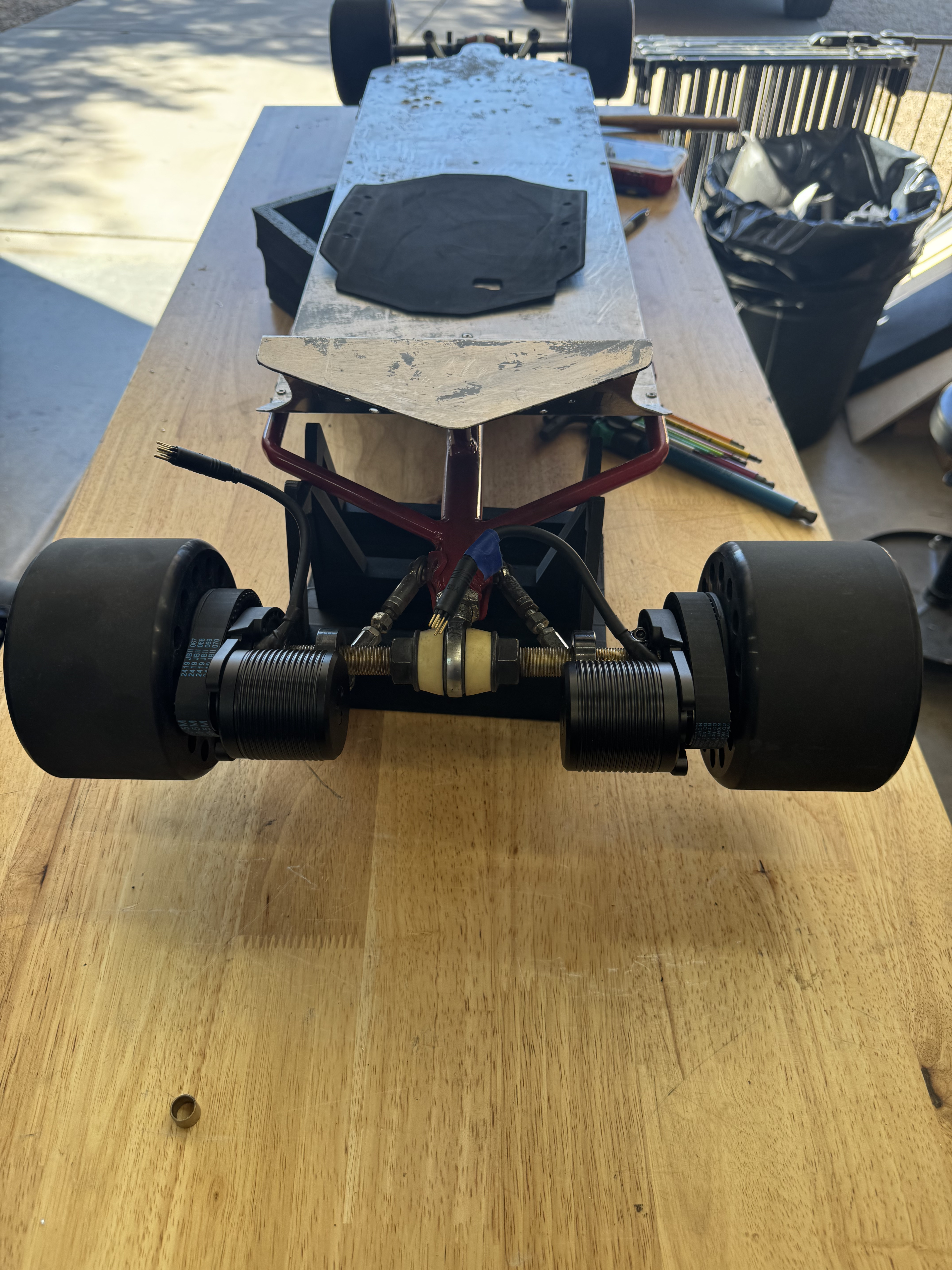

So…. 9MM of clearance between frame and ground. This is a track princess so I’m fine with ultra low clearance but it’s not like we all ride perfectly smooth lots. I may consider using one of those drop angle heims to give me a little lift if needed. Just going to be ultra aware of this and ride no binding for a while.

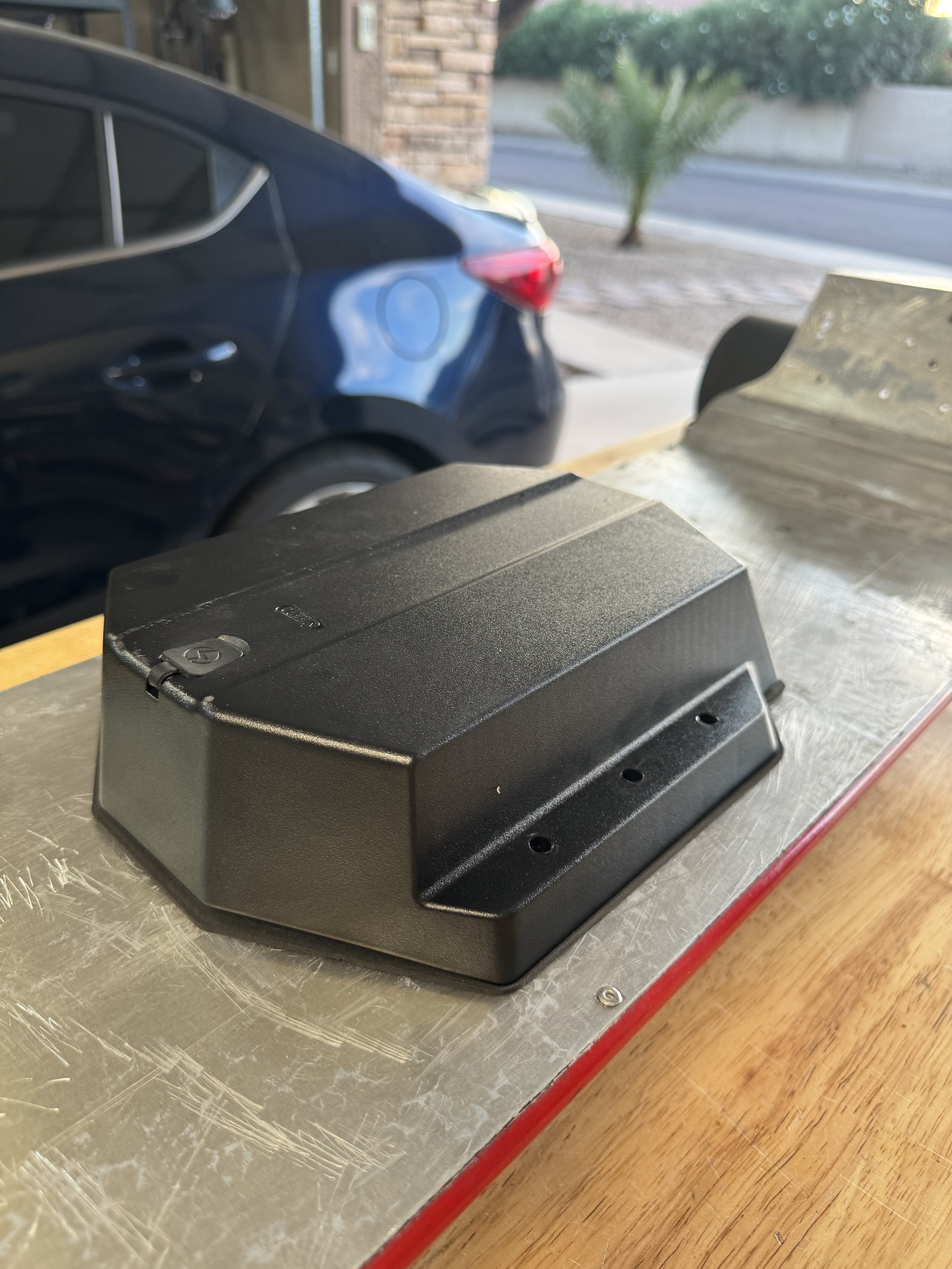

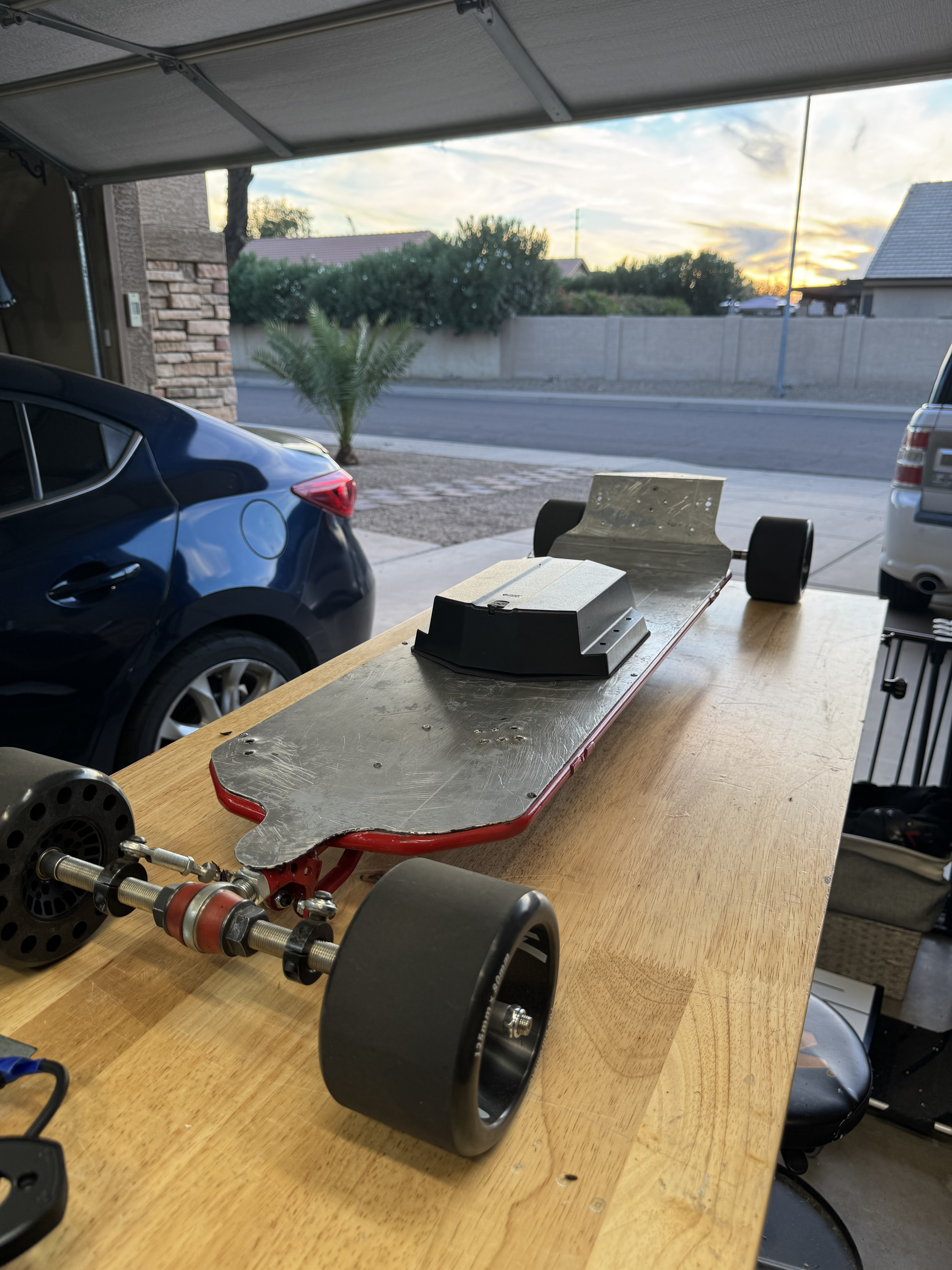

Placing the battery box and ESC on the V5
The top mount of the battery will be no issue as the V5 has ample deck space. Here it is just resting on top. Wires will be run under deck along spine.

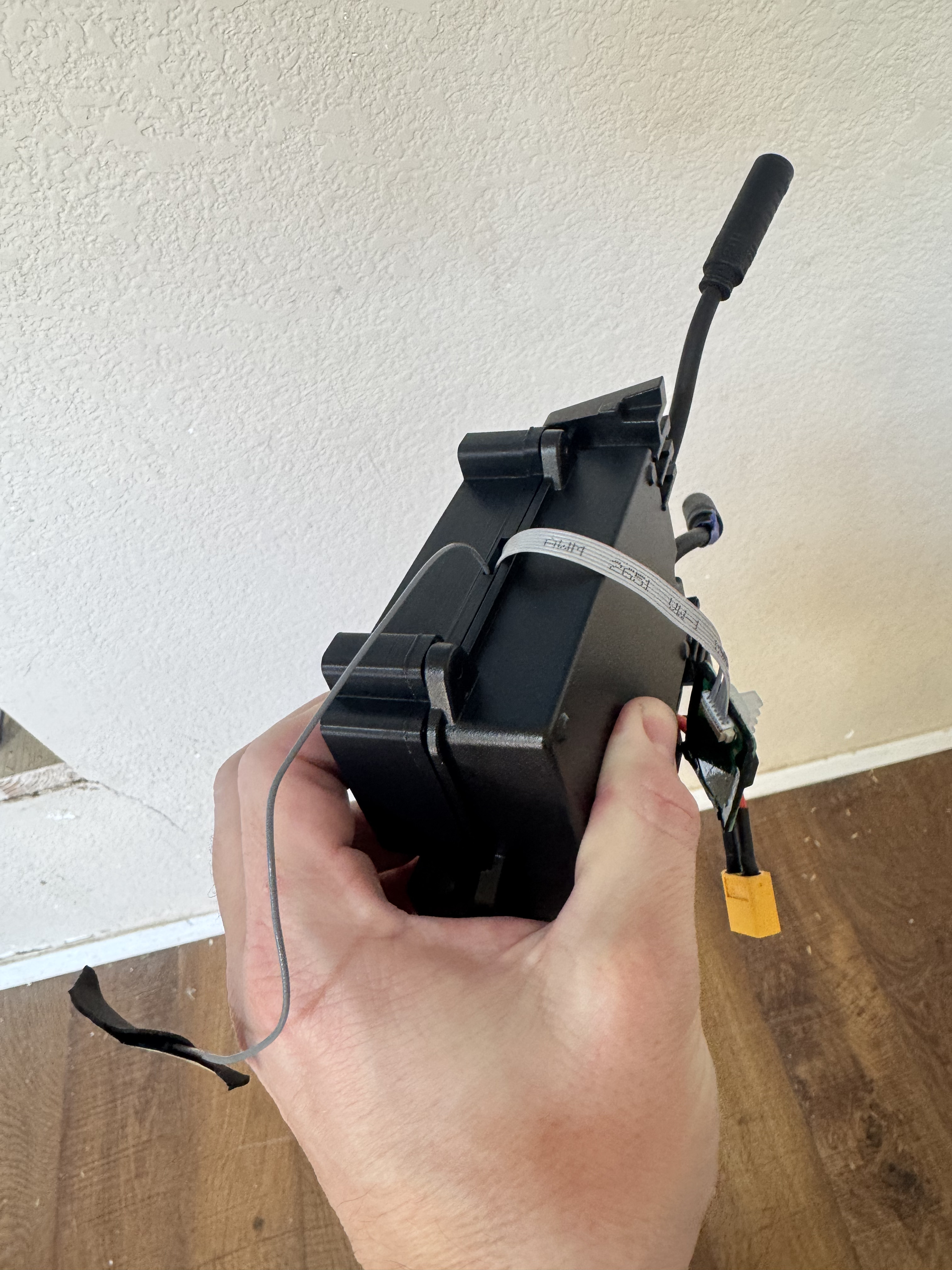

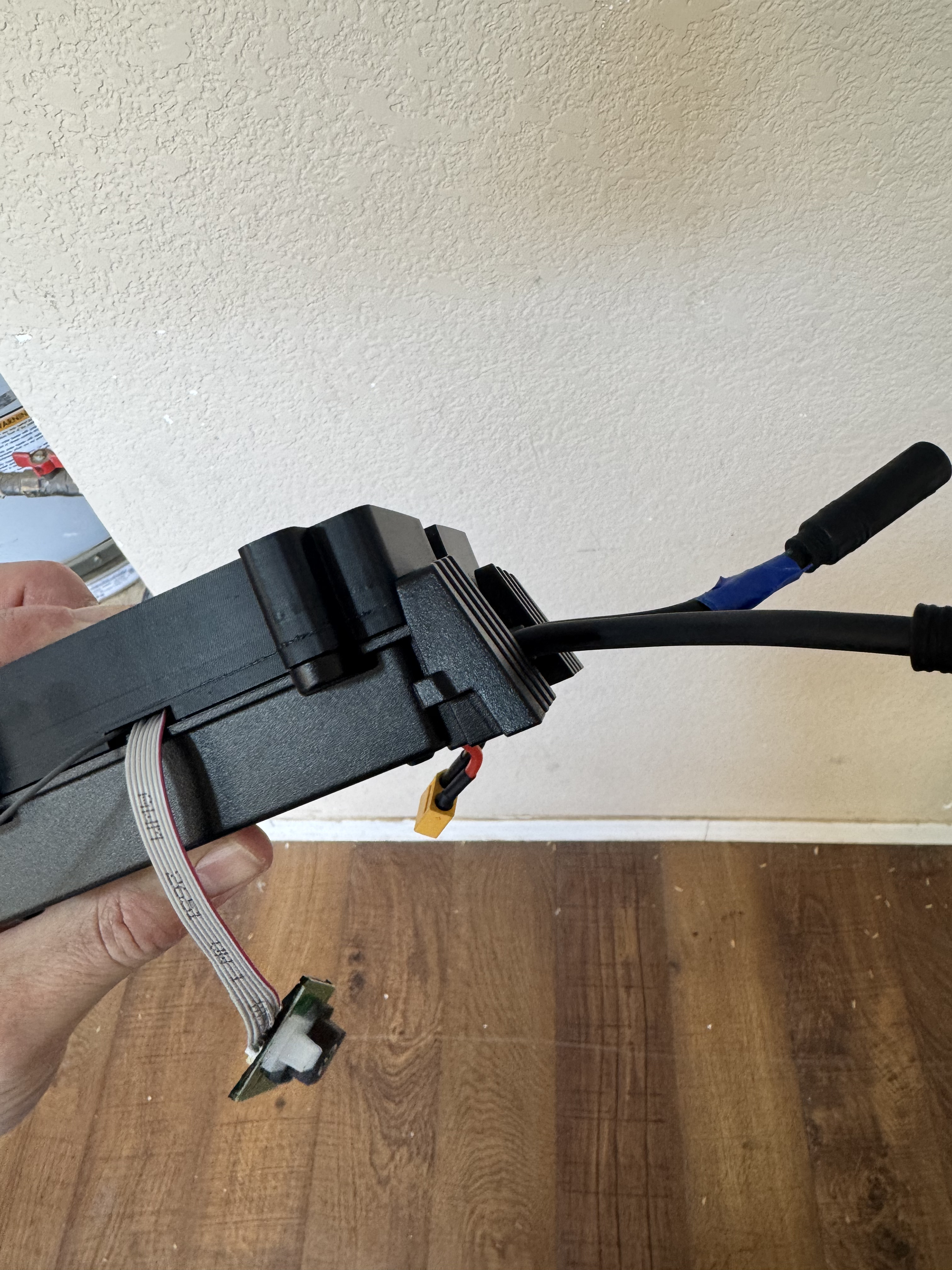

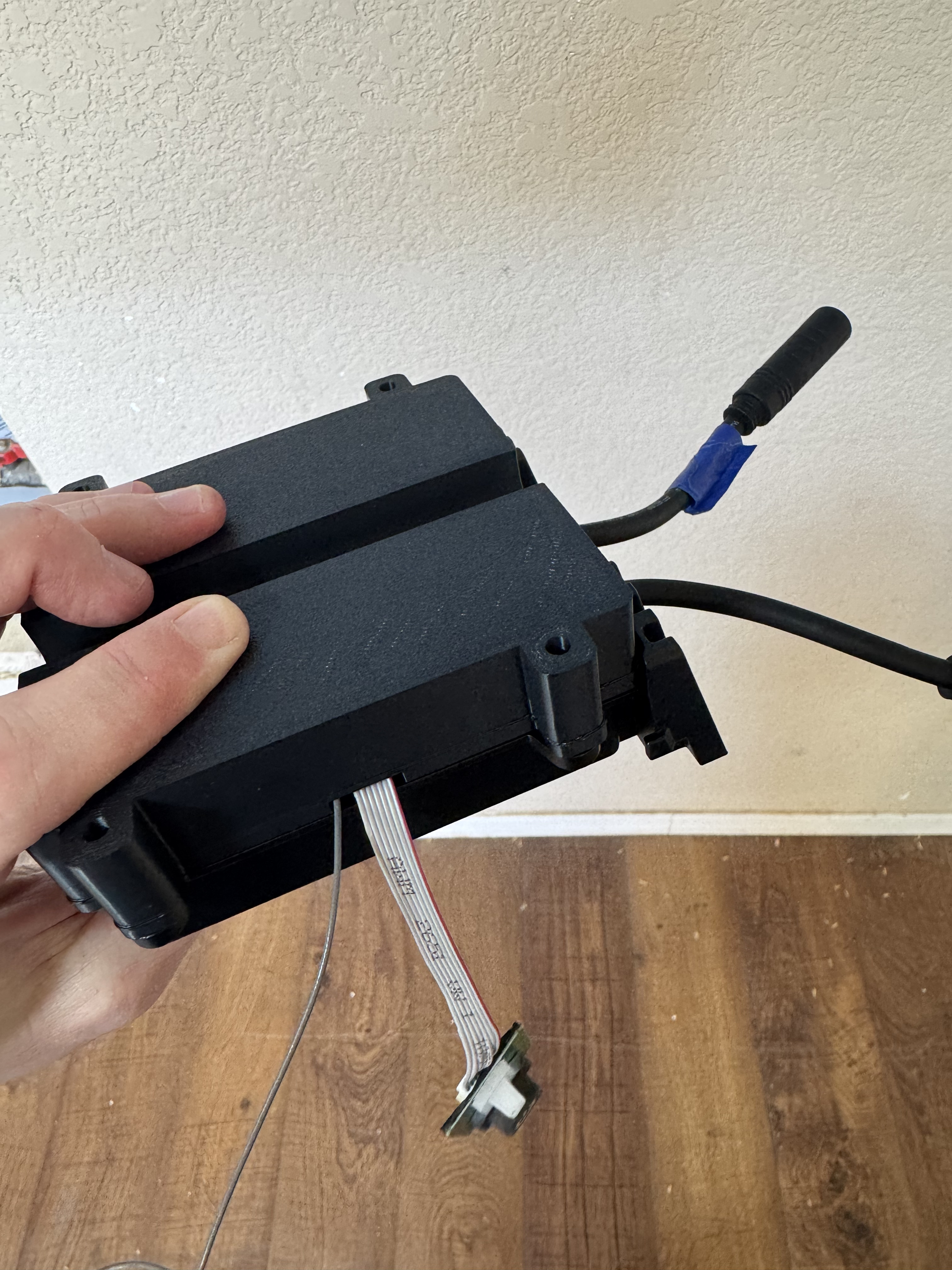

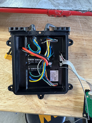

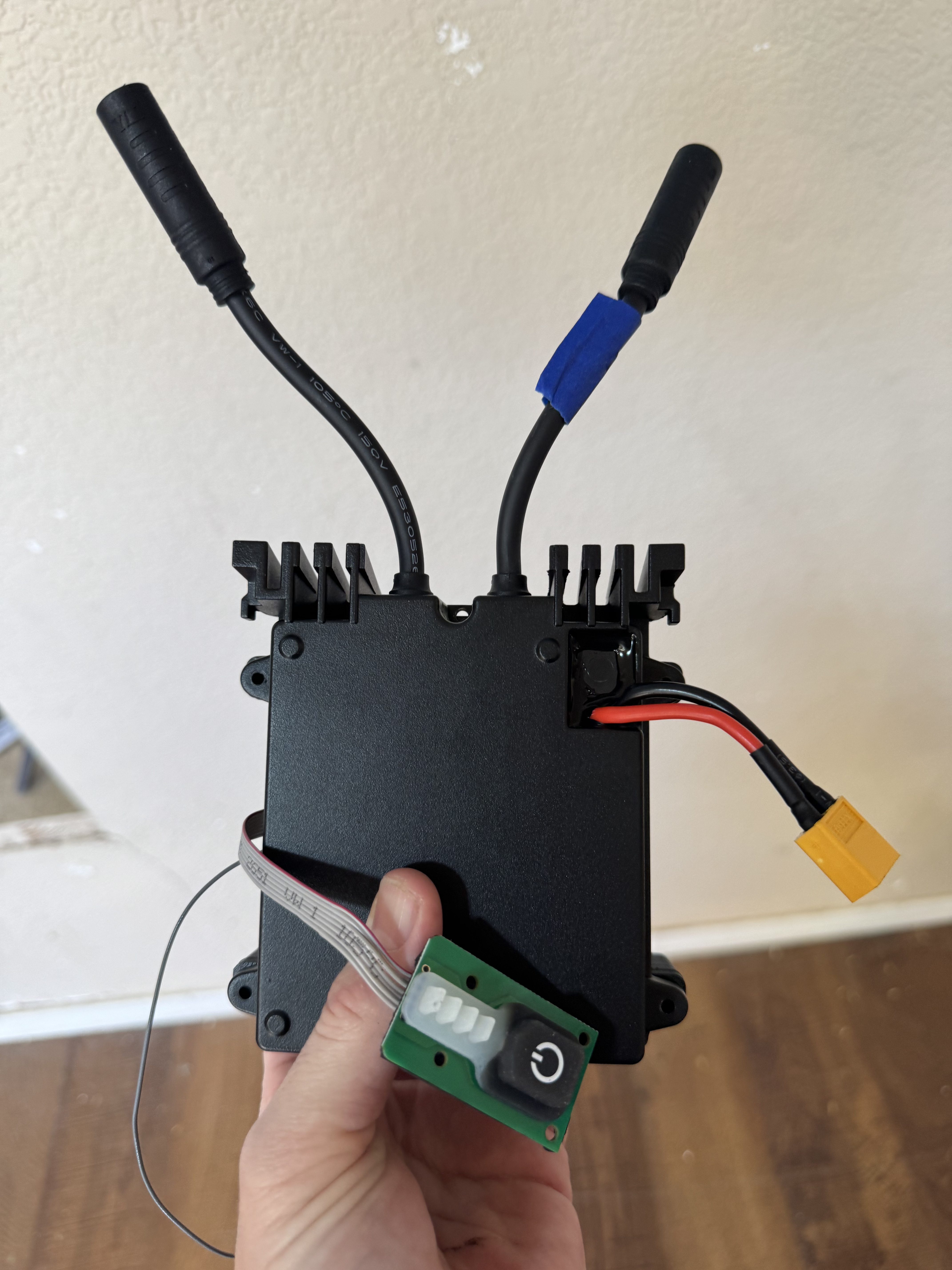

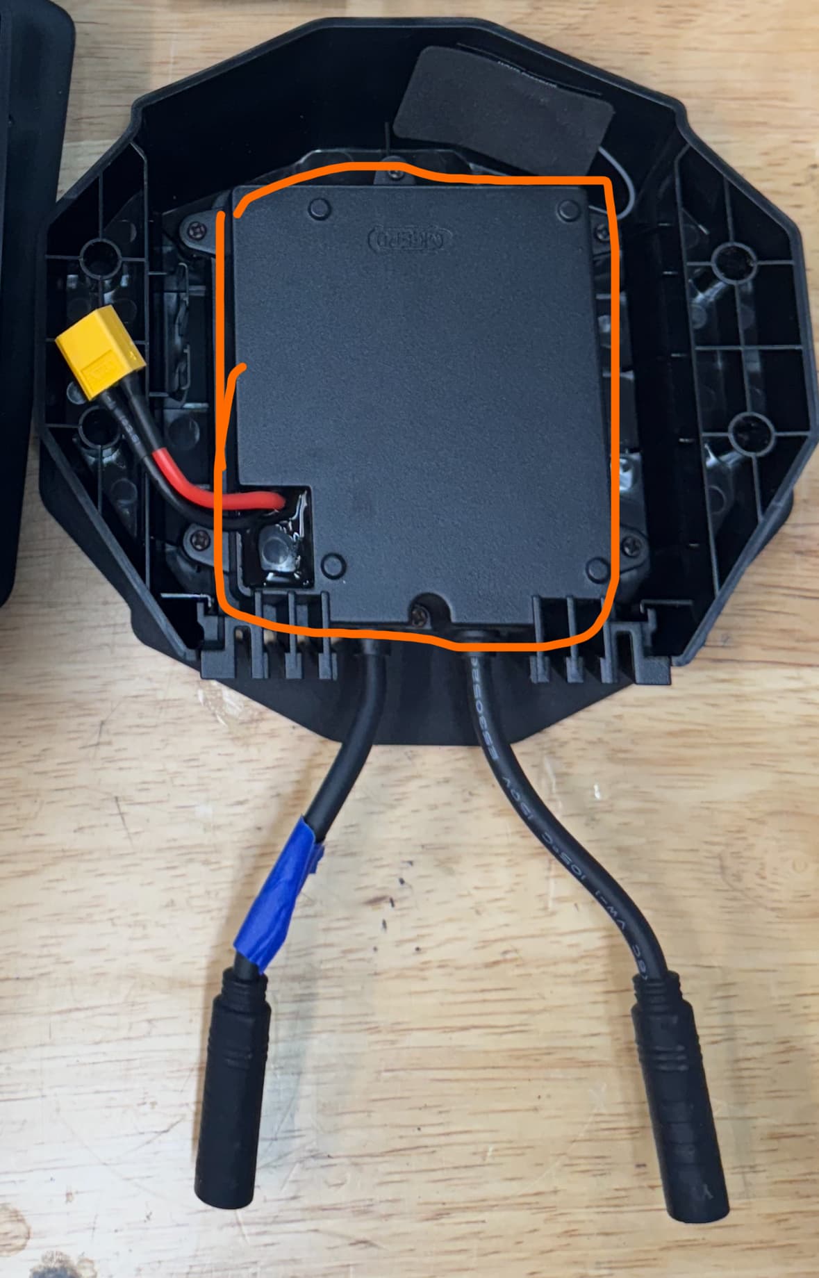

Custom ESC mount
The ESC box proved to be a little more difficult. The ESC is almost like a enclosure within a enclosure, I was able to remove the internal housing you can see in highlighted here.
That left me with this. It’s half open but much smaller.

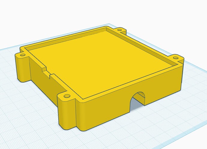

So I designed a kind of cap/mount/standoff for it to both enclose the ESC and provide a way to mount it under the tail of the board. I made sure to account for the frame structure as well. Printed in ASA, came out decently clean, good enough for under a race board. Drilled four holes in the tail and ran M4 bolts through. Test fit here is a success.

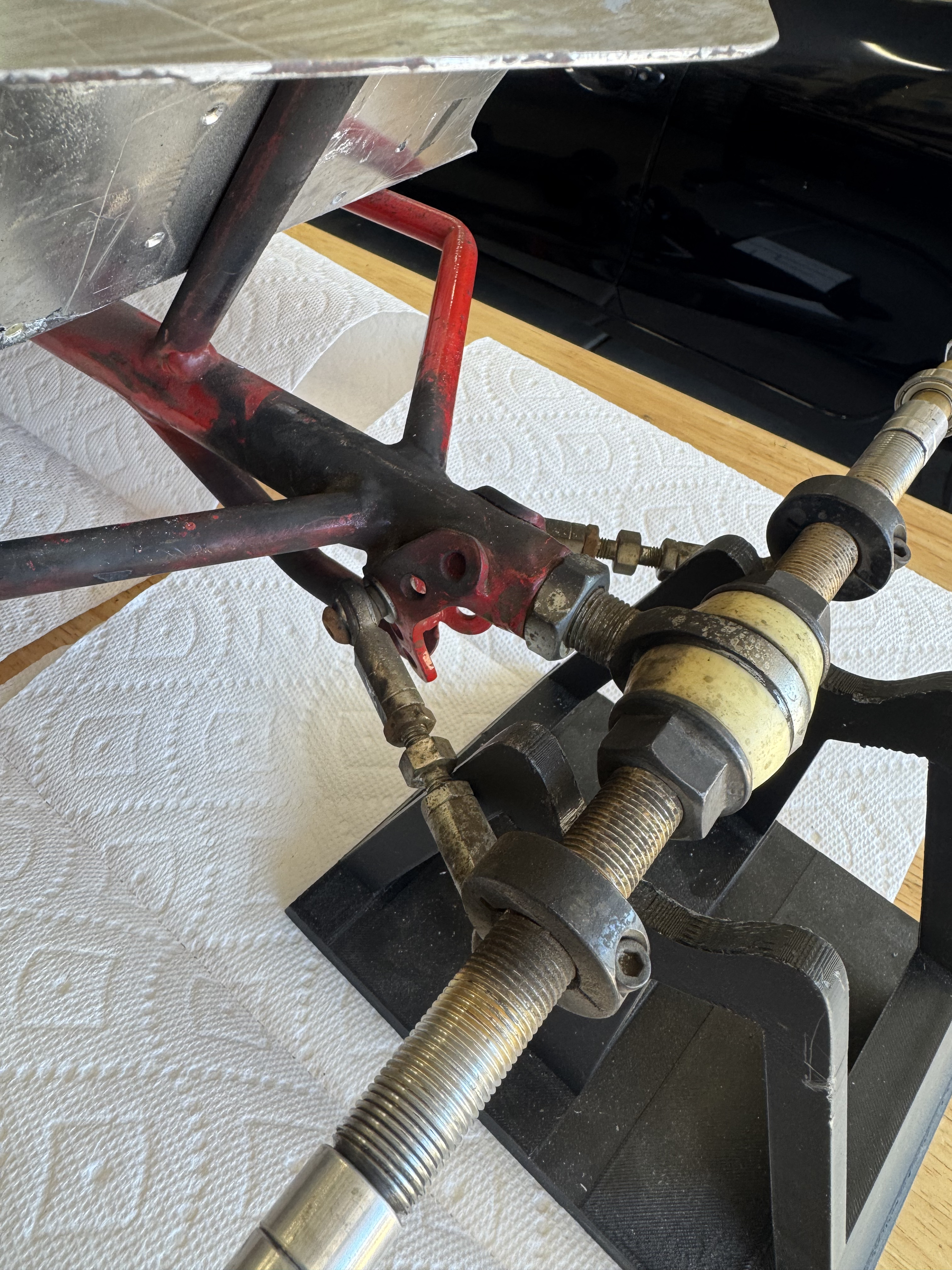

Time to clean
Some brake cleaner, a wire brush and a pile of paper towels later and all the burnt electronic soot is gone. It smelled terrible, was nice to get that all cleaned up finally.

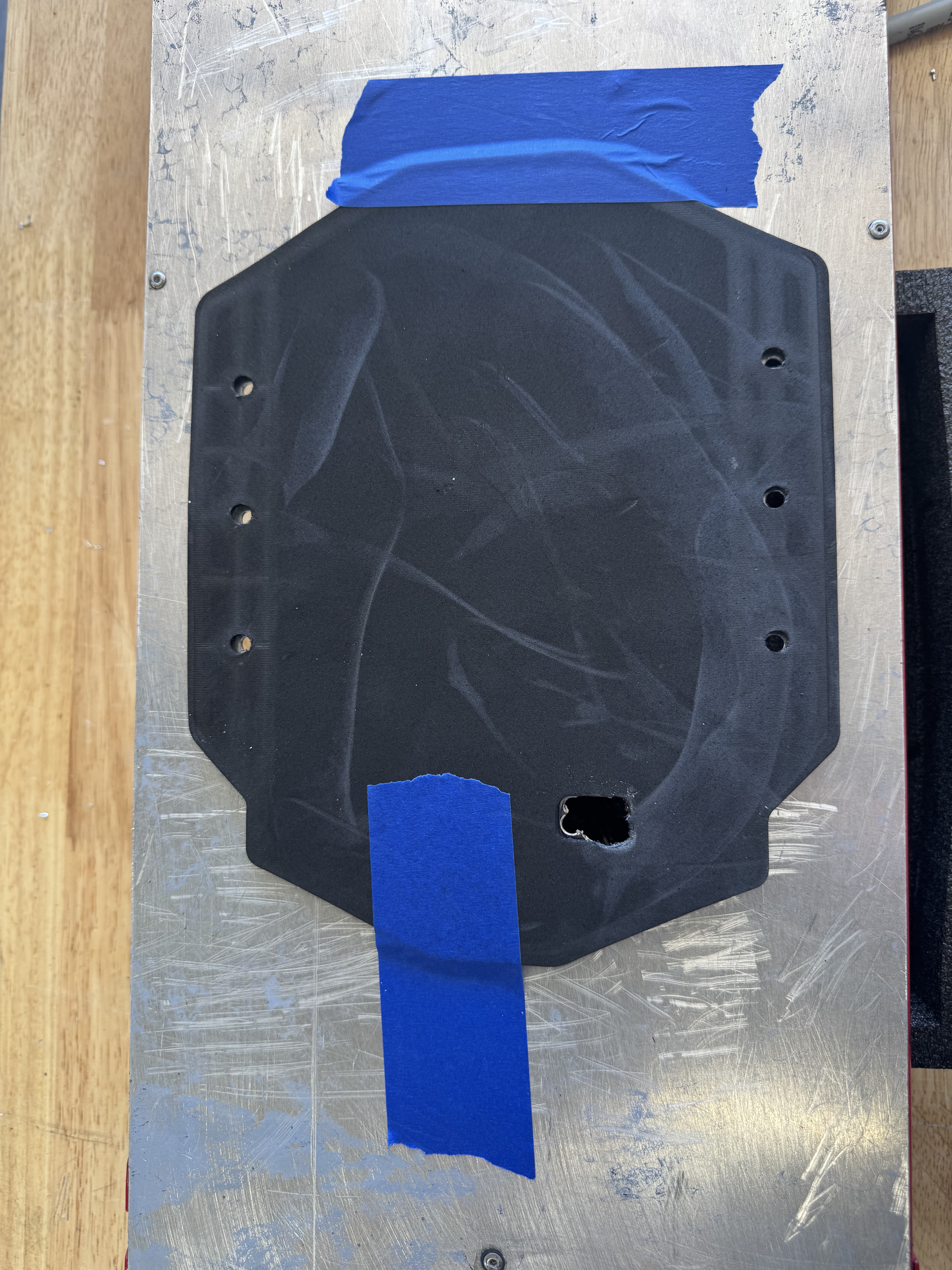

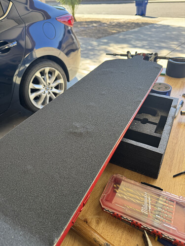

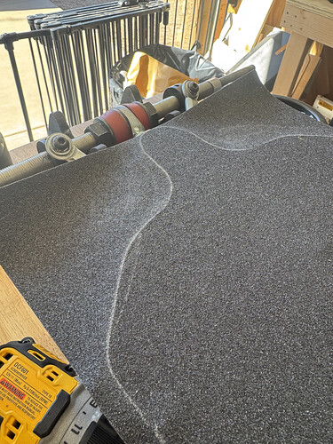

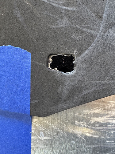

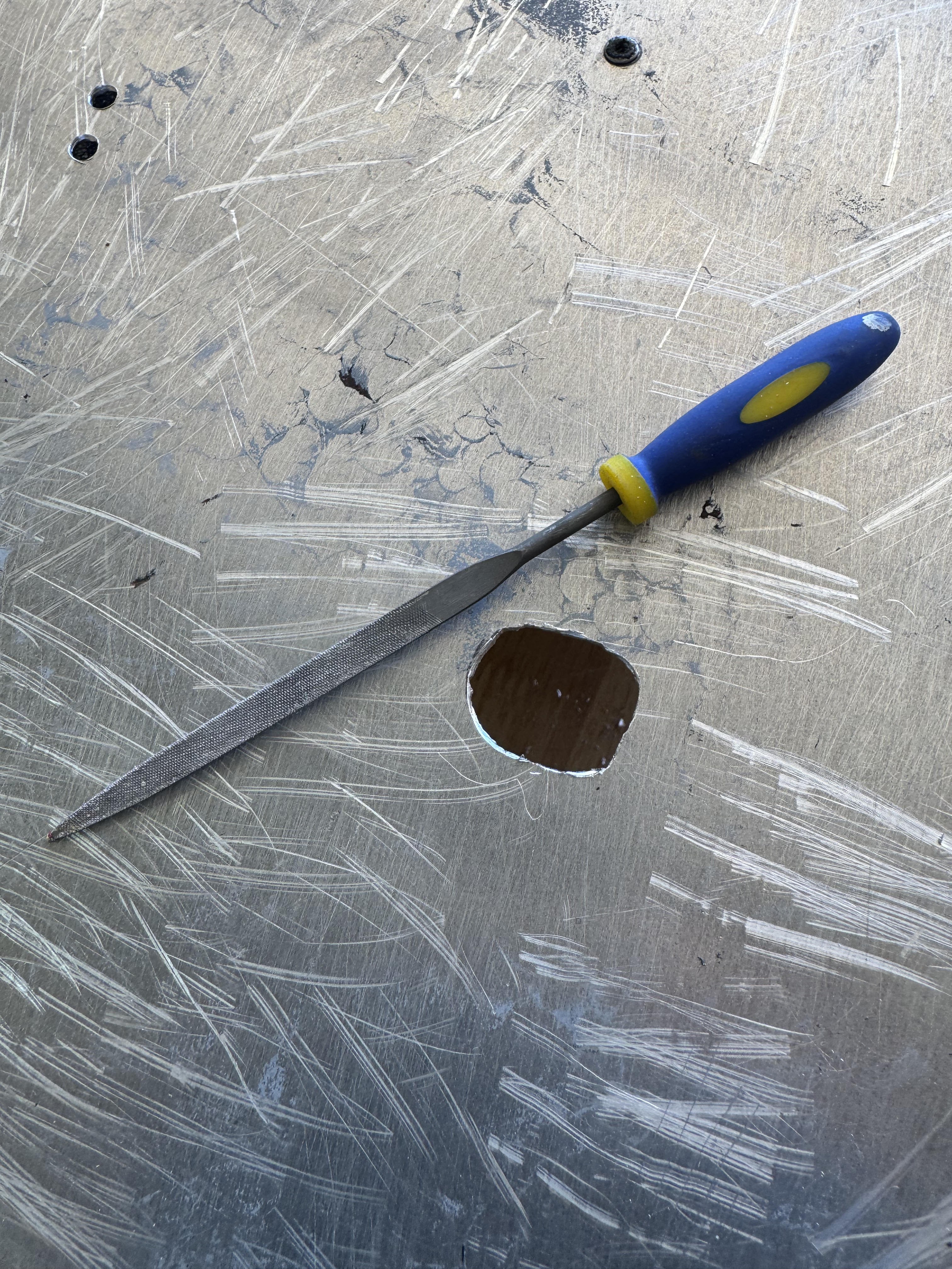

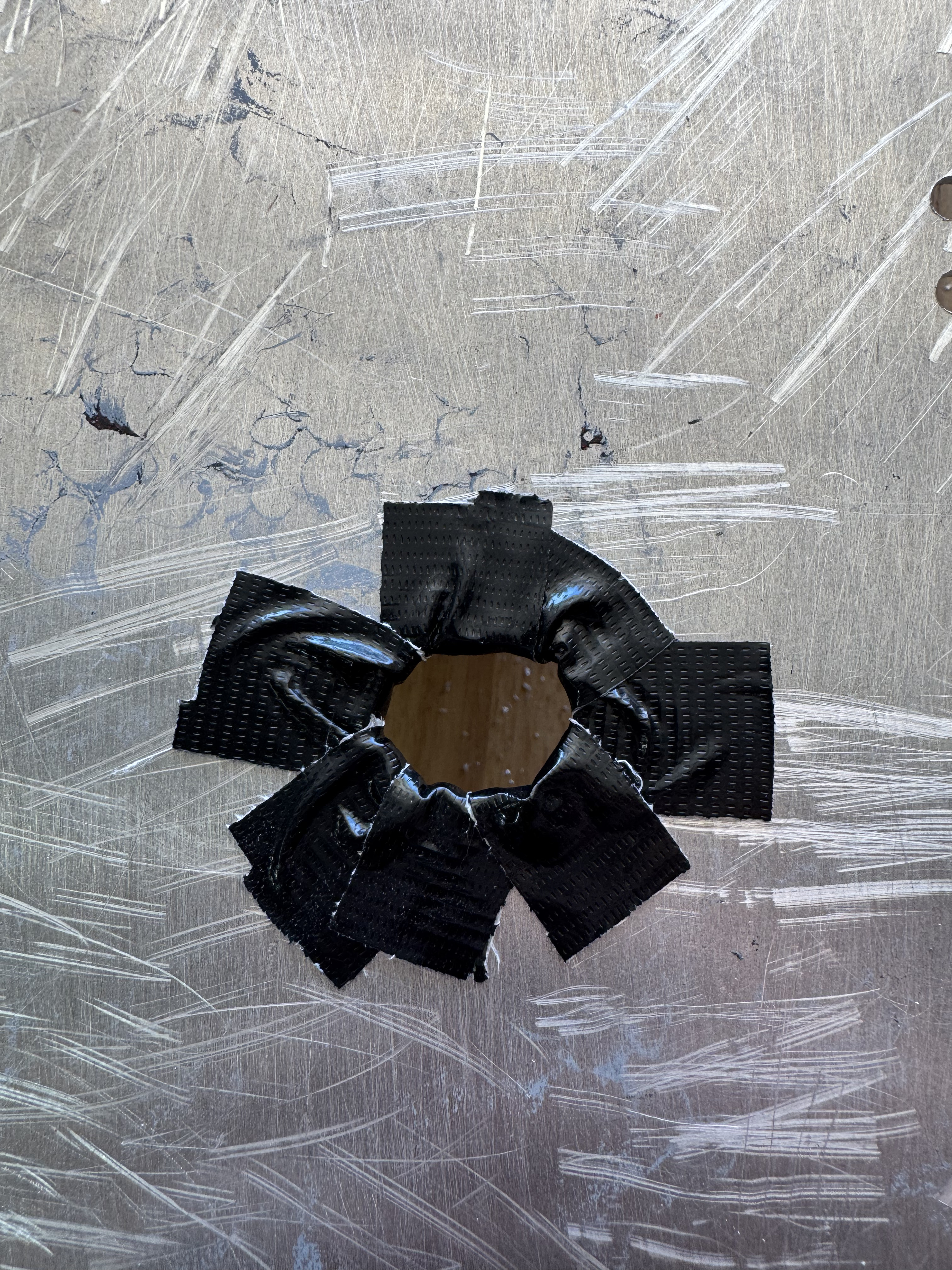

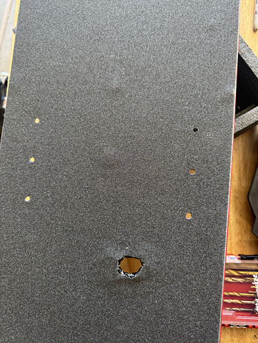

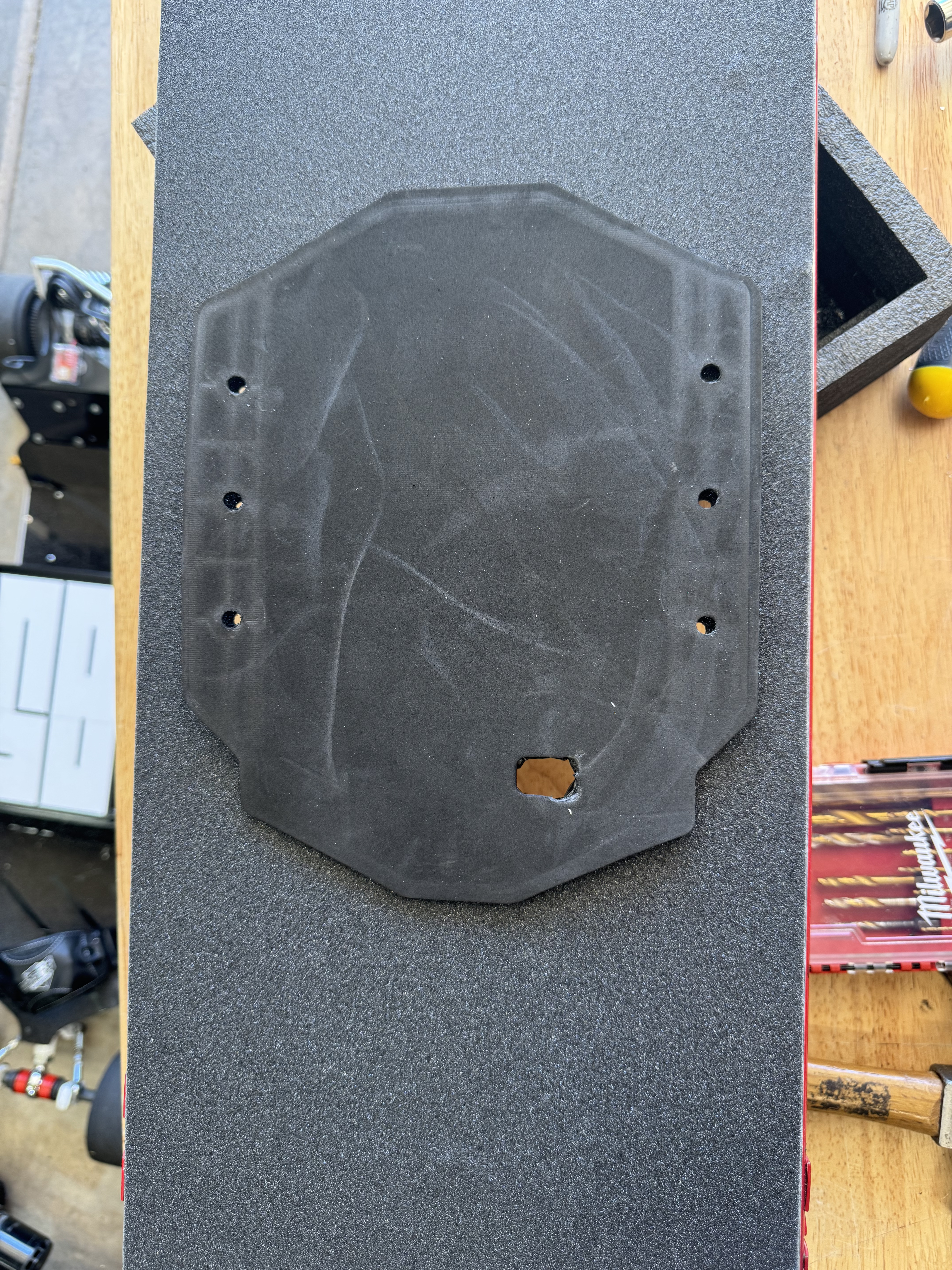

Drilling the deck for the battery
I lined up the battery enclosure gasket to where I wanted it, drilled through for the six mounting bolts and then drilled a bunch of holes to start the opening for the battery cable. Then I filed it cleaner and used tape to create a basic gasket.

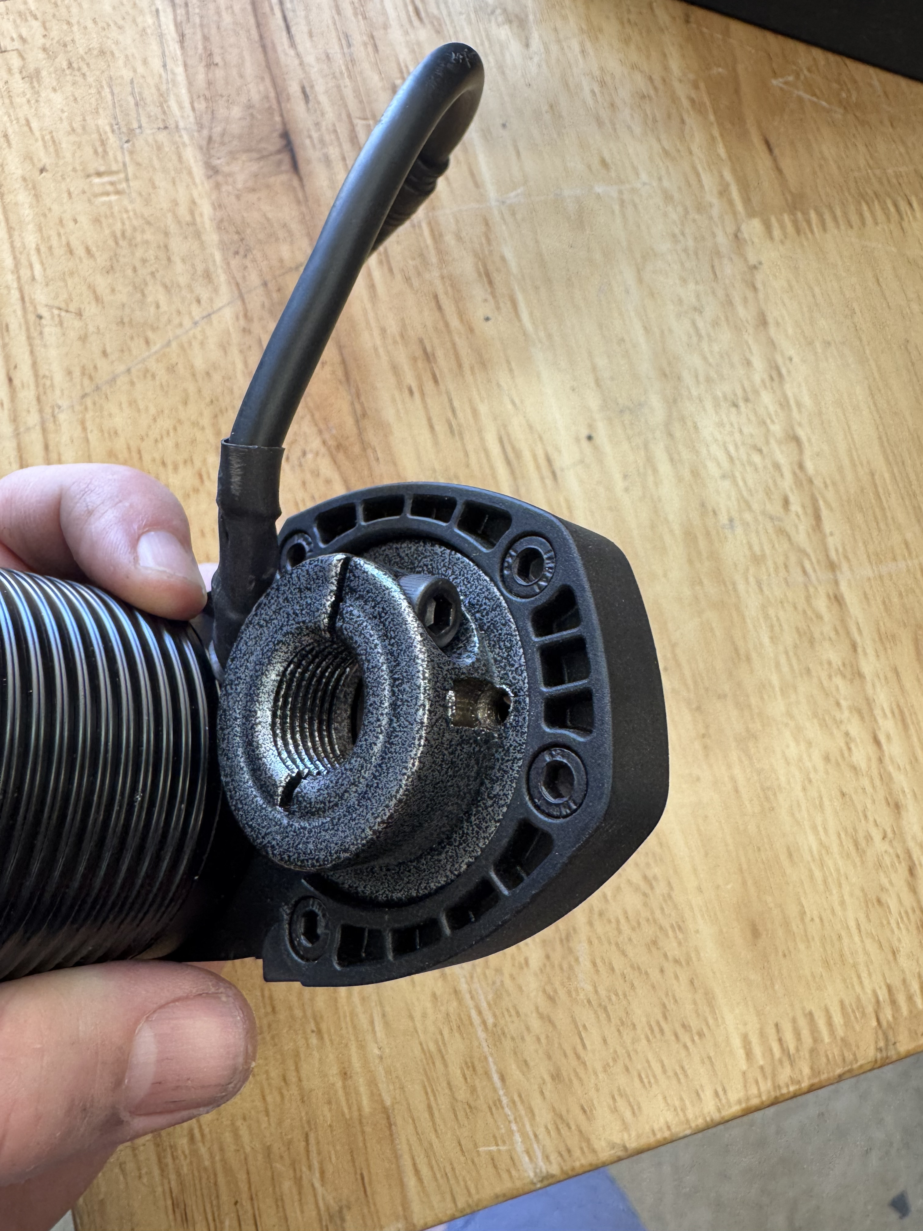

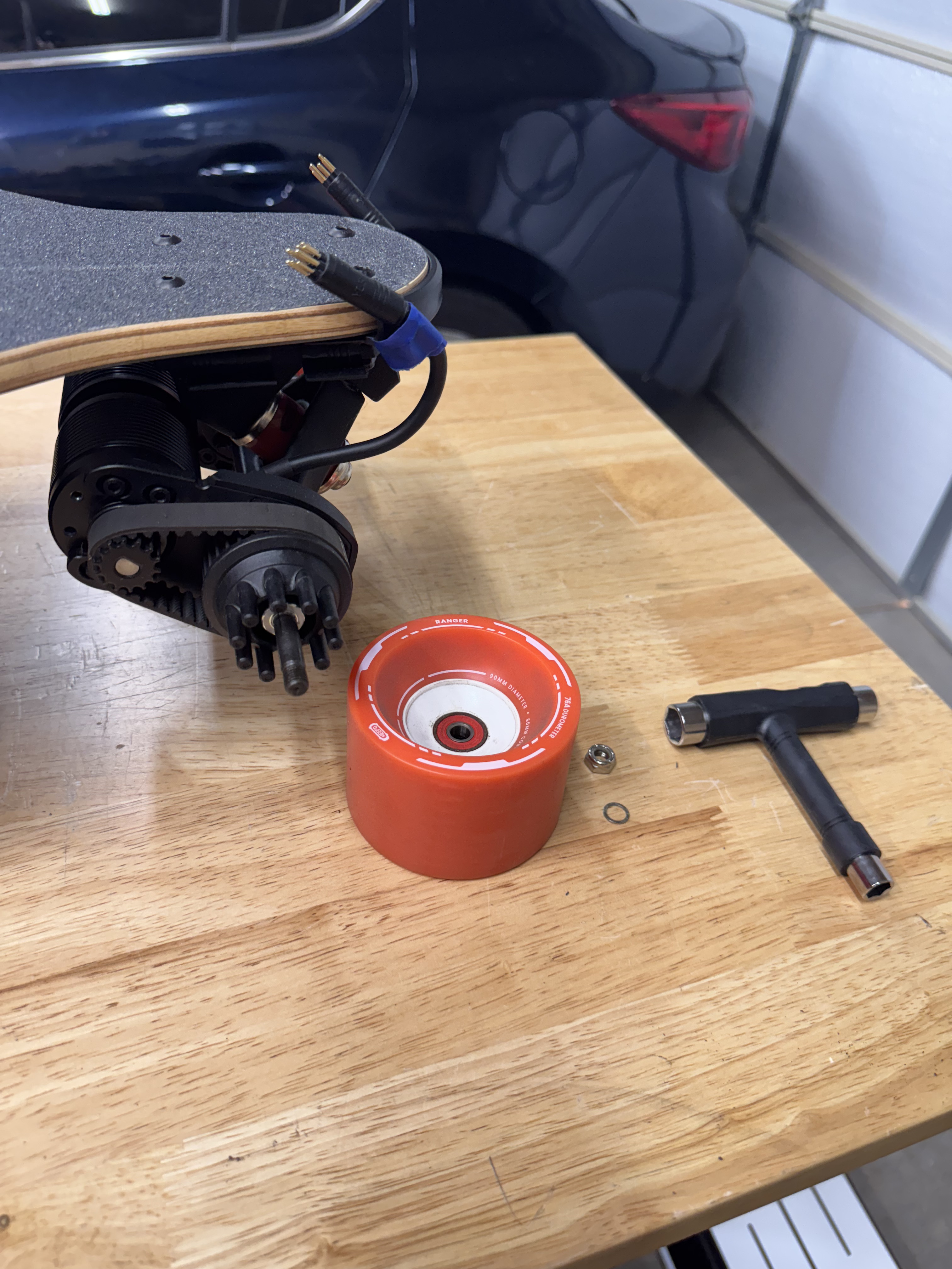

Motor mounts and install
@MoeStooge made this slick little adapters that slip into the meepo go motor mounts while threading onto the 3link axle. They fit perfect and worked great.

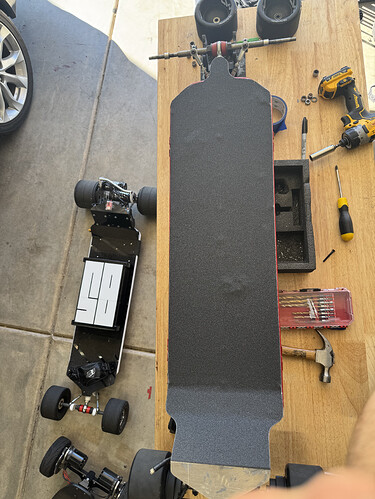

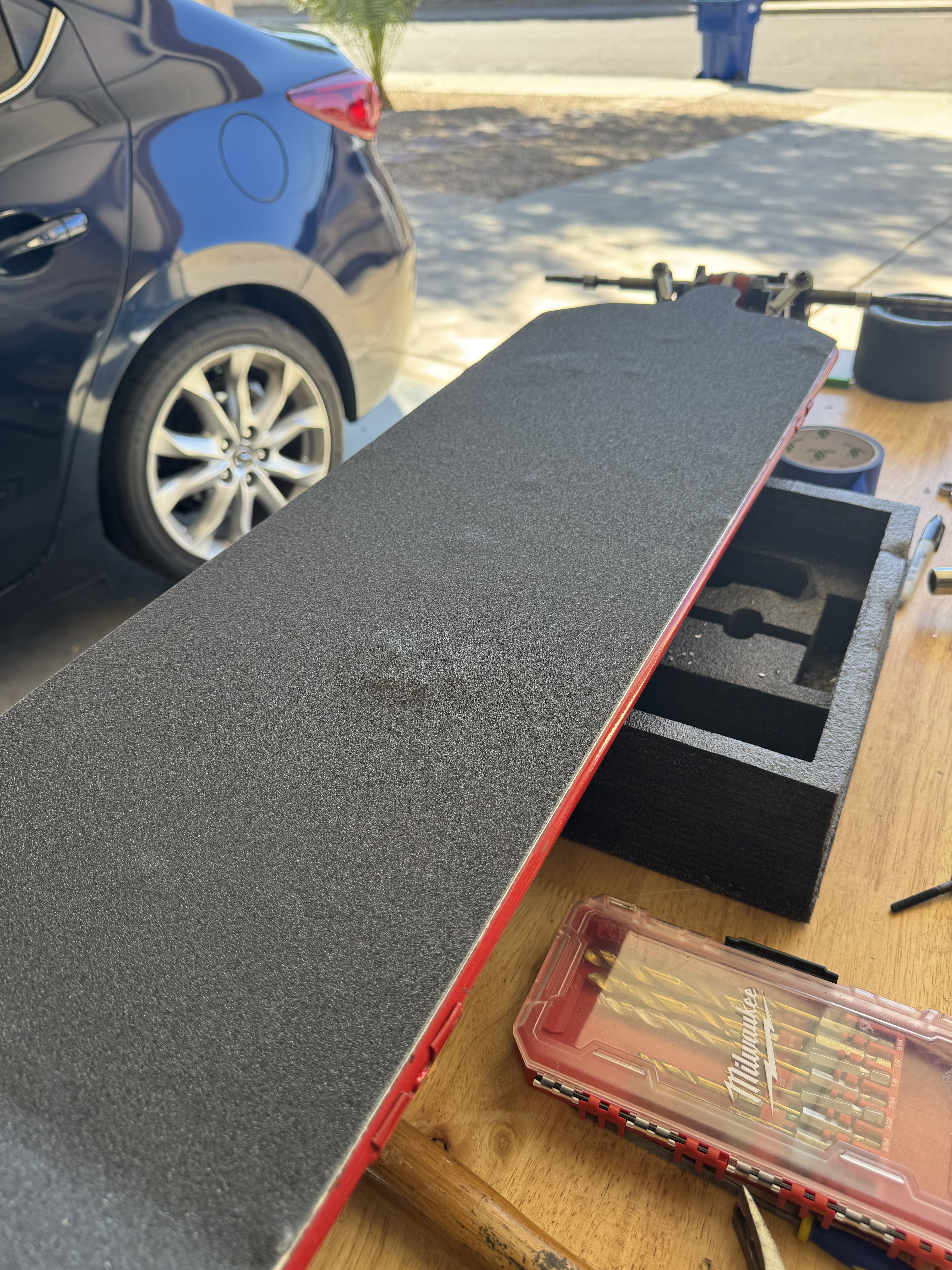

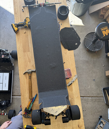

Grip it
Mounting the battery

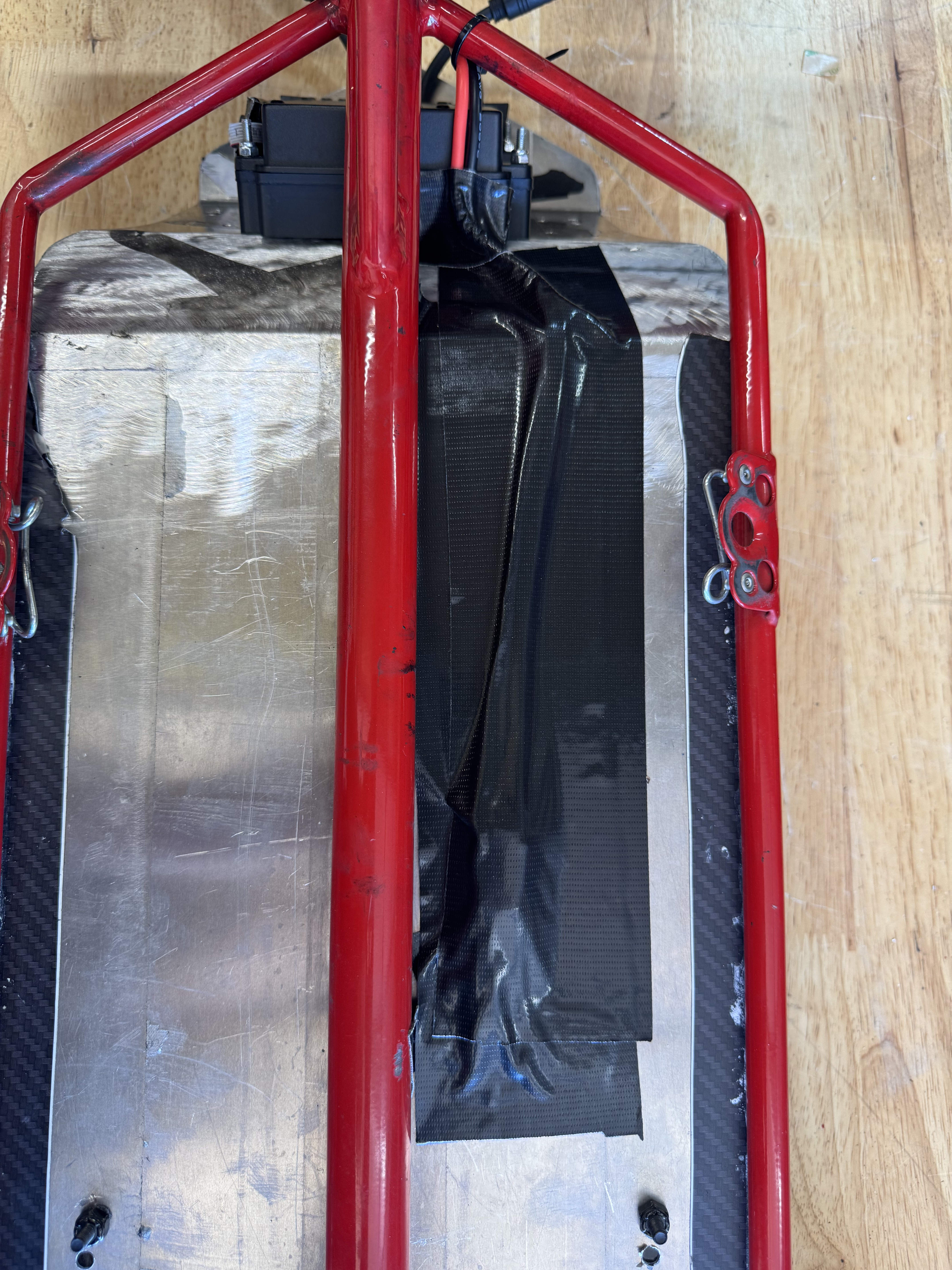

Underside cable management
Speed tape works for me :slight_smile: Remember shes a track princess. Ill take a look once in a while but its only holding a two battery set of 12g extension wires.

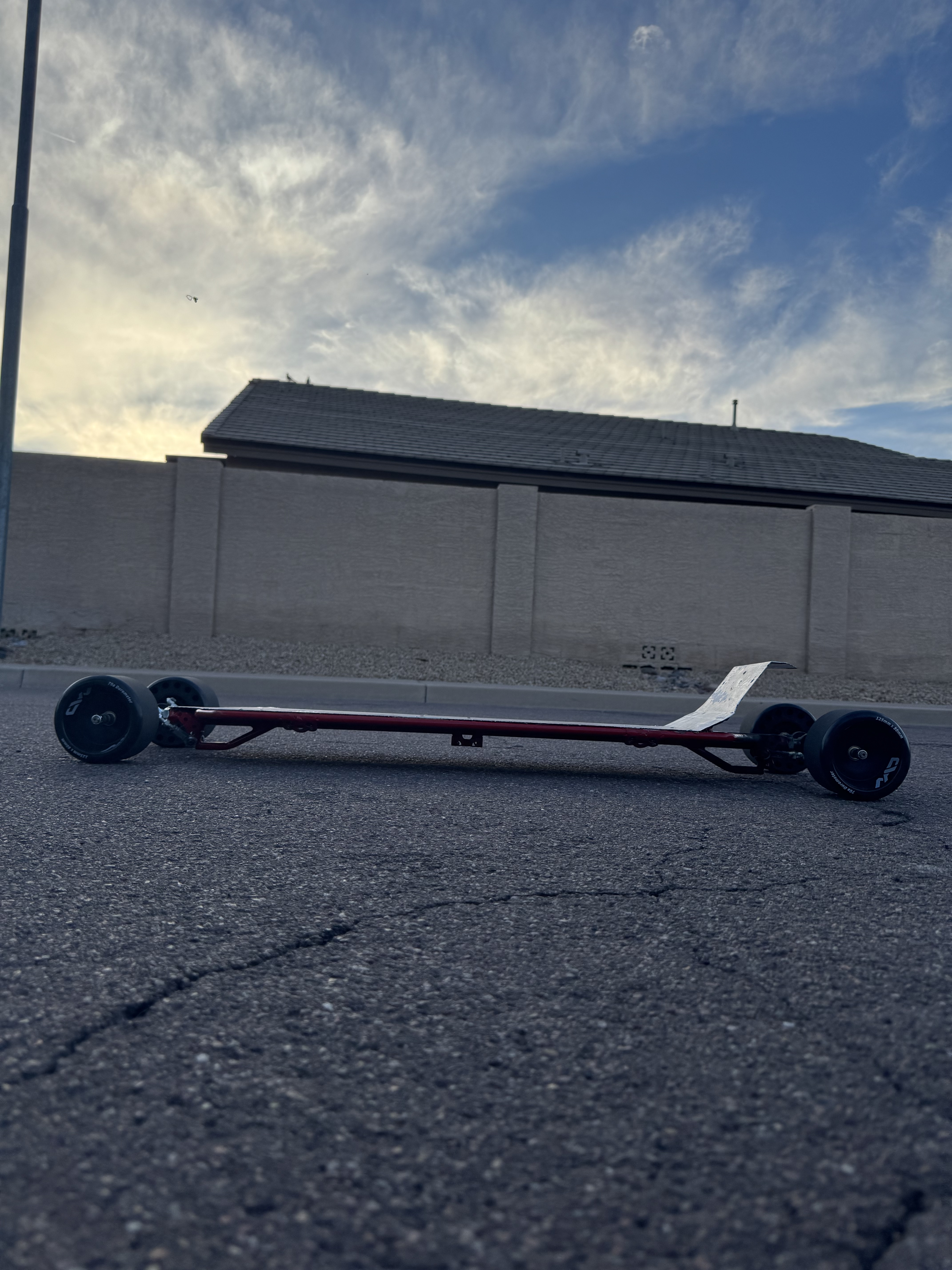

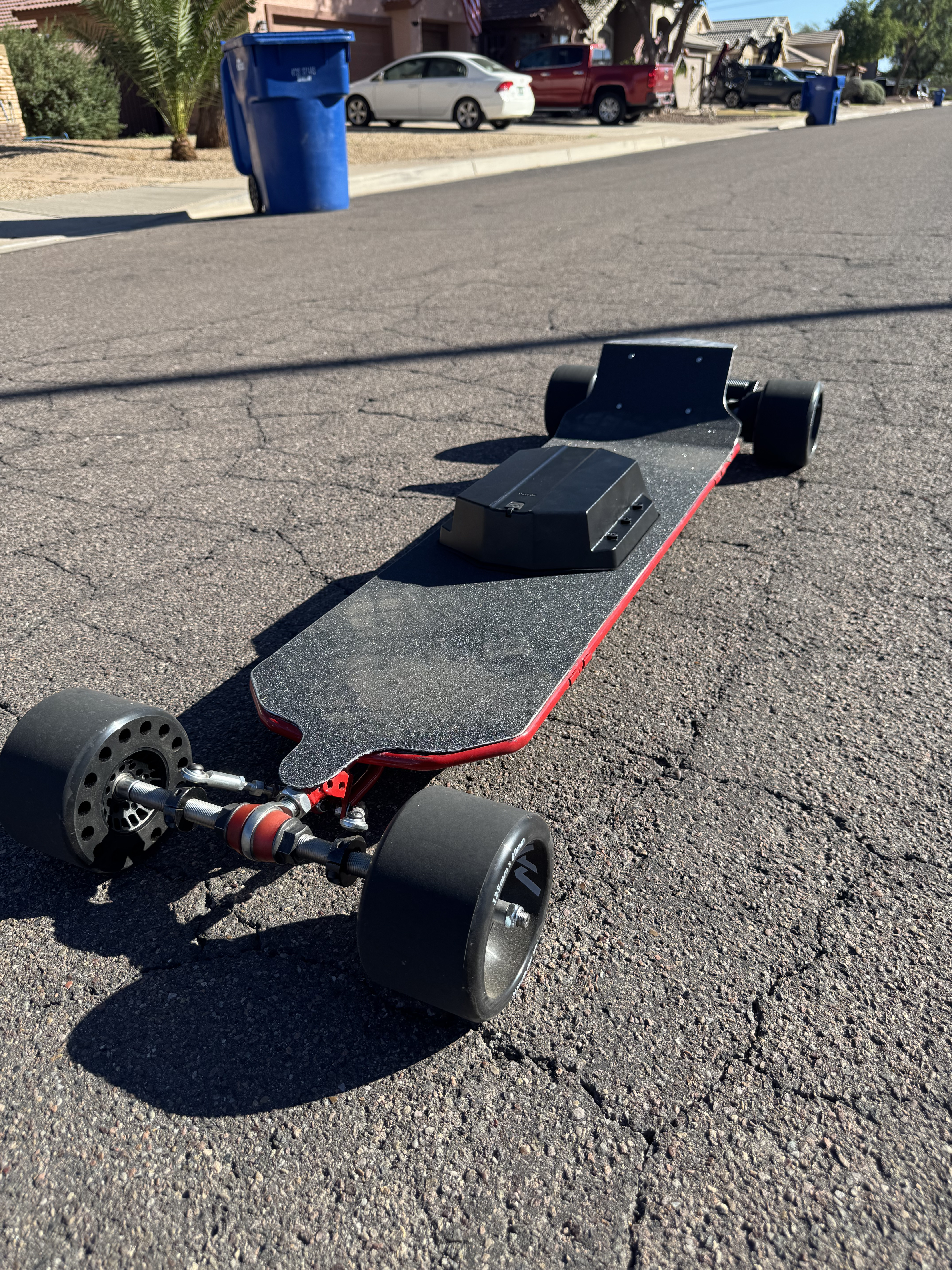

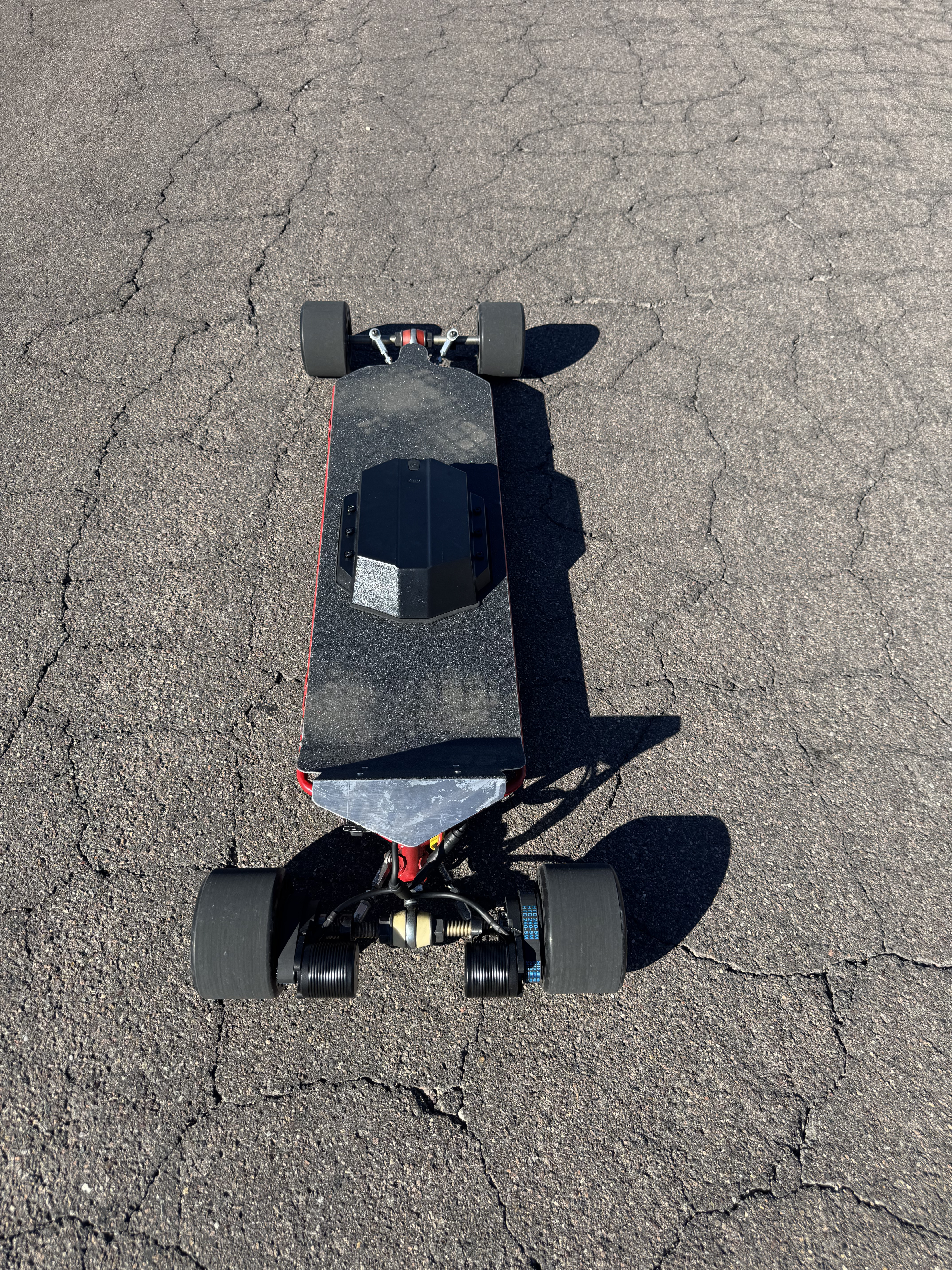

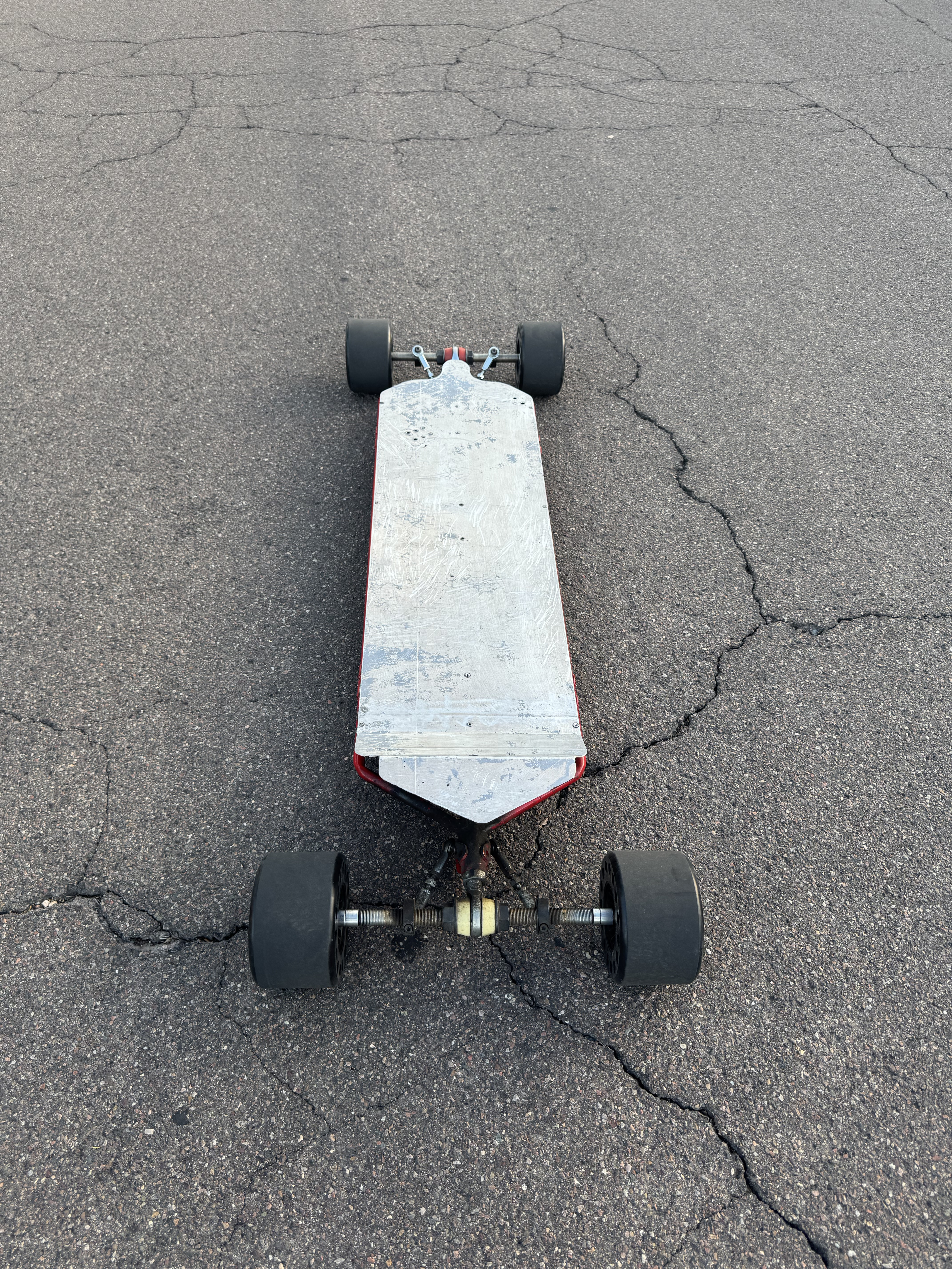

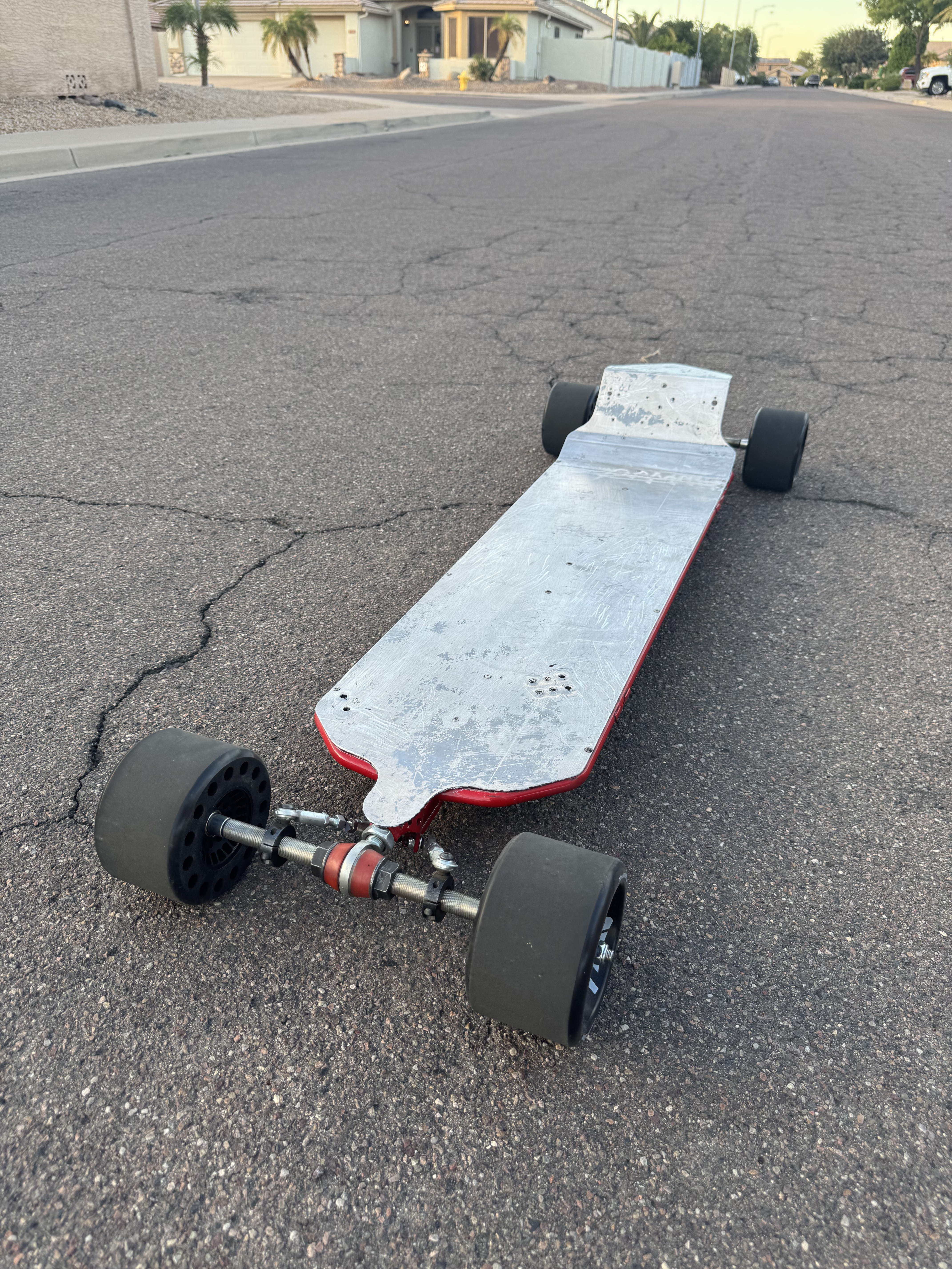

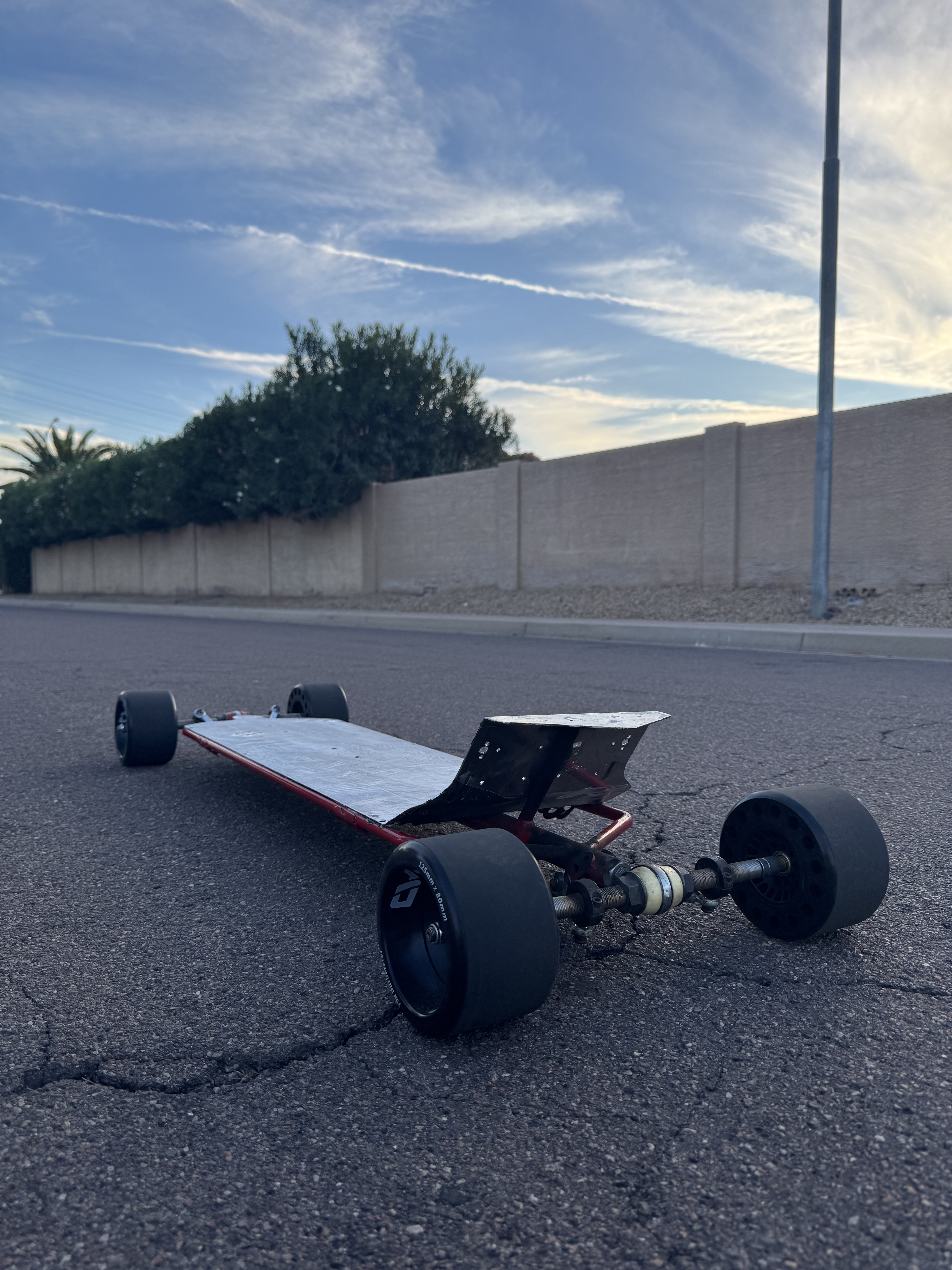

She’s built! THE PHOTOS YOU’RE LOOKING FOR
First ride impressions
The board rides really fun, it’s wildly low and in a carve you can drag toes or heels off the deck.
28mph feels pretty quick when you’re deck height is 3 1/4” off the ground and you’re on thanes.
But…. grip, where is the grip? I know MAD are one of the best on urethane grip but it doesn’t take much to overpower them to break traction still. Grip is always one of the biggest limiters in racing though, dancing on that edge.
SPEC class on urethane though is still iffy to me if the goal is to get more beginners involved. If everything else was kept identical but a higher grip wheel was used I think it would feel that much safer to a beginner. SPEC urethane almost feels like an advanced class. Im still very excited for the class to emerge and can’t wait to host a race here in AZ.
