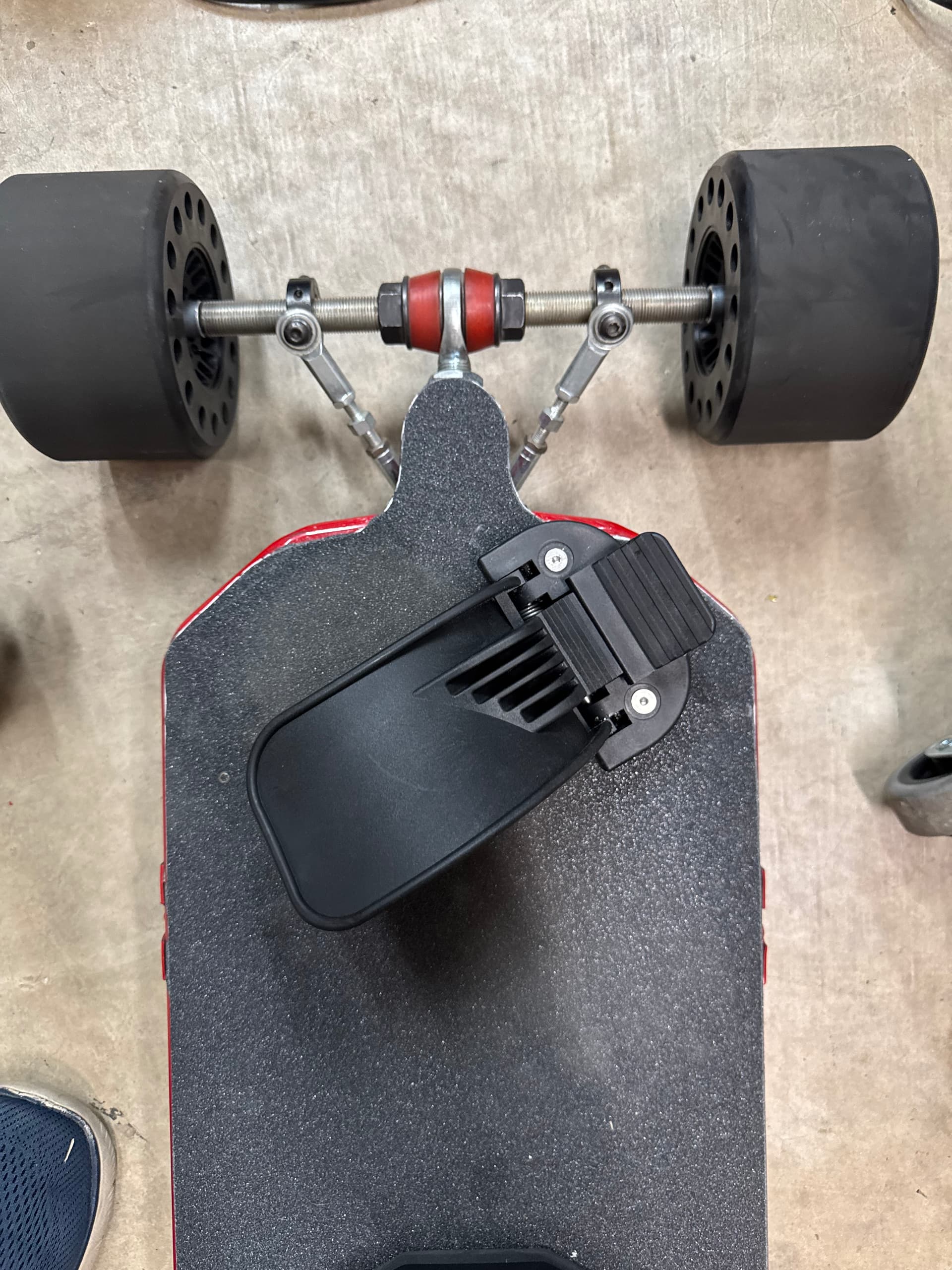

Well had my first track day at intro on the build. It’ll need a little tuning to get things feeling right with the geometry but overall it performed well.
I had installed a @tomiboi toe hook but it’s overkill on spec power/grip. A foot stop will be needed though on the V5 since it’s completely flat. We pulled it after a bit so everyone could ride
It was super fun, just those wheels…. Being kind of on edge so easily just wasn’t that enjoyable to me, took one kinda slip that tweaked me a bit. So for now I’ll put in some more time and see where things end up but I’m kinda 50/50 on racing it. It’ll be available as a house board for intro2speed AZ spec though for sure.

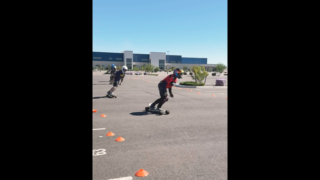

Our first Spec race (ish) at Intro2Speed AZ also went down
We had 2 HAWKS, this V5 and another rider on a low to mid power (forgot brand) street wheel setup that did a close to spec race.
I lent the V5 to another rider since I wasn’t feeling great from earlier, Vince that’s primarily a EUC racer but is also someone that now owns a HAWK and a Monsoon as he starts getting into esk8 racing. He enjoyed the longer wheel base and the build In this race he said.
