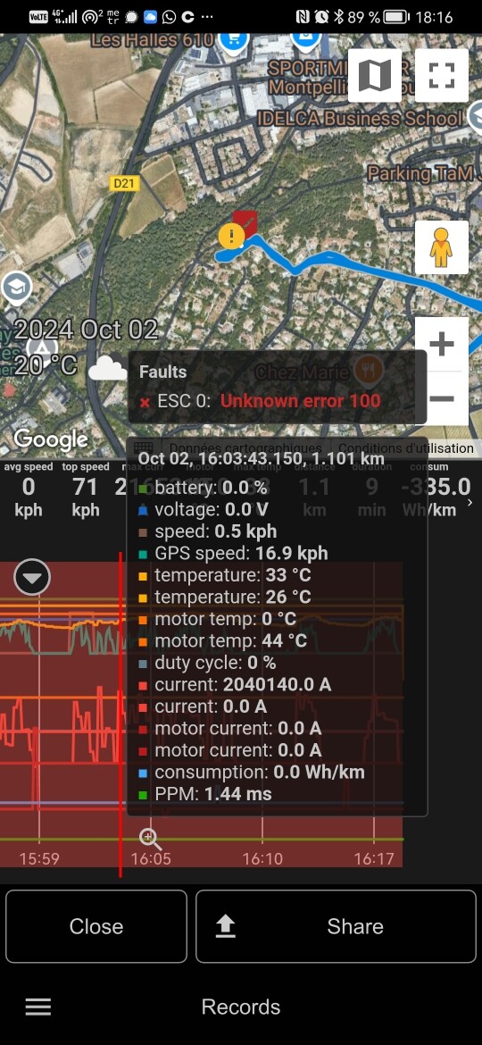

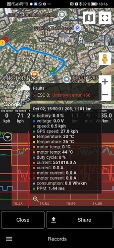

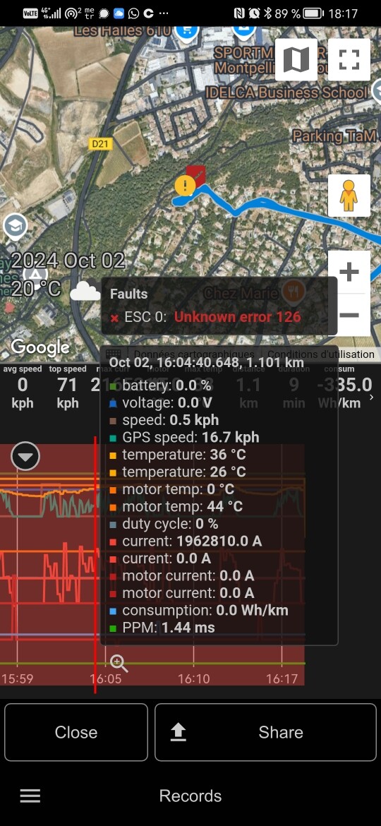

I’ve recently had a weird issue with two different builds that have FESC 6.6 dual.
I do not feel any problem while riding.
But at the end of the ride, METR app reports many “Unknown error” associated with various numbers and incredibly high currents.
Unfortunately, I have automatic updates on my phone and I wonder if it’s not related to a new version of METR.

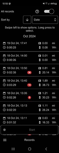

This is wild…ive ran into this exact thing just the other day
All of these are the same error
@rpasichnyk any ideas?
Fw 6.05 Solo ESC and the latest Metr FW
application version: 4.28.8

i have the same error , firmware 6.05 and latest metr.

Thanks for heads up, this is a bug in the app due to lack of testing, main development effort is now for Voyage Systems Megan and Minnie, so I didn’t notice in time. I am working on this with high priority and will try to do better with testing (include Metr Pro), to make sure stuff does not break.
This is the kind of response we should get from all suppliers when there is an issue. Sadly that’s not the case.
Hats off to you @rpasichnyk :+1:
App update with the fix is out now.
