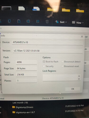

I updated the firmware.
The previous firmware that came with it was this
Now it’s v0.14
I’ll give that test see if there’s any other freezing

Just a clarification. The current FW version actually cannot be read using the BOSSA tool. I believe the “version” that the tool was displaying was the manufacturing info of the SAMD21 micro. THe closest the BOSSA can do to checking the FW version is “verify” which compares the FW on the device to the FW select in the file browser.
Hopefully the v0.14 FW does improve your experience, but if not, I will have the same setup as you soon and should be able to weed out the bug you are coming across.

Seems the firmware update fixed mine and as Hoddz mentioned everything plugged in rx/tx must be connected the same configuration this has fixed my random freezing and it now boots perfectly with the charger plugged in.
