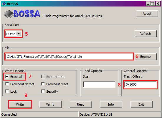

Did you have the USB cable plugged in before powering on? In that case it would not light up before the update. If the FW updater tool was able to flash the uSplit before, then that means at least the bootloader was ok at the time. I am suspecting that if you attempted to update it again, you would not be able to get it to work because the bootloader is corrupted. That can happen if the offset (shown below as number 8) entered in the updater tool is lower than “0x2000”. I have seen that once before when a typo was made and 0x200 was entered instead of 0x2000.
Can you try the reprogramming process once more to see what happens?
Yes I did
Yeah it went through the whole process successfully
You think?
I am certain I had it set to 0x2000
As for the image, I used the zip file, it didn’t say to unzip so I just used that.
I shall unzip and try reprogramming
Oooh! That’s it right there. I will add a bit to the instructions to clarify that. You should be good after unzipping and reprogramming.
Alright we shall see, it’s trying to connect to the usplit right now
Seems to just crash now when trying to connect, I shall try a different computer
Try having the uSplit connected to the computer before opening BOSSA. If you are not able to get it to connect, then you can send the uSplit back to me and I’ll exchange it for a new one.
It is possible that when the .zip file was used, it did something weird and corrupted the bootloader anyways.
Yeah had to have it connected to the PC before power
It updated successfully and seems to be working! Excellent! I will report back if there are any issues
