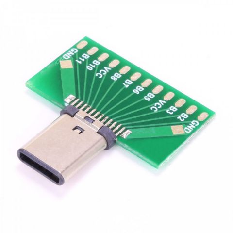

An interesting option maybe would be using the USB-C physical standard but Frankenstein charging setup. This is a bad idea but using some form of a break-out board, then just splitting the normal charging +/- to matching pins. (Not sure if the PCB traces could even handle the power levels it should be able to?)
It would technically be swapping out the two charging points, like swapping from barrel to XT60 or whatever. By no means would you want to plug this in to a normal device(instant death I am sure) but it would look clean and be simple to plug in.
